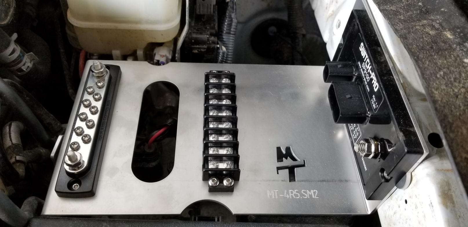

I literally almost ordered the 9100 with a power tray. Now I'm starting to rethink this horizontal mounting thing. Does anyone have any pics of it being vertically mounted?
This is what I've got installed, but not fully, in my 2014 Trail.

Sorry that happened, good example why Switch-Pros is requiring the vertical mounting of the power module now.
