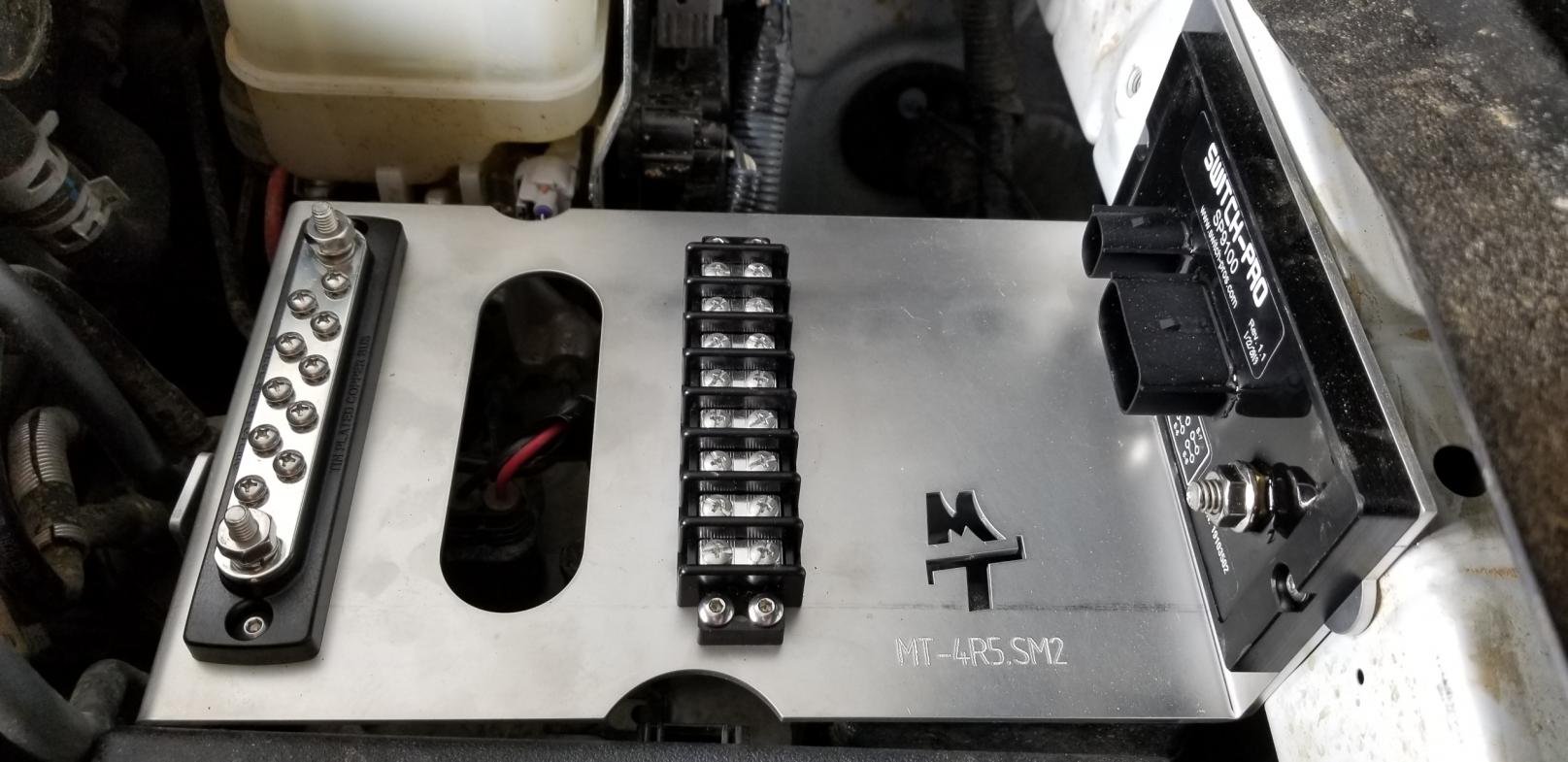

Just received my Power Tray and my Switch Pros. Should I be concerned that the first instructions for the Switch Pros says to ONLY mount it vertically or it may void the warranty. Then it says using a terminal block IS NOT RECOMMENDED due to water?

I would say yes to be concerned. There are others reporting issues on the horizontal mounting things too. This is what I am in the process of installing.

Link: Switch Pro 9100 Vertical Mounting Solution
Just wondering if you guys got the Switch-Pros power module installed and what you did. Did you see this thread where it was discussed and introduced a vertical mounting solution for it ? Its become available. (To be transparent it's my thread, but while researching this stuff, I came across this thread and wanted people to know that there are options).
I think that Switch-Pros not recommending the terminal block because water can sit there too, but what are you going to do ? Replace a several hundred dollar power module or a $15 terminal block ? I do not think its a warranty issue on it either.
