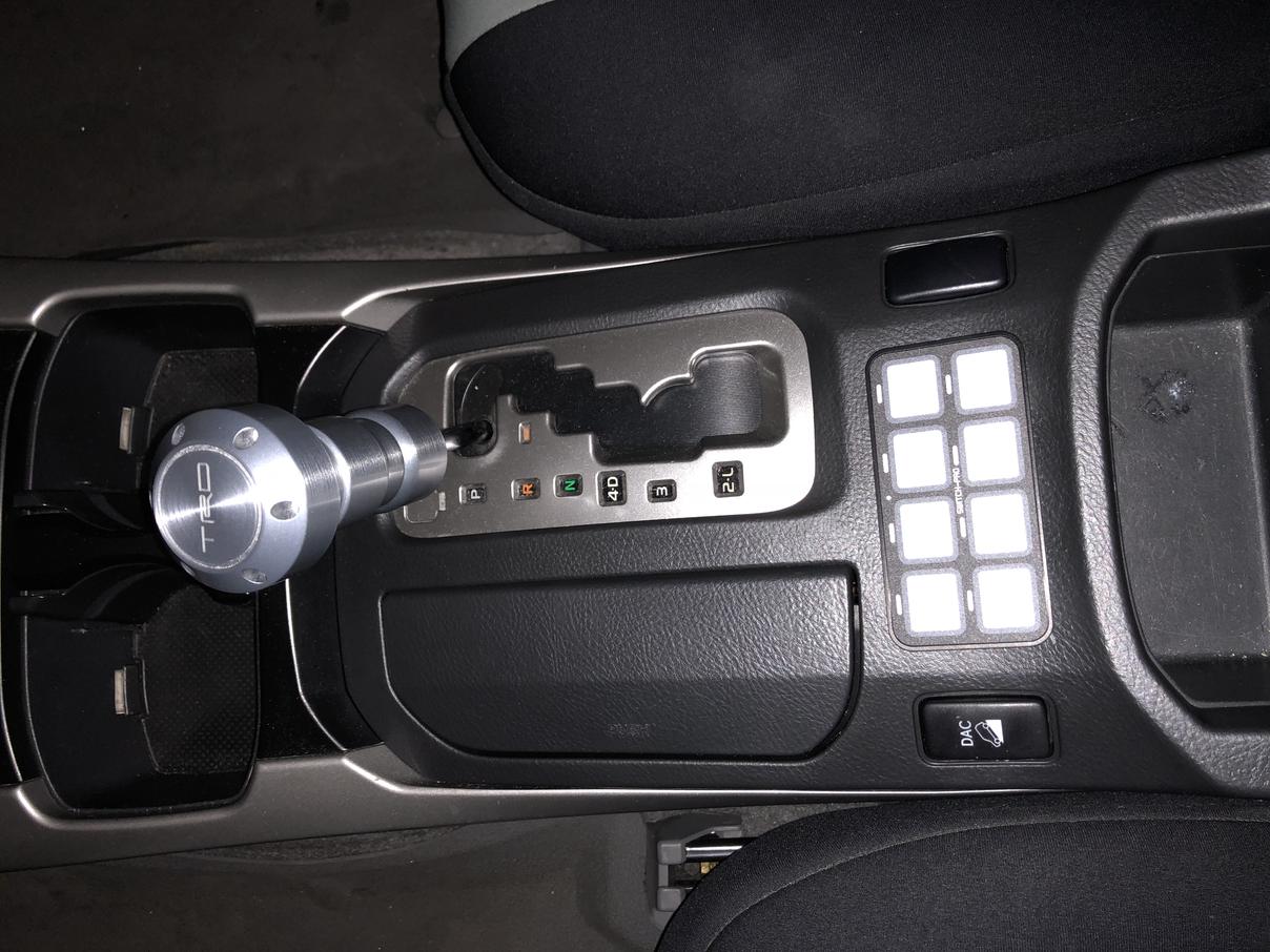

Only picture I have but I basically drilled holes and mounted it next to my dac switch.

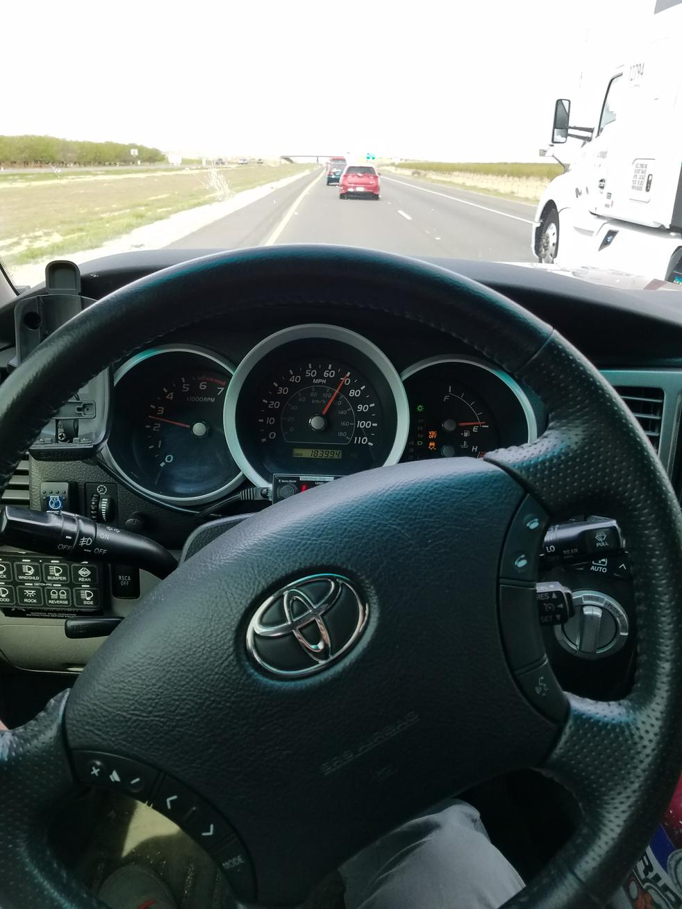

I extended the center diff lock wiring to the center console and then used the hardware to mount it utilizing the holes from the other 3 switches. Worked perfectly and looks clean. And yes, I took a pic while driving which was stupid but that alignment was JACKED after offroading!

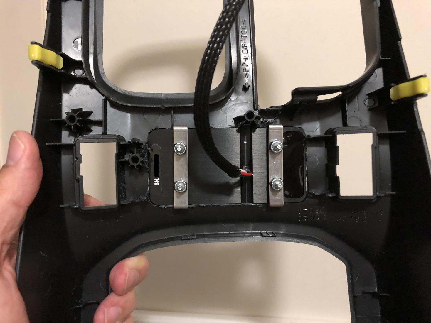

I bought a limited "Panel cover rear cover" for the center console and mounted it there.

I mounted one similarly in my center console, but used switch blanks to hold it in place. Not 100% locked in place for whatever reason, but still sturdy. I later ordered the limited center console trim piece to get another 2 switches.
