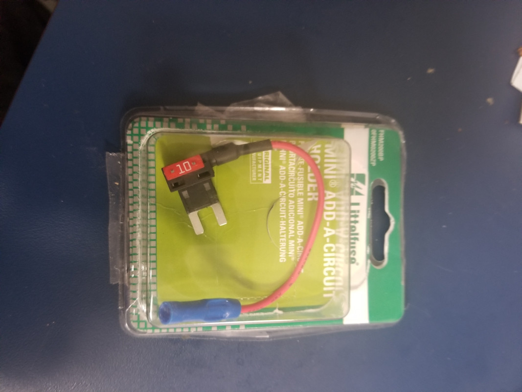

Use one of these,
Most people are using the tap that Soneill mentioned.
They also then remove the cover which isn't a big deal.
I have mine removed and just keep the cover in my center console if I need to reference it.
