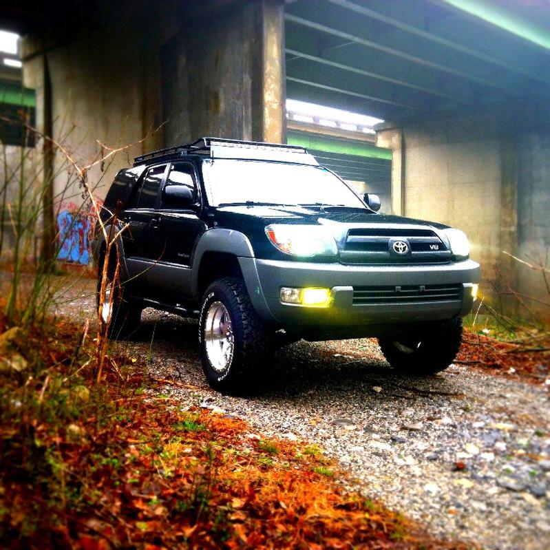

Only had my phone with me. Would have looked much better with my real camera. Maybe the fog will be around tomorrow
