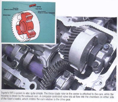

Another thing to keep in mind is the VVT-i engine uses the engine oil (pressure) to activate the mechanical mechanism that varies the valve timing. I would think that any kind of sludge/contamination would be a real problem.
