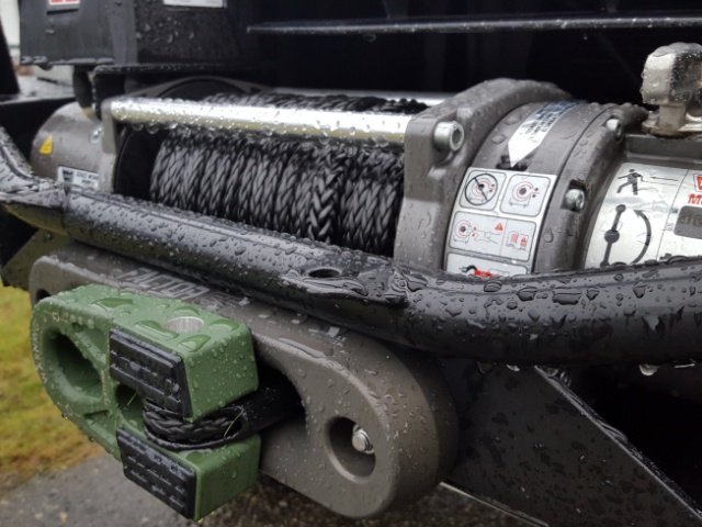

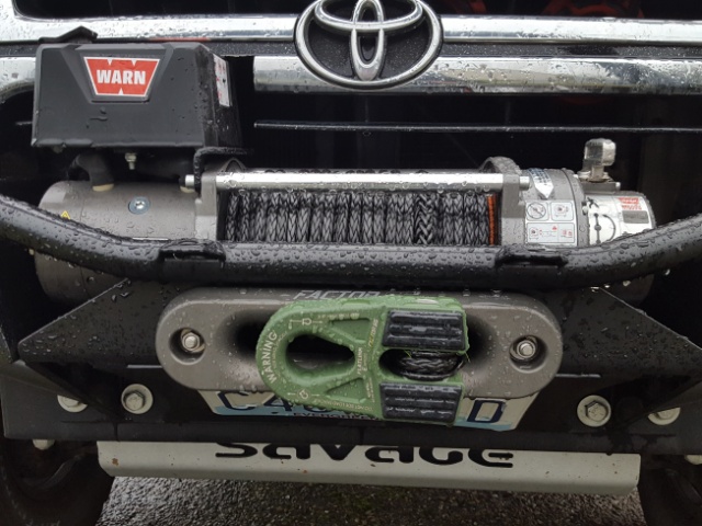

I replaced my wire cable on my M8000 with Masterpull Superline Synthetic Winch Line. I went with a 100 feet of 5/16th. The Masterpull "Superline" is a solid step up from their "Classic" line and is rated to 21,700 lbs.
If I were to buy again, I would still go with their superline. But, I would 3/8" and a shorter amount. I would get either 50 feet or maybe 75 feet. This gives you plenty of room to work with without crowding the spool as you are spooling in. Max capacity can be a tight fit, even when guiding it on. But it can be hard to manage the spool and clearance when you are busy doing other things. Then, I would just get an extension or two to allow for more reach. And as far as jumping up to 3/8", it's not that you really need that much more strength for most situations, but, 3/8" size line seems to be easier to find repair tools like the Factor 55 Fast Fid splicing tool. >> https://factor55.com/product/fast-fid-new/
With that set up, you could just grab whatever appropriate winch line extension and then you wouldn't have to spool out as much as if you had it all on the spool. Anyway.. That's what I would consider if I were to do it again.
Pics for reference.
Master Pull Superline. 100 feet of 5/16".
