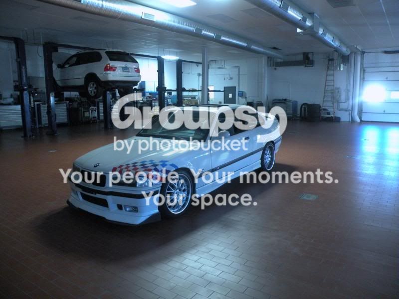

Thanks everyone, guess I'll check on the water pump. I also haven't received the service records yet, but I pick those up tomorrow so I will learn more then. I only have one pic of my E36 vert here at work, but they are my favorites and I am good with replacing the nightmare top straps, plastic windows, and other issues....heres an older pic of mine (at work no more pics), still have it w/ about 50k on it...

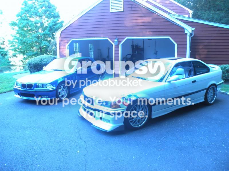

lightweight?
Wait, no... has a sunroof... E36 is my fav body style... my buddy has an E90 he went and did the customer pickup in Germany
