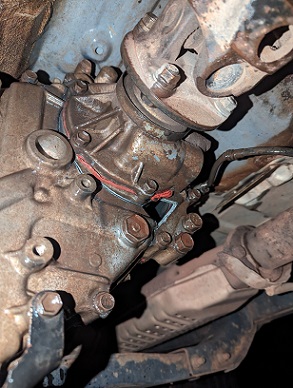

99' SR5 Manual T-case same as Auto? No MM. J-shift pattern
I've had a bad drive shaft vibration for a while and was saving $$ to get work done on the t-case. I waited too long and the t-case went buh-bye! Had some play in the output shaft of the T-case to the rear drive shaft. Maybe easier to swap out the T-case than get rebuilt anyways?
Looking to get a used one. Is there a difference between a auto and a manual SR5 T-case? I know there is a difference between the Limited and SR5, multi-mode vs not.
I've got a J-shift with no multimode and the rear-lock push button on the dash. It's a manual transmission.
Part #36110-35271 is what I'm looking to purchase? I think?
Read through the thread and as long as it's a SR5 99-00 seems I should be gtg?

96-00 j shift transfer case will interchange. The automatic transfer cases have a sensor or two more than the manual transfer cases, but they’re simple to swap out. If you get one from a non abs 4Runner it will have a speed sensor in the transfer case as well.
