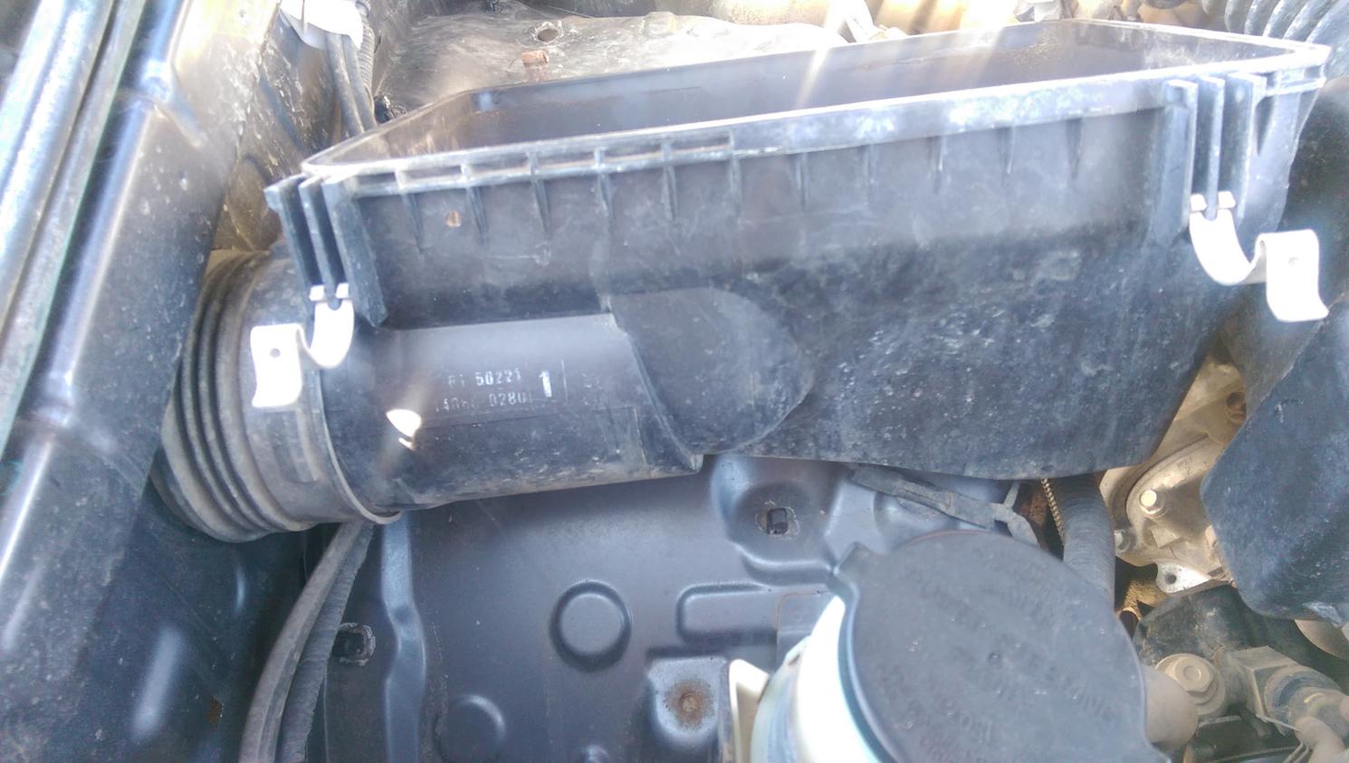

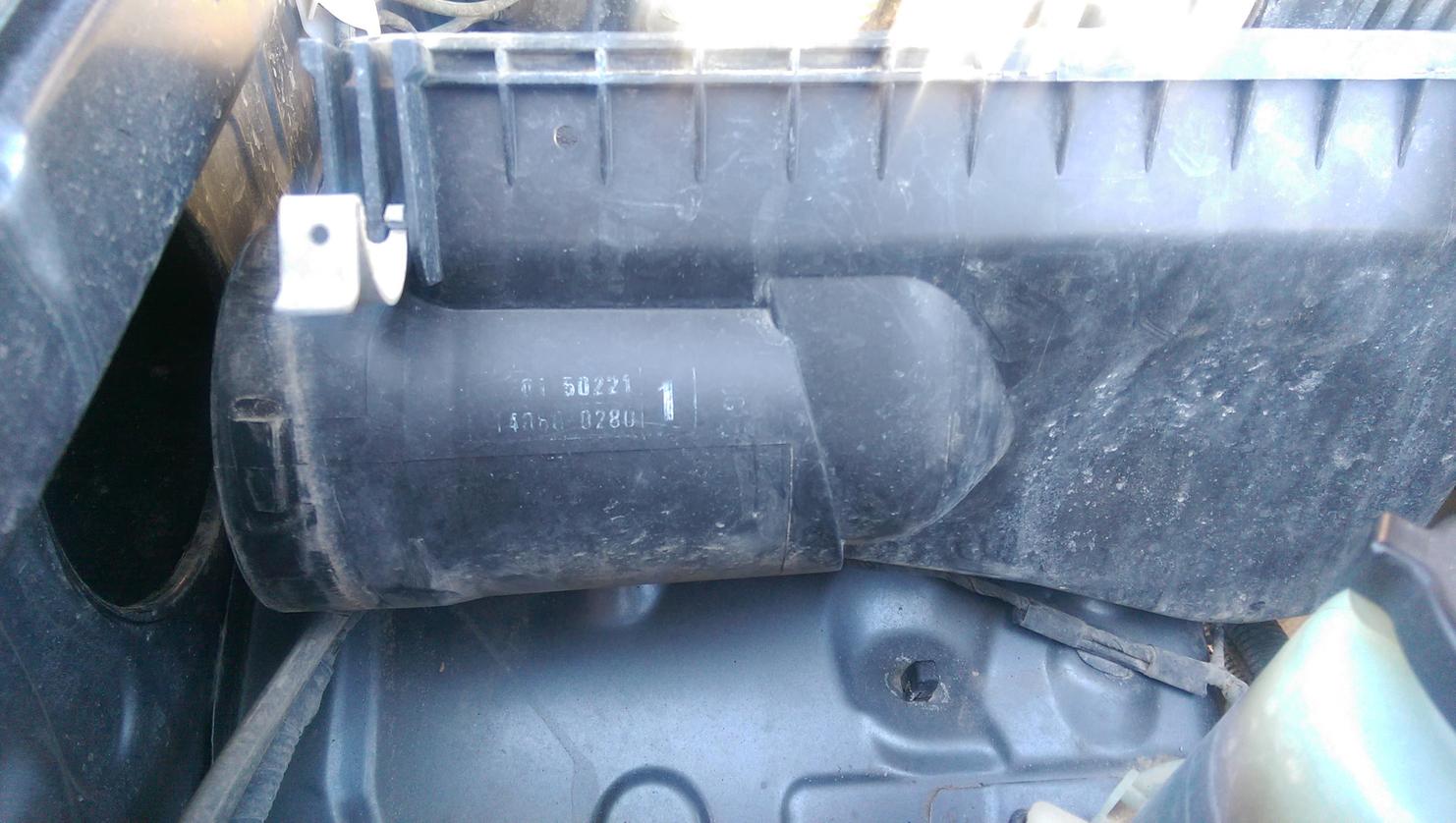

It's 52 degrees out today, sunshine, loving it! Been pretty restless so I decided to get some stuff done.Don't know if it's a good idea or not, but I took out the nozzle intake for the airbox so that it is not pulling directly from the fenderwell. I know I will get more heat from the engine bay, but I'm hoping it will help any potential water splattering in there for this offroading season.
Before:
After:

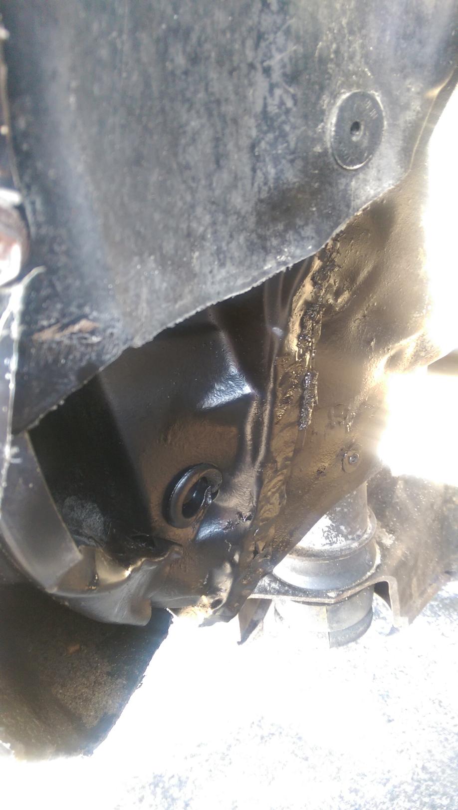

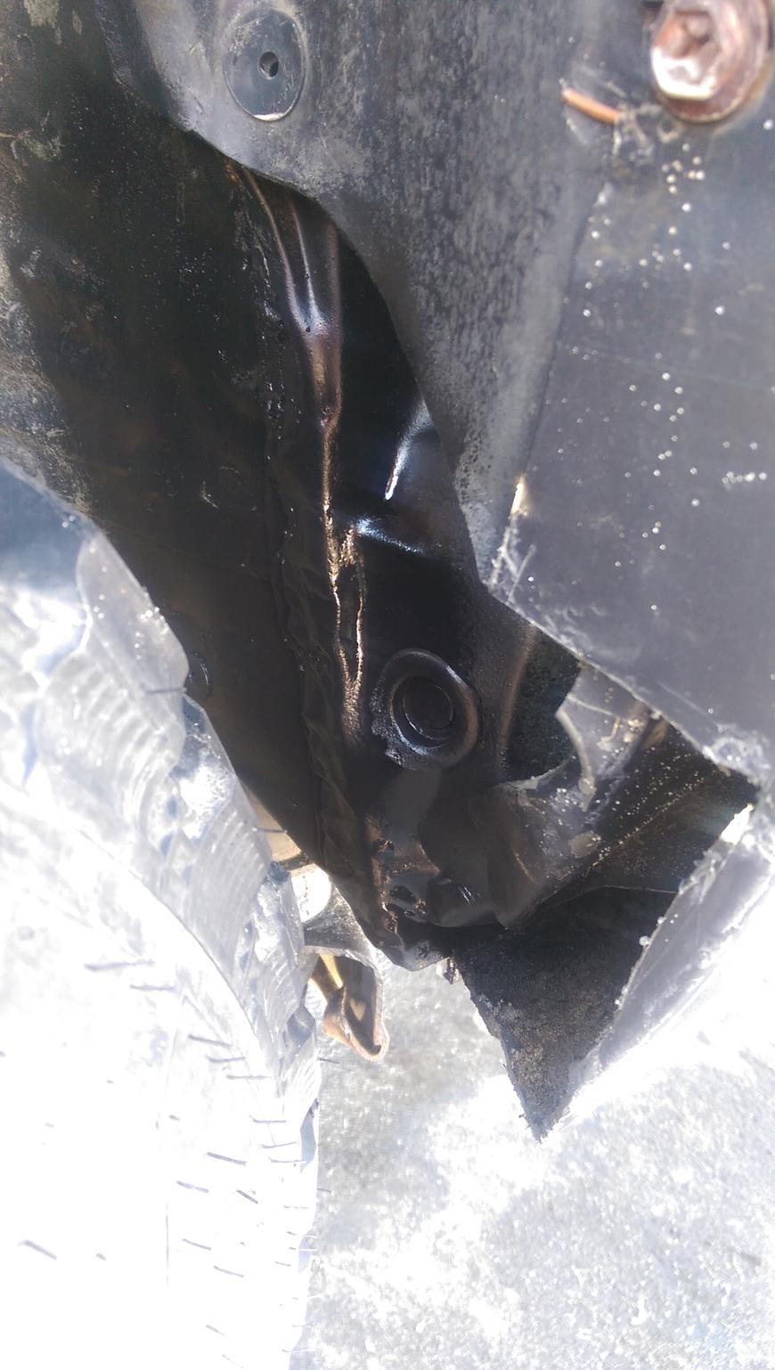

Then I finally pulled the front tires off and hammered my pinch welds flat. Heated them up a little with my torch then used my BFH to pound them flat. I hit the surrounding area after they were flat and pushed the whole sheet back about another 1/2 inch. I should have not more rubbing issues now! I didn't have any paint or rust converter around so I used the last of my can of Plastidip to cover everything. I know it's not ideal, it's just to get me by until it gets warmer and I can buy some good rust converter and bedliner to coat all of my fenderwell.

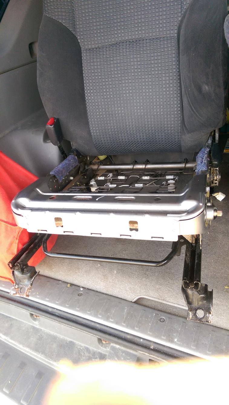

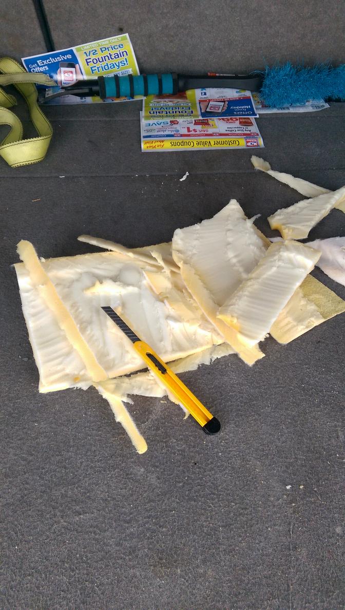

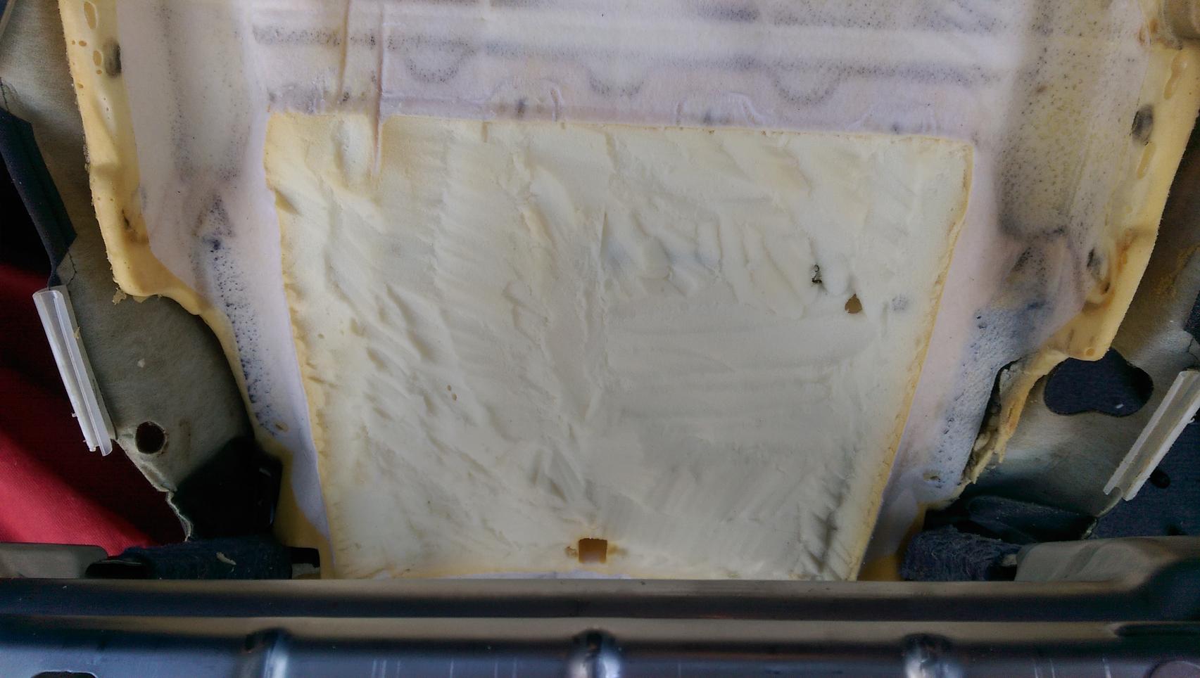

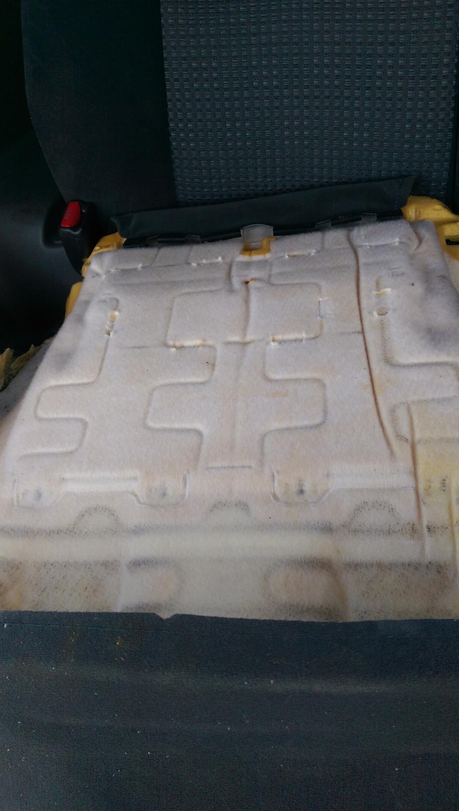

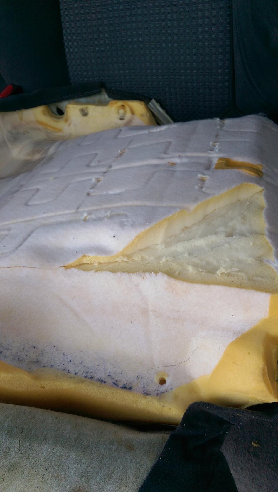

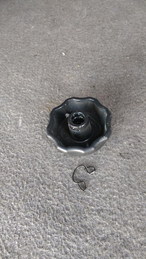

I'm tall...too tall! I got the idea from a forum over on the Toyota 120 about getting rid of the sunroof. One guy was talking about how he pulled the bottom seat cushion and trimmed the bottom of it so that he sits lower now. So today I went out and tackled that. Was pretty simple once I figured out how to get it apart. The seat cover has little tabs around the perimeter that hold it on. Take those off and then if you have the manual seat like mine there is a clip that holds on the turn nob. I then used a razor knife to cut the foam down. I can actually move the seat in an upright position now instead of having the gangsta lean! :fro:

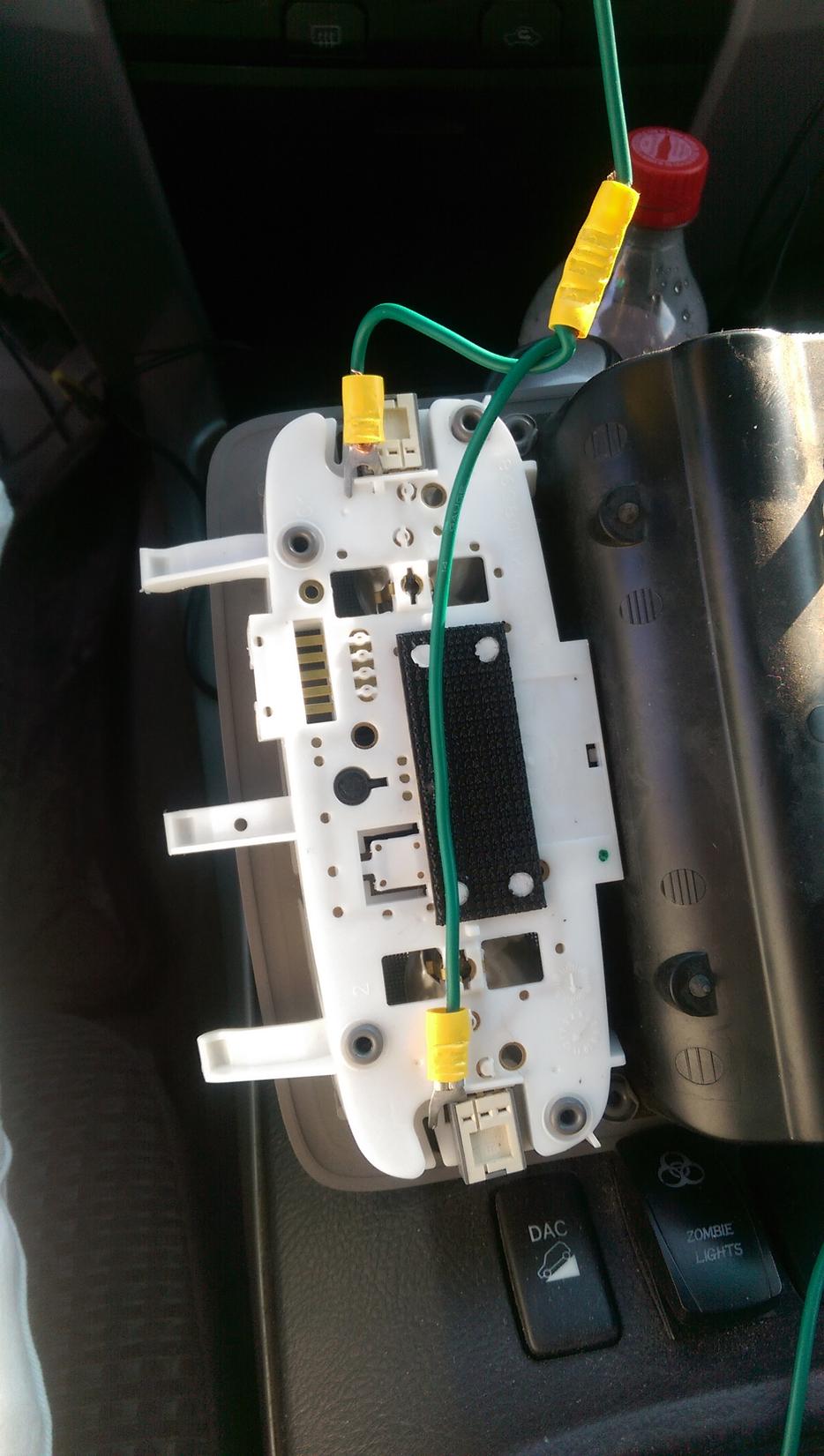

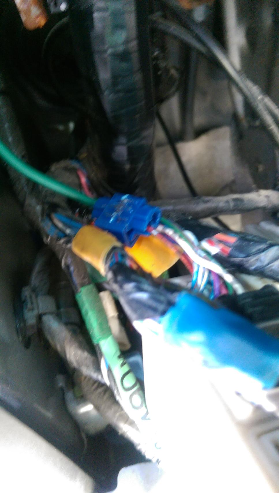

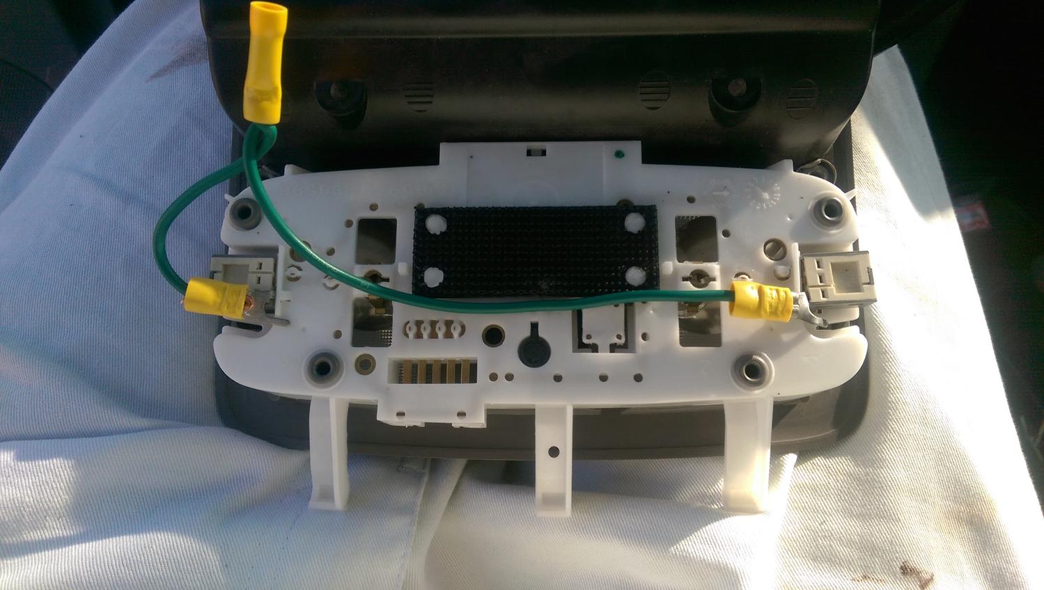

Map Light Mod
Completed the map light mod today. Was easier than I thought it was going to be.

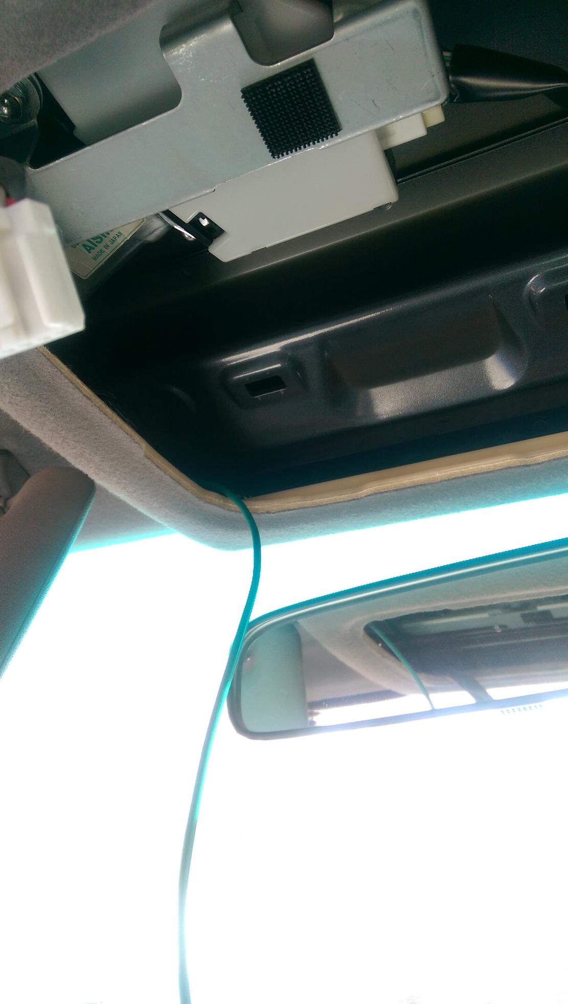

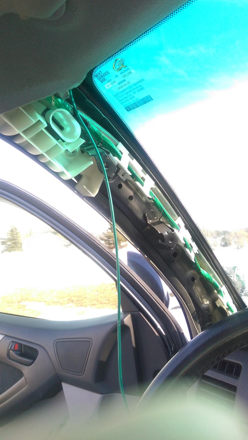

Ran it down the A-pillar
Scothlok style crimp to patch into the feed wire.
I left enough room that it can hang down in case I have to do some work up there. I was thinking of putting some connectors there so that it could be disconnected but I didn't have any.

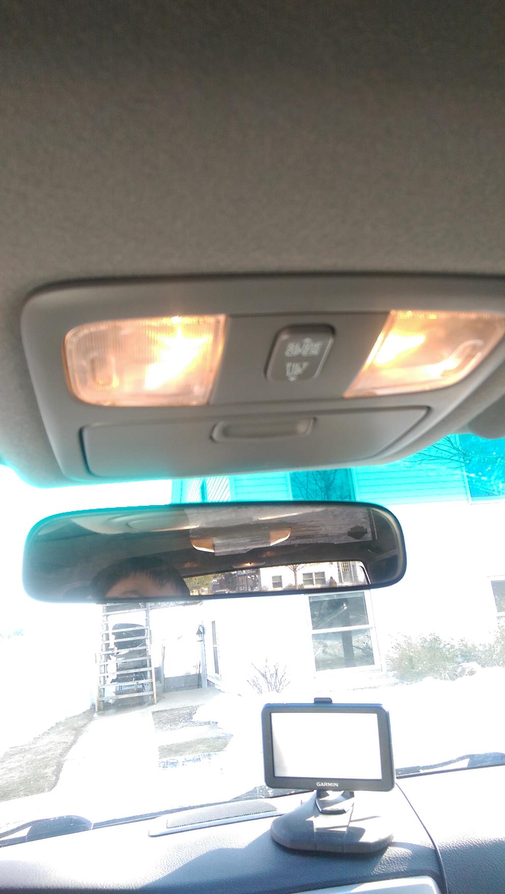

Viola!

Congratulations for the expecting parents.
And another thing, if you have a electric carving knife for Turkeys, they work great on cutting foam. Used them to make seat cushions from big blocks.
Thanks!
Good info! If I do something like this again I will have to find one!

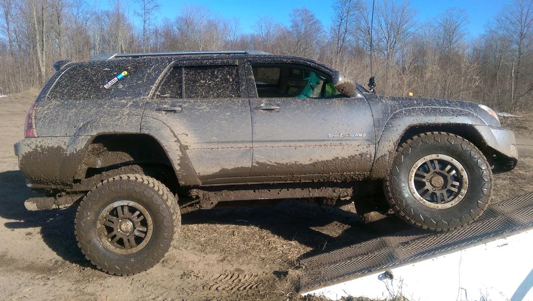

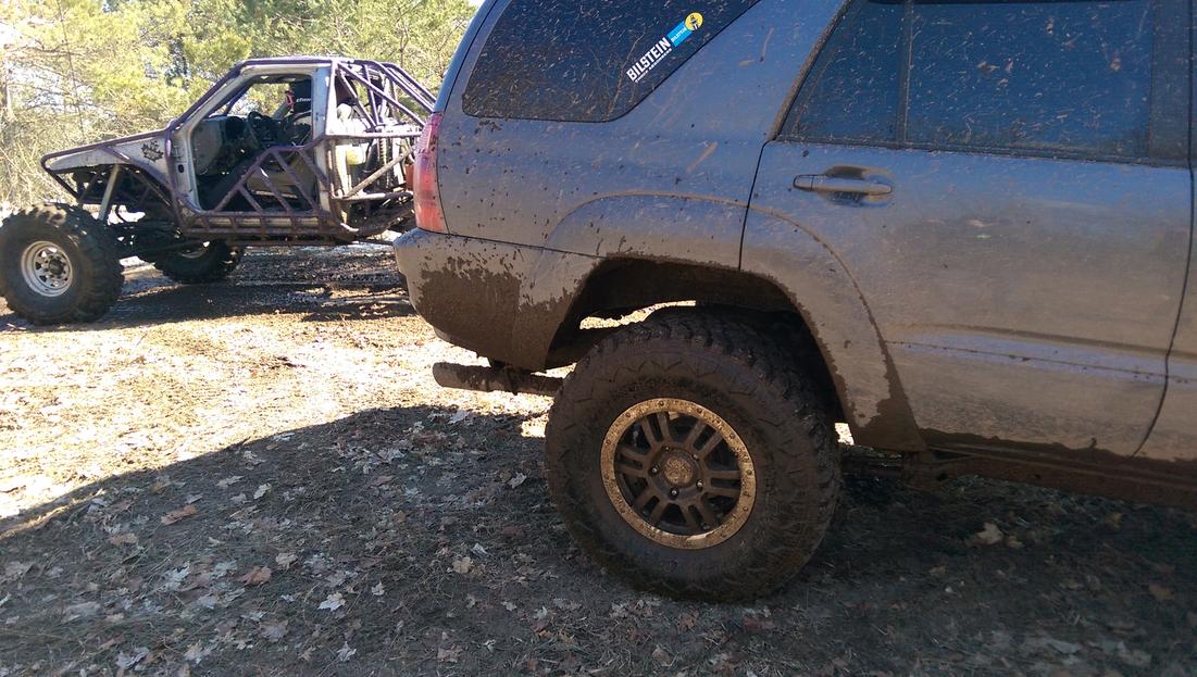

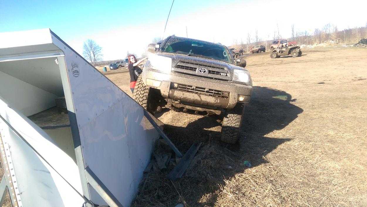

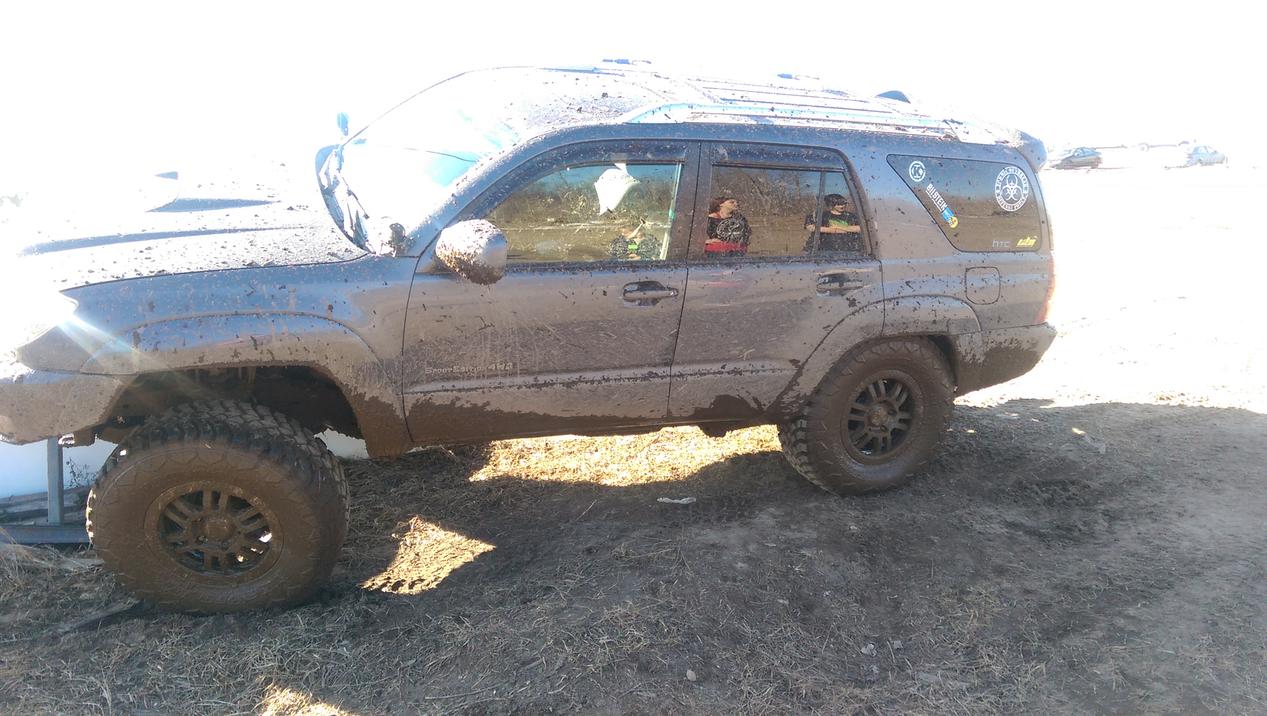

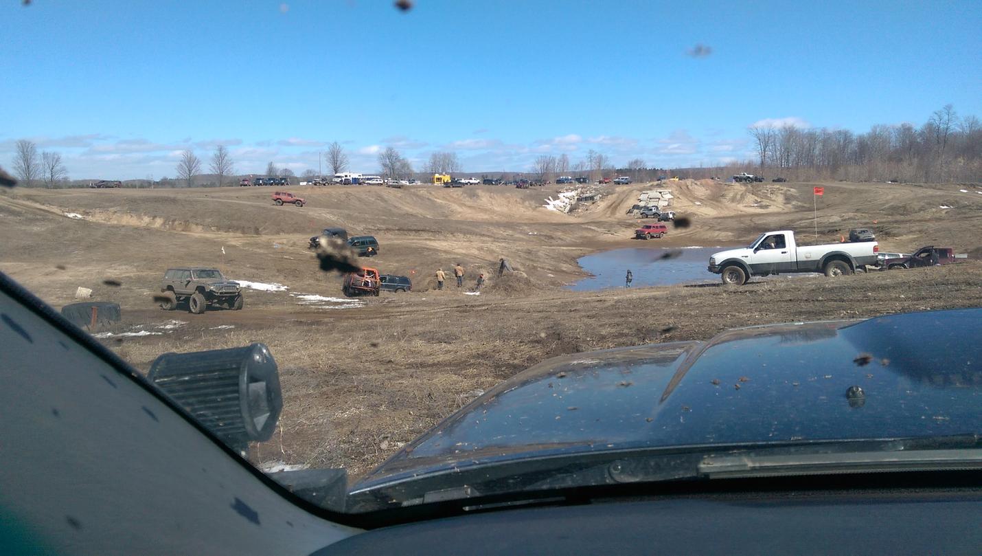

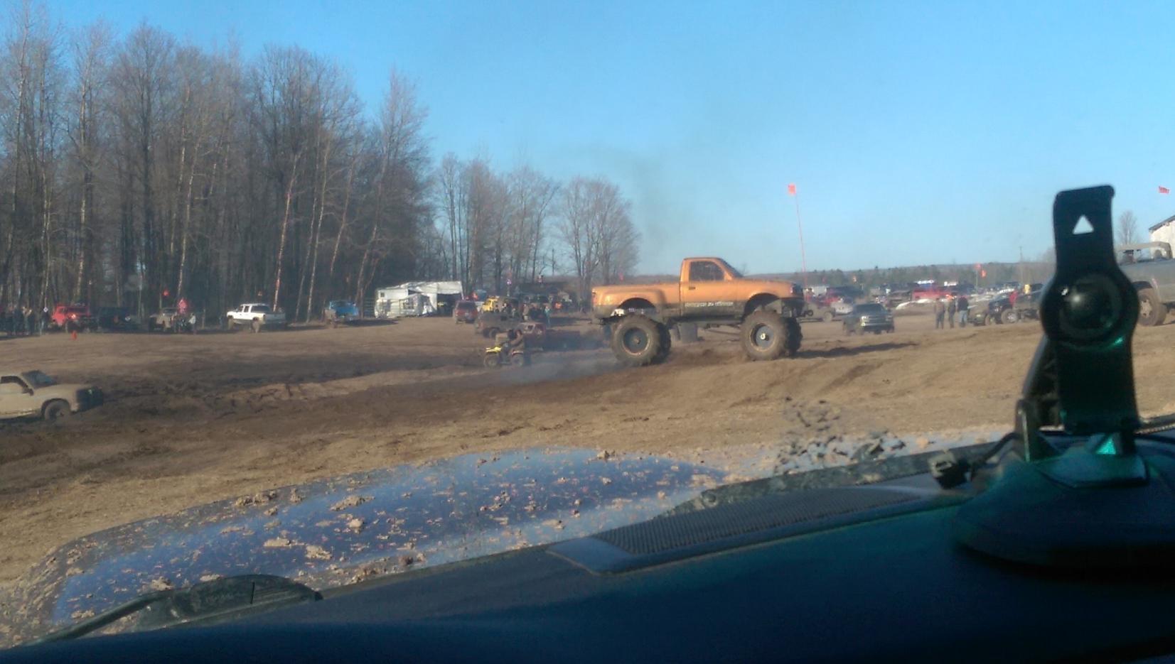

Took the kids and went offroading today!! We had a blast! I had people all over telling me how awesome my truck looked and that it was a tank the way it went through everything. I was climbing hills that Jeeps were having a very hard time on, or not able to make up, with ease! It was great!! My favorite part was a flock of Chevy's on swampers trying to climb this big hill. I watched them one by one take several attempts and finally make it up the easy spot. As they were jumping out and celebrating I promptly drove up and down all 3 of the hard, off-camber, and washed out lines, without spinning. I stopped at the top because they were all watching me and pointing and asked them where the hard hills were? One told me the only thing I had left to do was drive up backwords. :D I wish I could've taken more pics but I was to busy bombing around. My son took some video's which I need to look at and upload, if they aren't to bad. lol
Here's some pics of the RTI ramp and random vehicles in peril. :guitar3:
