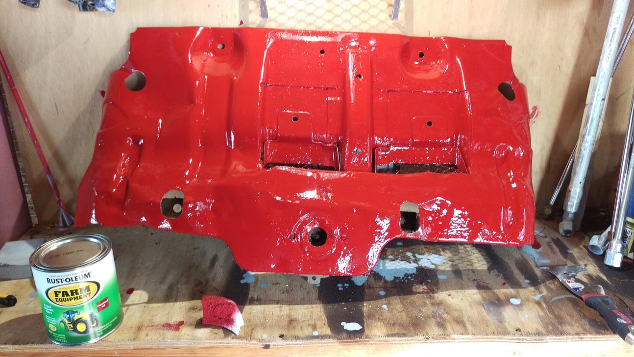

Cleaning up my skid plate. I pulled the front one off and used a wire wheel to clean it up, found out how mangled and rusted it really is. Will have to devise a new skid plate soon. The skid under the motor is stuck for now with seized up bolts. I used 2 coats of Rustoleum filler primer and sanded it down. I then put a coat of Rustoleum tractor paint on it. I have to do one more coat of paint then flip it over and do the underside. Here's a pic of it still wet. uploadfromtaptalk1441113319700.jpg

You still playing with them factory skids.... shheeesssshhhh.
I'm surprised you can still mount them, I had problems I pulled them off and beat on them to re install. I gave up......

i painted my factory skid to clean it up and tried to put it on afer my lift and it was kinda of a hassle and just left it off till i could afford some afermarkets!:D
but that sure is some bright red right there could deffinity notice that a mile away

Ya I'm surprised they've lasted this long. I think my only saving grace is I don't rock crawl.
I'm planning a new lift, bigger lift, that includes skids, so I'm waiting for that.
I'm really liking the red highlights theme. This red may be a little bright, not sure, have to rock it for a bit and see how I like it. Lol

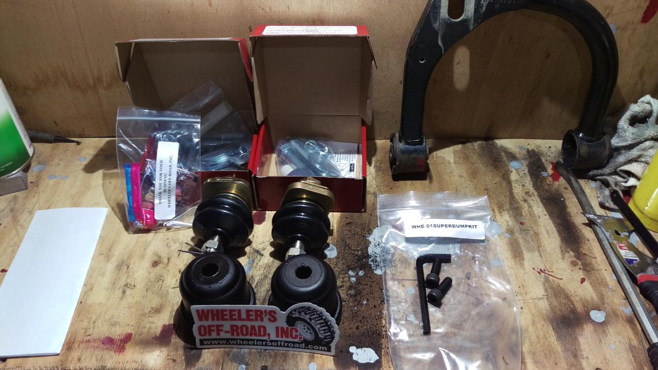

Received some parts from Wheelers Offroad.! Getting closer.
Super bumpstops
Spc ball joints
Cam bolts
And my personal favorite!
Little bag of candy and a sticker!!!

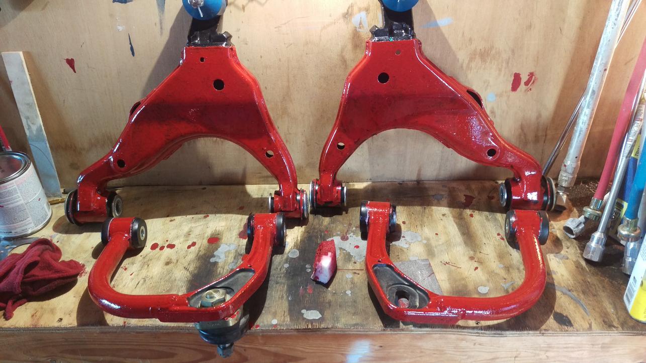

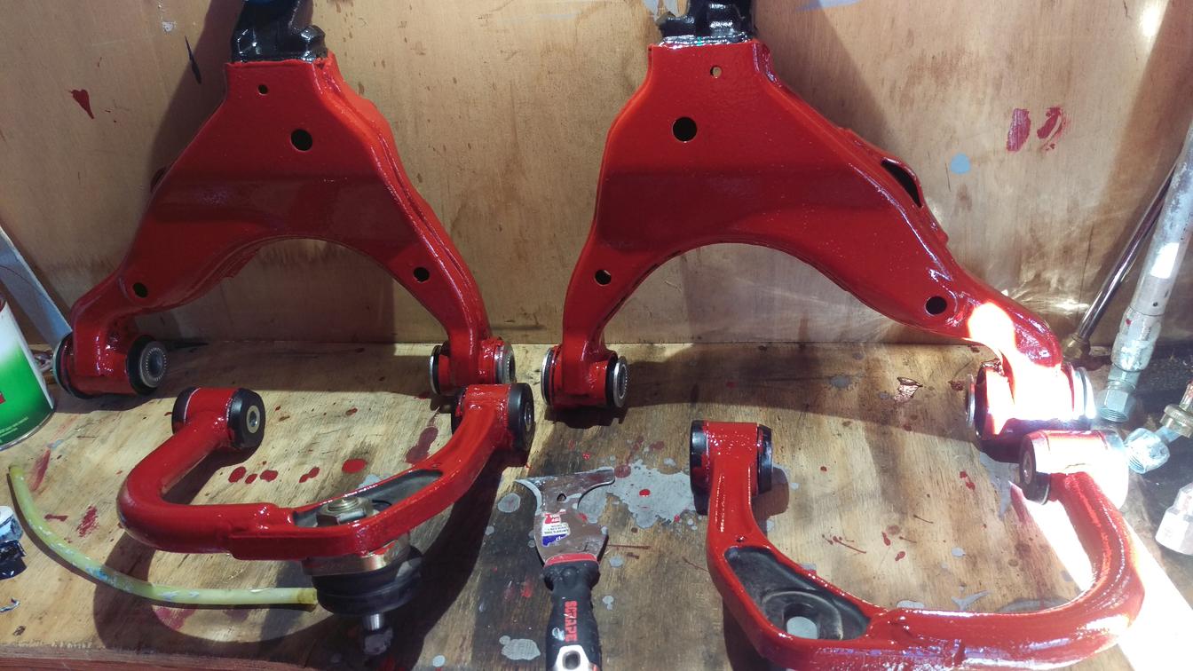

Painted my uca's and lca's. Hopefully getting them in this weekend!
First coat
Second coat

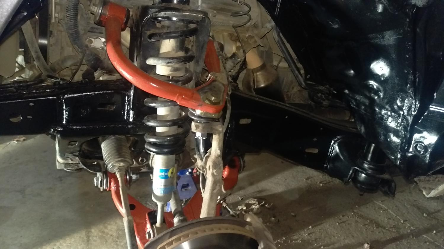

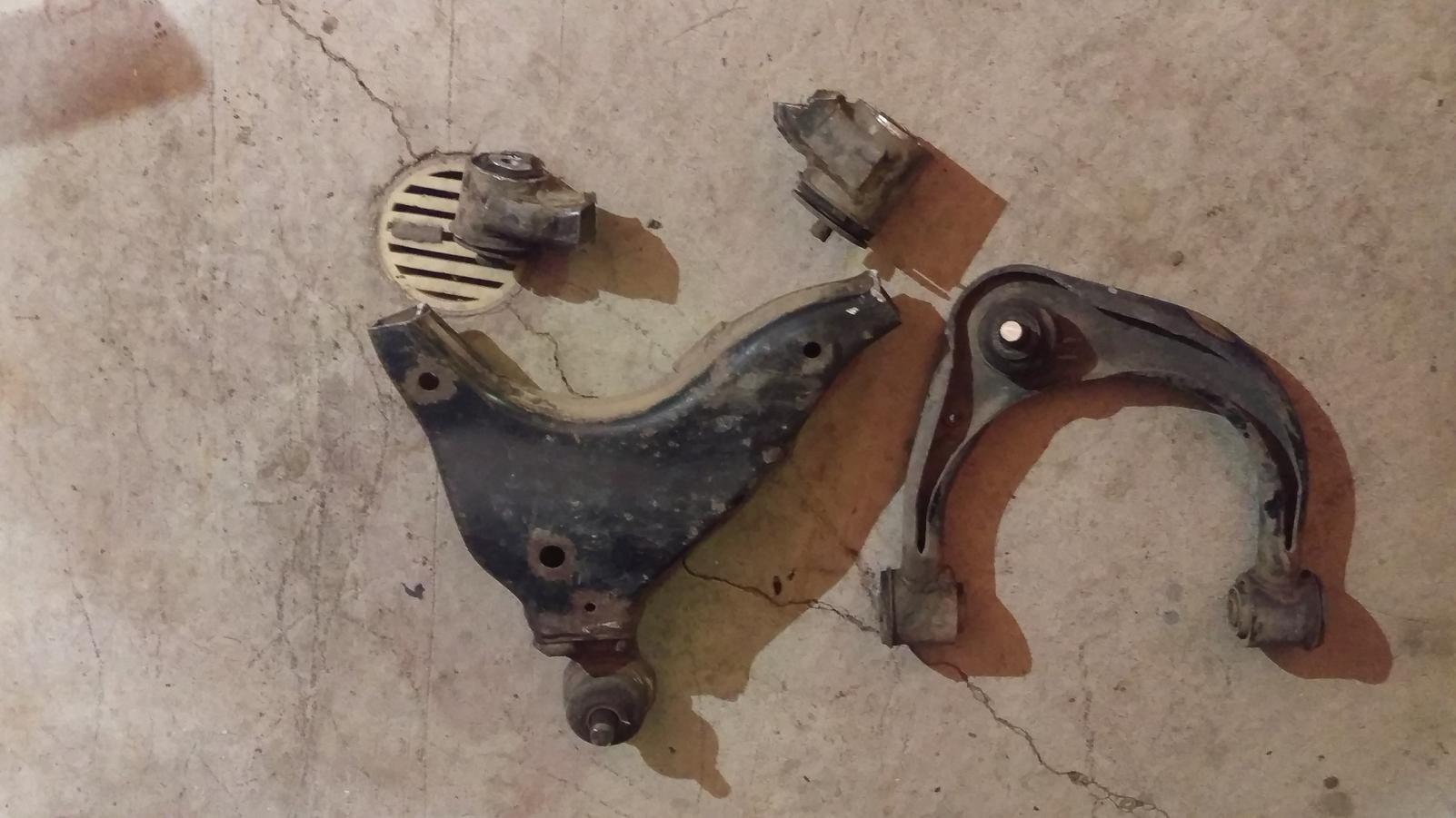

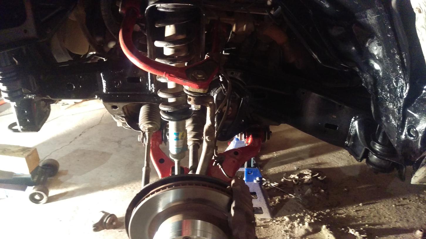

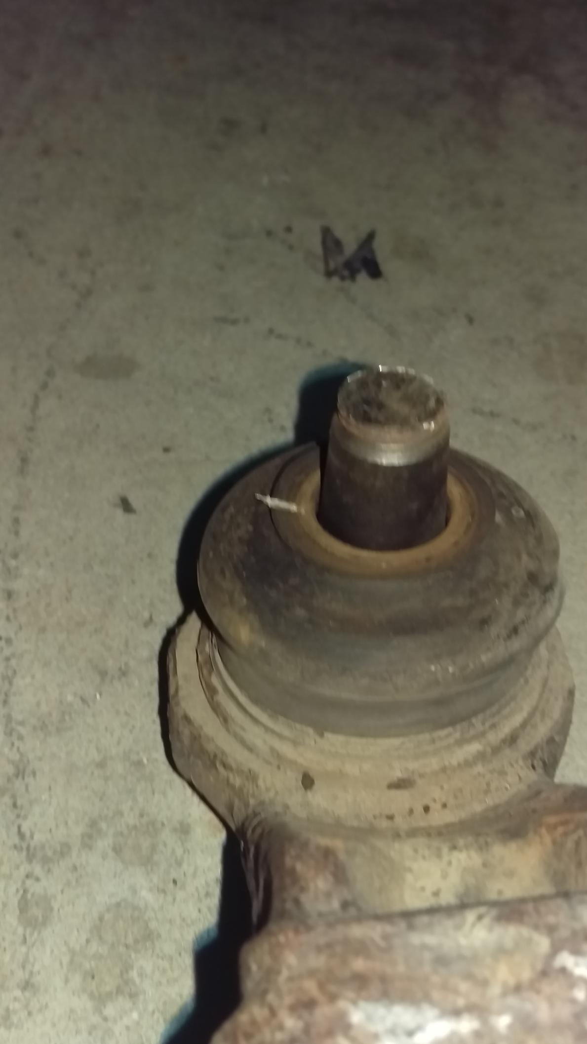

Install was successful. Will post pics tomorrow. What a *****!! 3 frozen ball joints, 4 frozen cam bolts, tons of cutting! 5 Sawzall blades, that were worthless, and 3 cut off wheels, that really saved my ass!
Finished pic, before alignment and putting skid back on.

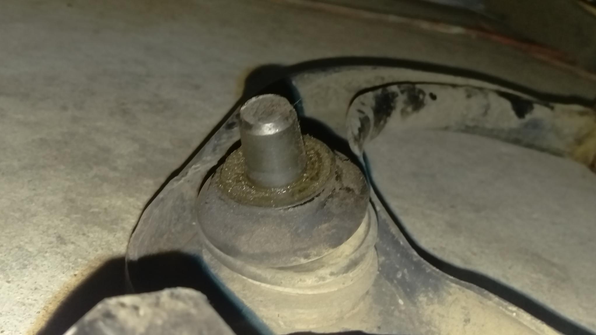

Ok, so, lessons learned? Do yourself a favor and get several 7" cutting disks, not the 4.5 inch ones like I did! The 4" ones are just slightly to small to reach. Actually some 6" ones will probably work too. Pry bars, breaker bar, lots of lube! Lol, PB Blaster or something like that should suffice. Torque wrench is also a must!

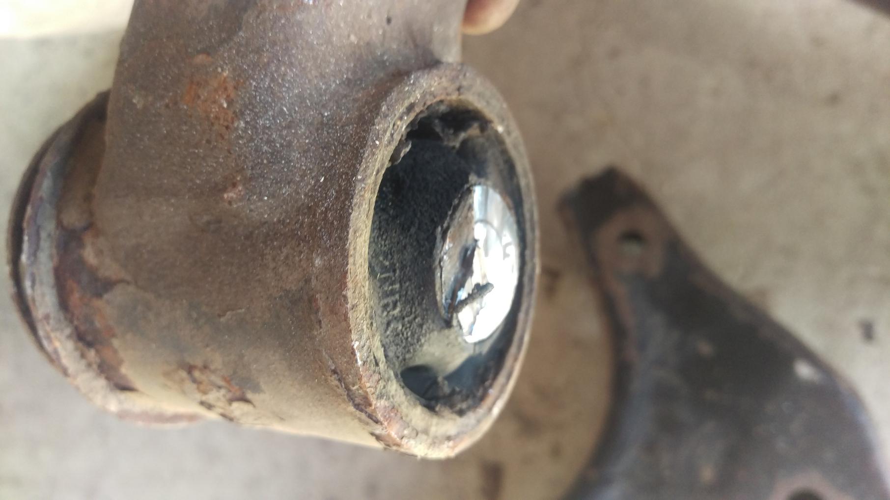

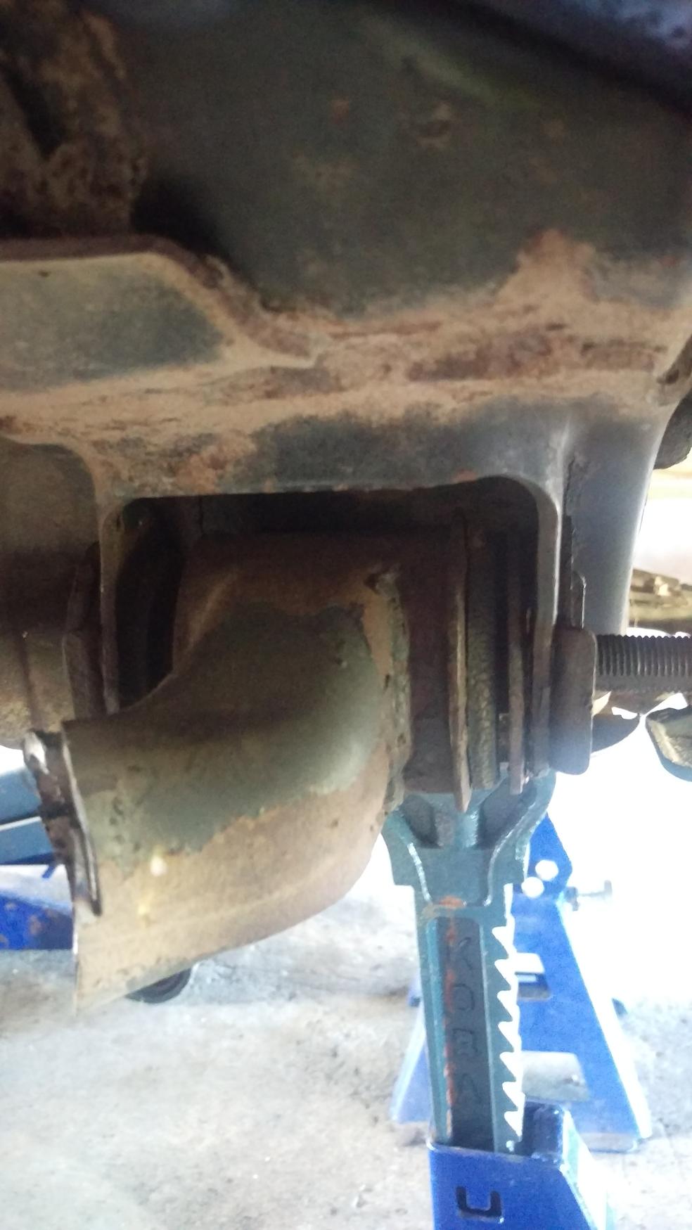

So, Sawzall was a joke. Literally just flattened the teeth. I couldn't get the grinder up in there far enough so I cut the arms off then worked on weaseling my way in deep enough to cut the bushing pins out. Took lots of shifting things around, but managed. The cam tabs were so rusted I had to beat them with a sledge after cutting out the bushing pins!

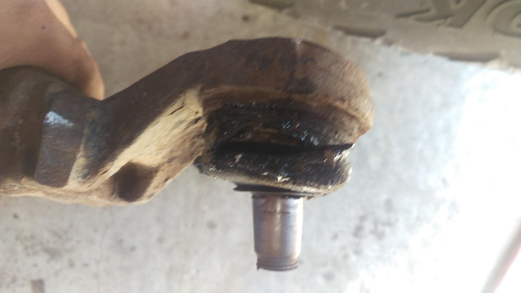

To add to my pain, all but one of the ball joint nuts where locked right up! I couldn't even get the pins out, so, back to the cutting disks. All the ball joints were shot too.

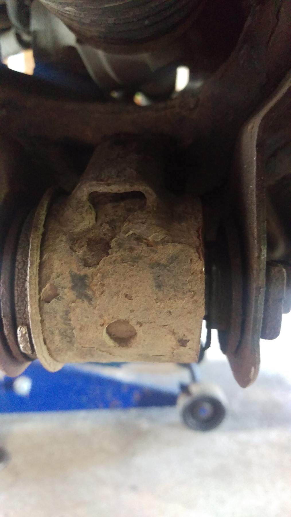

I had tons of pay in the bushings, especially since the were locked right up. They were distorted over half an inch backwards.

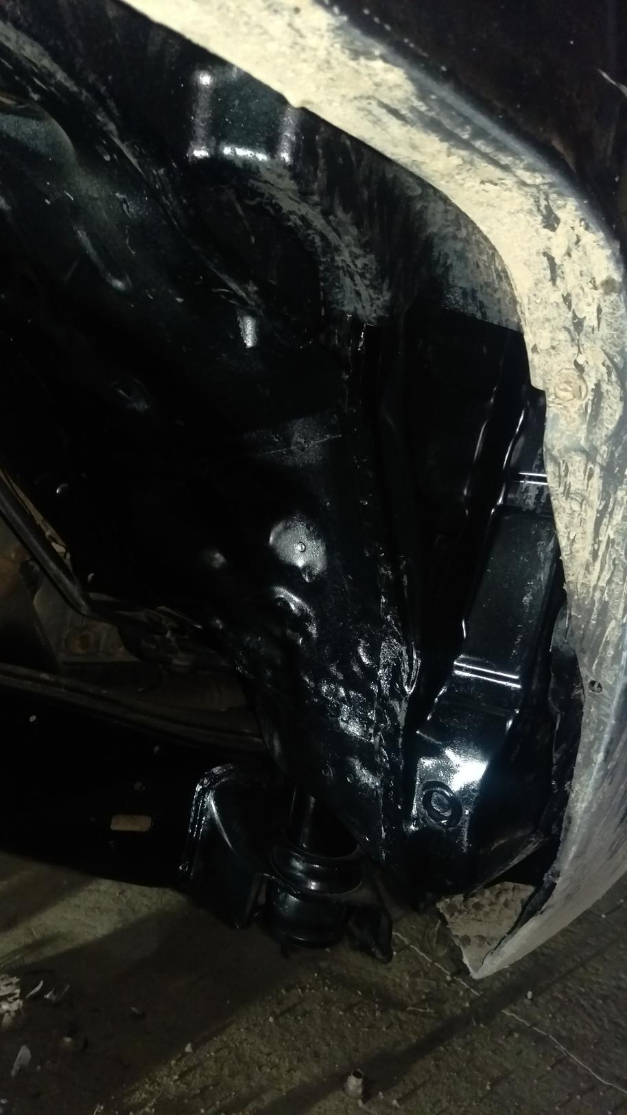

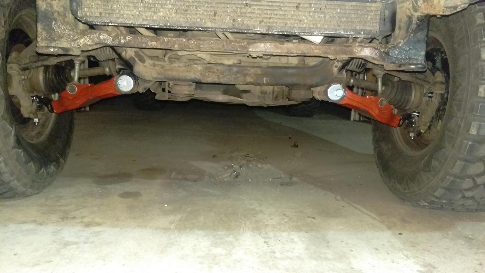

I cleaned everything up while I was down there. Used rust converter on the frame and chassis paint on everything. I trimmed my plastic liner farther up and finished flattening my pinch welds. Wire wheel was a HUGE help throughout this.

After I get the alignment done and the front skid on I'll post a finish shot.
Next time I have to do wheel bearings I think I'll paint the knuckle up.
I also have some touchups to do on the control arms. Little more paint and you'll never know!
