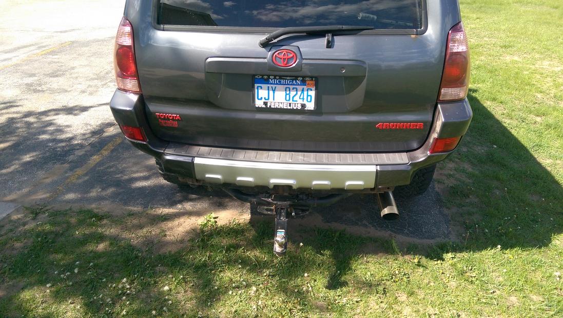

Haven't updated in forever, things have really picked up with the warm weather! Recent things I have done, replaced the muffler with straight pipe! This thing sounds awesome!
The other day I polished up my headlights as they were starting to haze pretty bad. Much better now, but there's a ton of cracks in the lenses. Will need to get new ones one of these days.

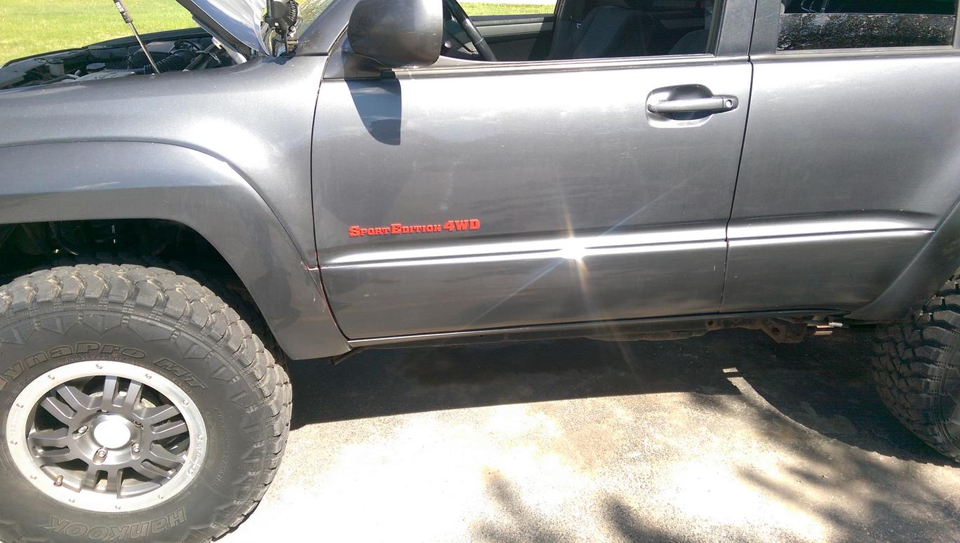

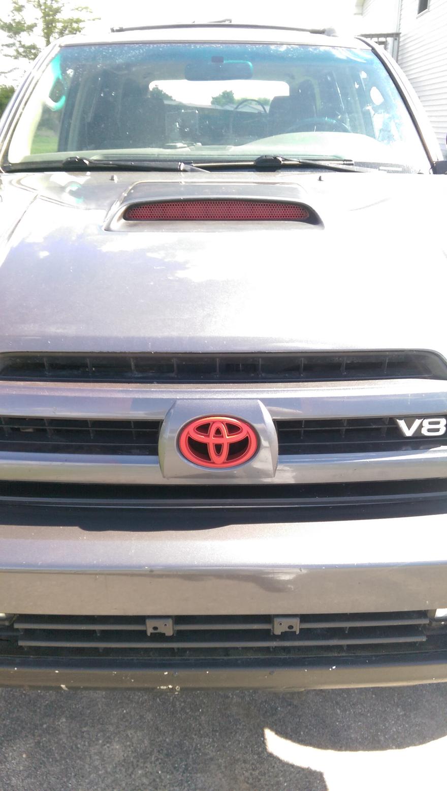

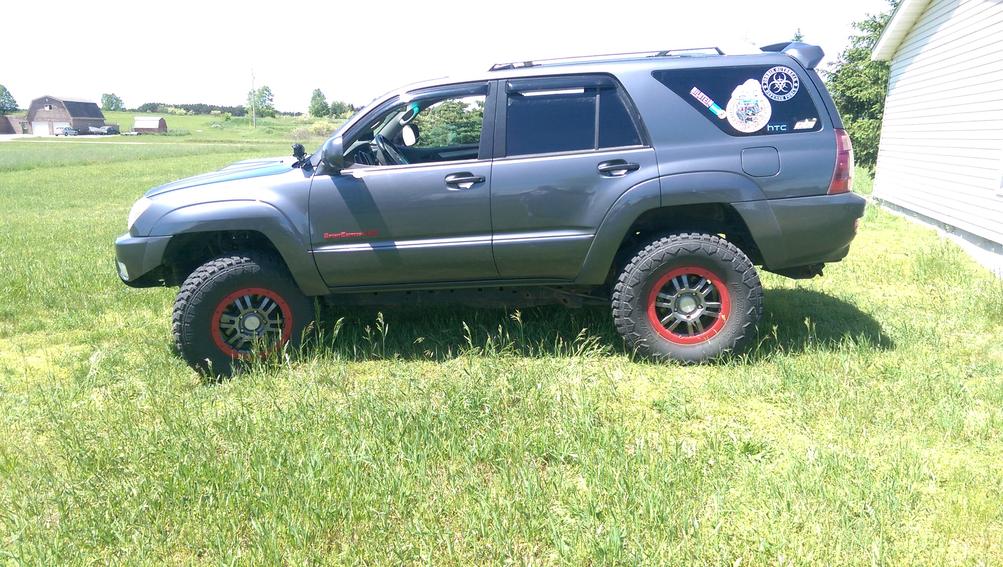

I used plastidip to make all the badges red on my truck, I'm really digging the new look!

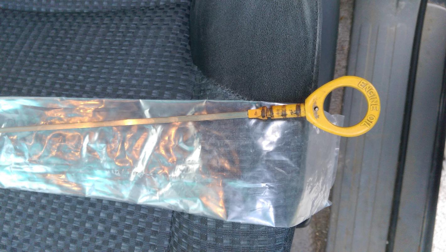

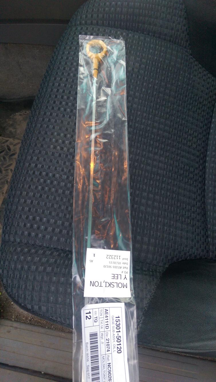

The other day I about had a heart attack! I checked my oil and noticed what looked like metal shavings... After tripping ballz all night I went to my oil change place, they're awesome there, and they pulled the plug and filled a Styrofoam cup with oil. Then we ran a magnet in there which came out clean. Just to make sure we dumped the oil out slowly but didn't find any flakes! I then realized that my dipstick was missing the o-ring and that dirt was getting in there. So I stopped and bought a new one.

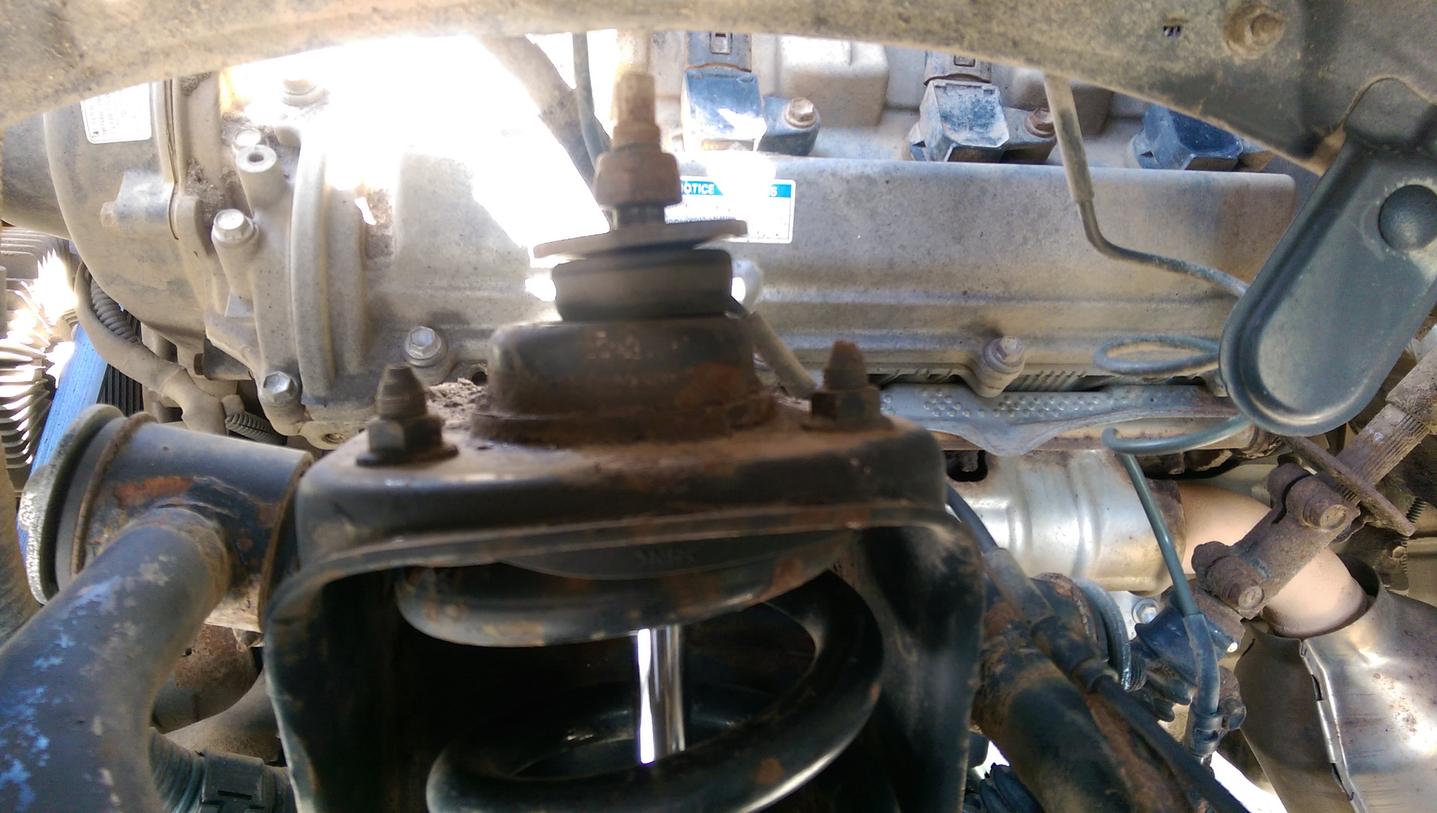

While checking everything else out I was looking for the source of a clunk and found that my strut mounts are shot! So, I ordered new ones and will have them by Friday.

Finally was able to change the upper strut mounts, what a difference! I'd say the originals exceeded their life expectancy....
My truck was bouncing all around over bumps and pulling all over when hitting the brakes, very stable now with the new parts! Love it!

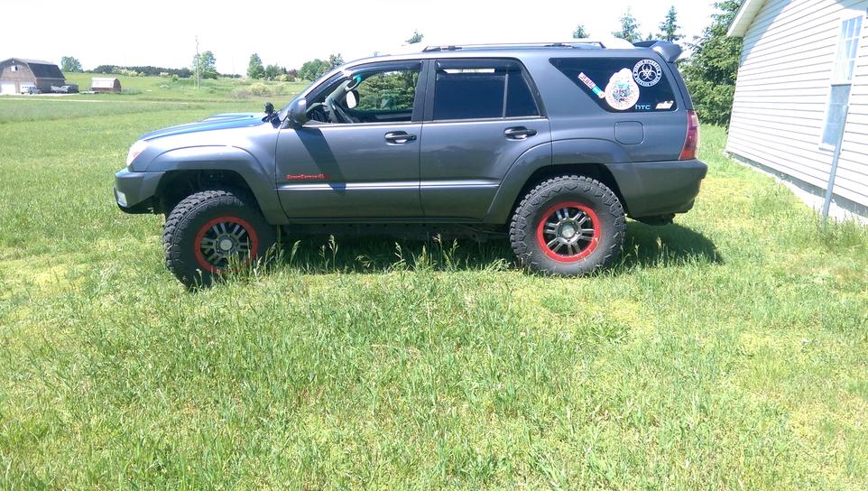

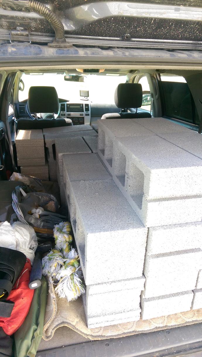

Hauled 40 block to the house I'm buying so that I can put 4 piers under it per govt. guidelines. She was squatting hard with 1500 lbs plus me, but did great!!
Blocks galore!!
Squatting
Back where she belongs

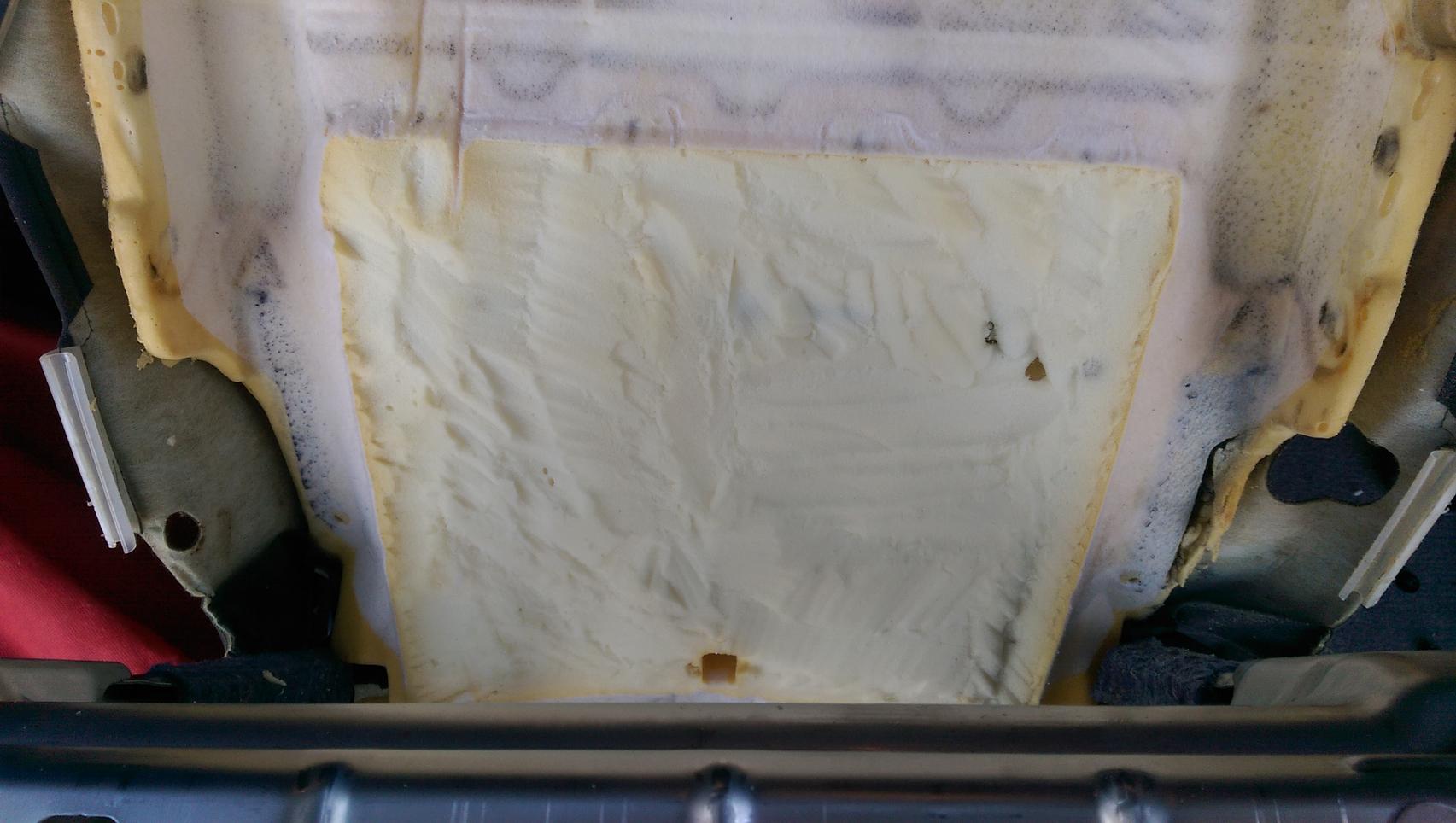

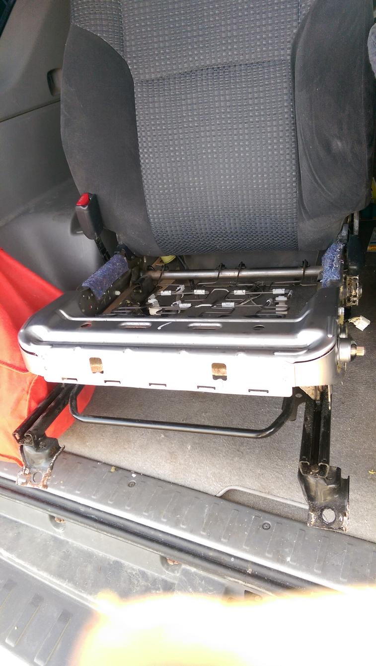

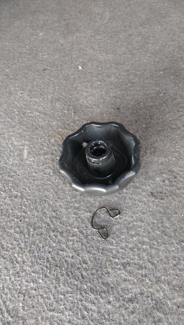

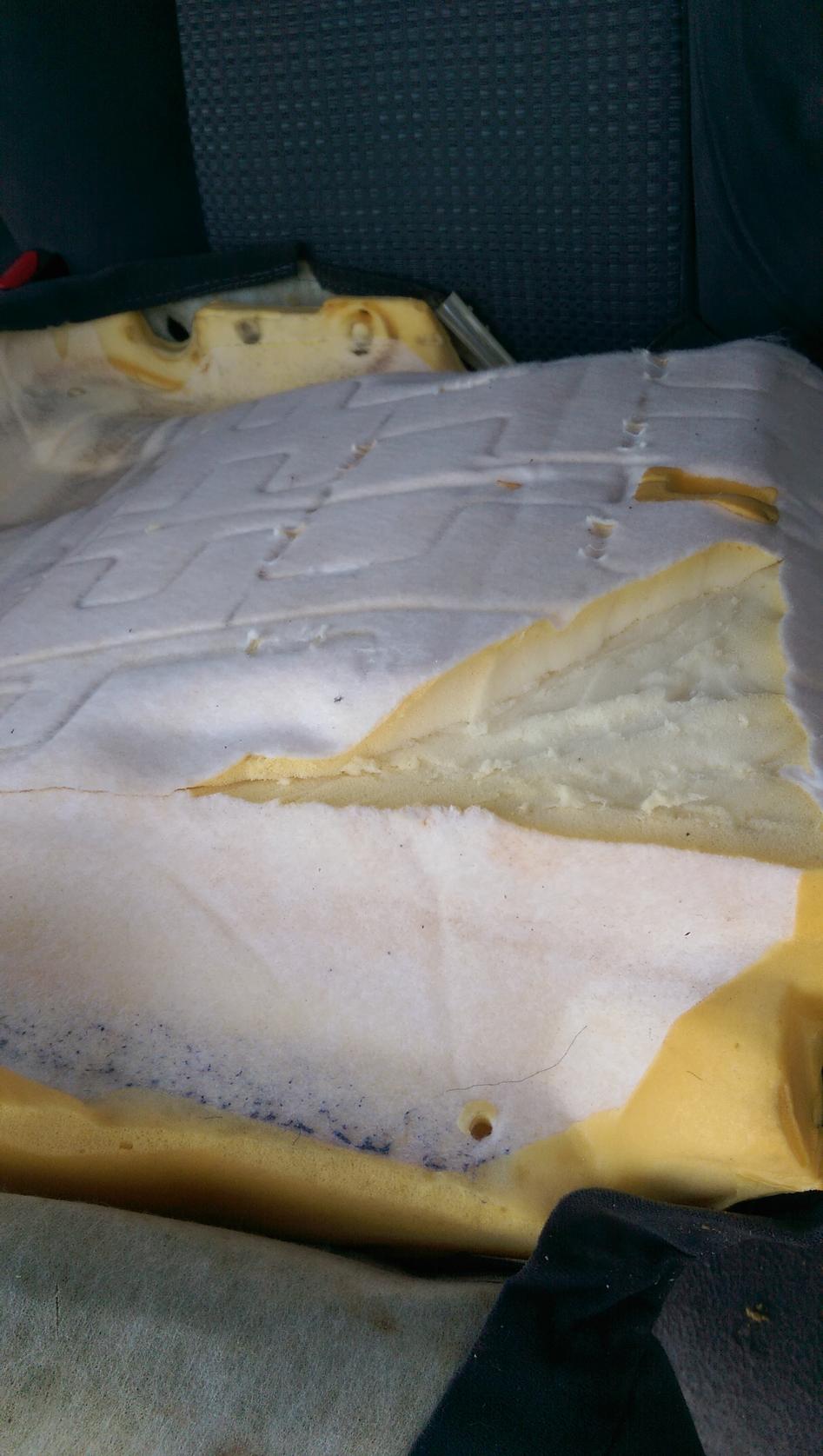

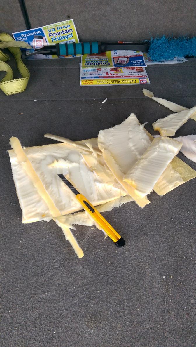

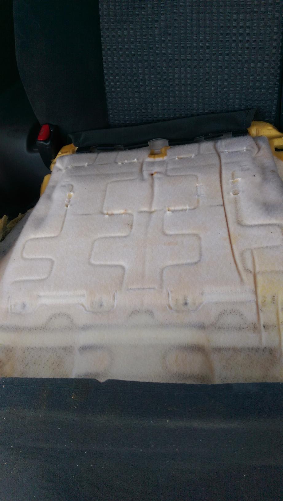

I'm tall...too tall! I got the idea from a forum over on the Toyota 120 about getting rid of the sunroof. One guy was talking about how he pulled the bottom seat cushion and trimmed the bottom of it so that he sits lower now. So today I went out and tackled that. Was pretty simple once I figured out how to get it apart. The seat cover has little tabs around the perimeter that hold it on. Take those off and then if you have the manual seat like mine there is a clip that holds on the turn nob. I then used a razor knife to cut the foam down. I can actually move the seat in an upright position now instead of having the gangsta lean! :fro:
What did you use to get the seat out and cushion out? I've had problems with mine for awhile now but the last time I tried to take the seat out it was bolted in real well haha
Just a ratchet and socket, took the 4 bolts out. Required a little muscle to break them loose and then they were fine.
Maybe try a little pb blaster, let it sit for 30 minutes.
Love that exhaust sound... where did you buy those strut mounts and how hard to put in
Bought them off Amazon. Amazon.com: KYB SM5640 Strut Mount, Insulator, Bushing and Washer: Automotive
They were really easy. Pull the two bolts that hold the lower balljoint assembly on the knuckle, unscrew the 3 nuts on the top of the strut, then the lower bolt, pull it out and then use a spring compressor to tighten up the spring. Then you just take the center bolt off the shock holding the cap on, take off the strut mount and slap on the new one. I think it took me 20 minutes a side. Its a little tricky bolting the two bolts holding the lower balljoint back in. They have to be aligned perfectly and that thing moves so easy it is hard to line it up. An extra set of hands is a huge help!
*If the strut is stuck up top there like mine just beat on it with a hammer, it'll pop right out.
Thank you sir, Ill probably keep this on the wishlist for when its time to do coilovers.
Gibson cat back, then replaced the muffler with straight pipe. Lol
haha Nice! I was gonna say that sounded a bit more throaty then a normal catback. Why ditch the gibson? Not loud enough? Ive been thinking about getting that for mine. I dont want to loud or droney though. I think ive grown past that for my daily driver.
I didn't like that at higher rpms the Gibson got all shop vac sounding. Now it has a rich deep rumble all the time. It's surprisingly quiet unless you get on it. Less drone as there isn't a muffler to cause drone. I can still listen to the radio normally, carry on conversations, etc without any issues.
I believe you, but its hard to believe without a muffler there isnt drone or its so loud inside you cant think. I dont think I could make that decision until I heard it in person. However you video sounds sick lol
