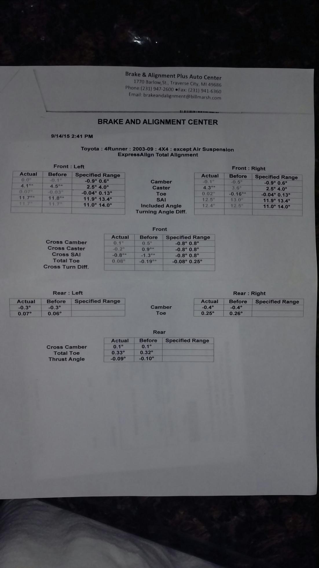

Here's my alignment numbers. I am getting a slight pull to the left, but I'm wondering if I need to rotate the tires as everything was so far off before. Any thoughts?
After changing to Camburg arms, I still have the slight pull to the left also. The shop also rotated tires around and didn't cure the problem.
Camber 0.0, toe .06 both sides caster off at 1.3&1.6.
My thought, new tires as no wear pattern to them yet, or adjustable rear components.
