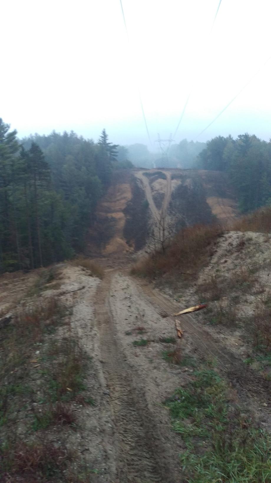

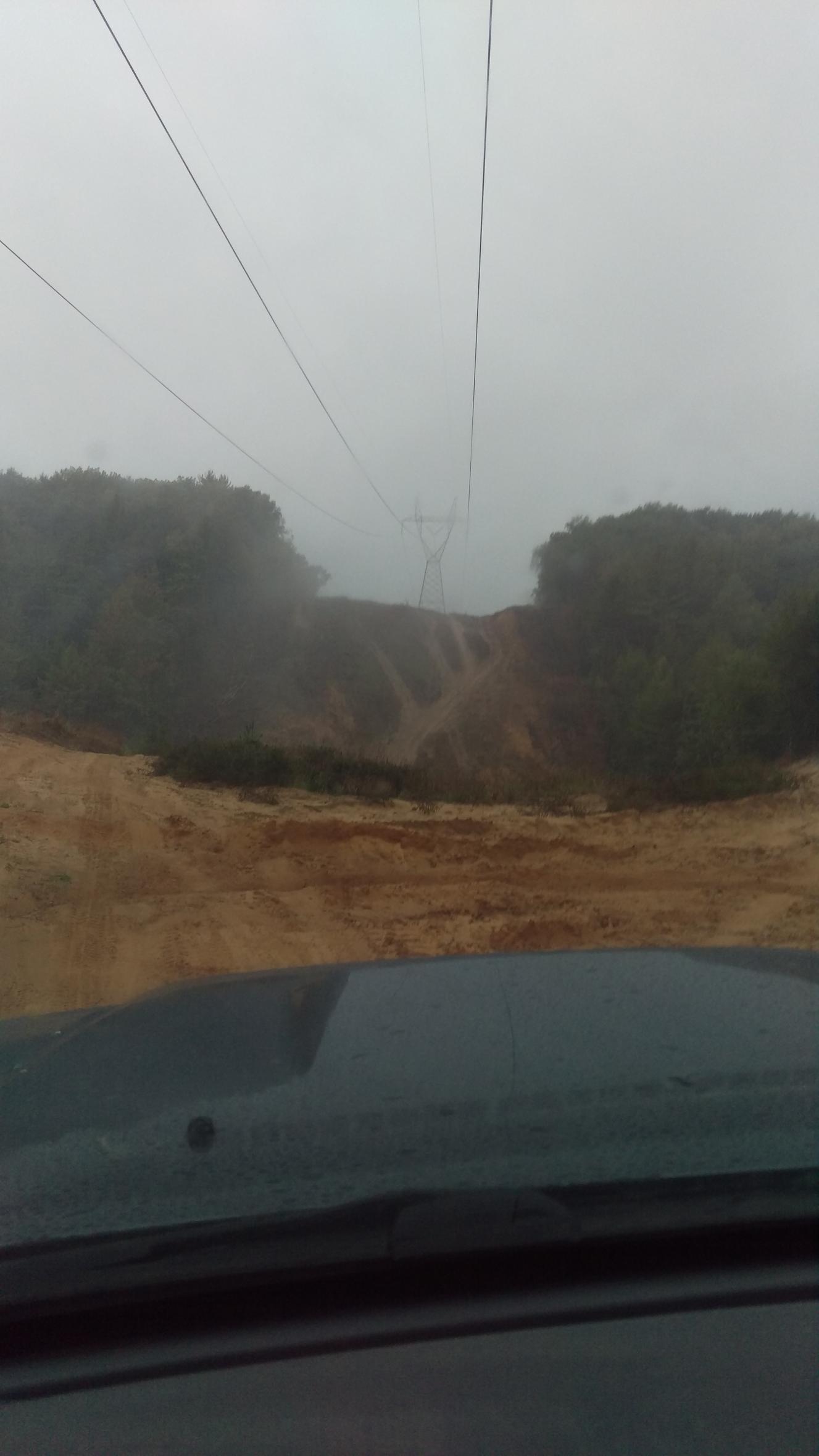

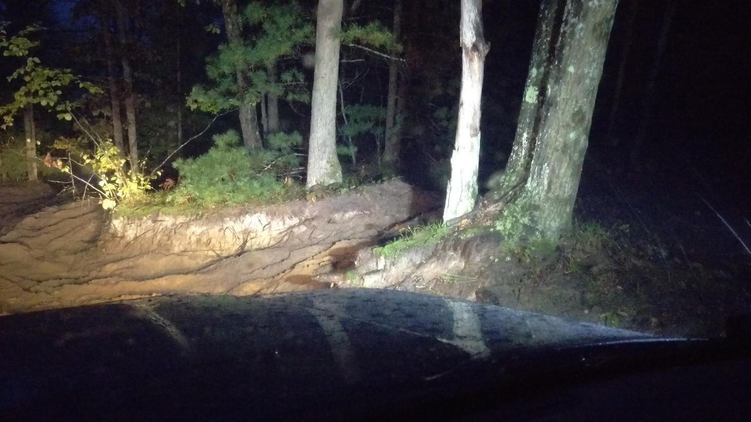

This tree root I was trying to take an accurate picture of is almost to my waist high! uploadfromtaptalk1444351990037.jpguploadfromtaptalk1444352027838.jpg

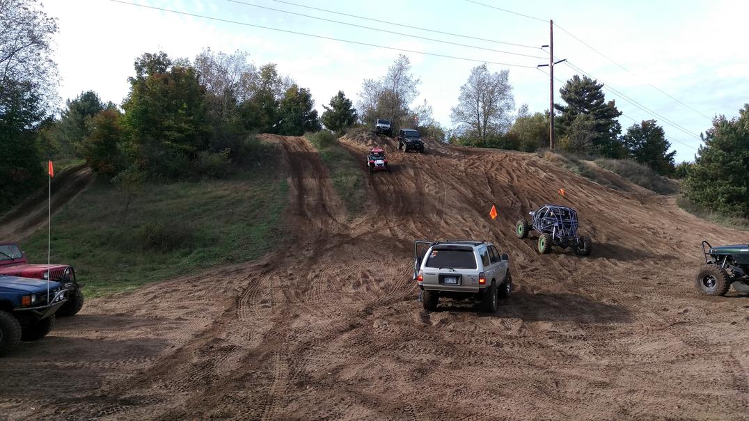

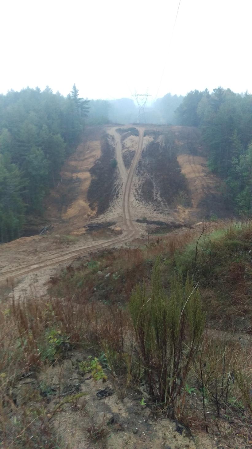

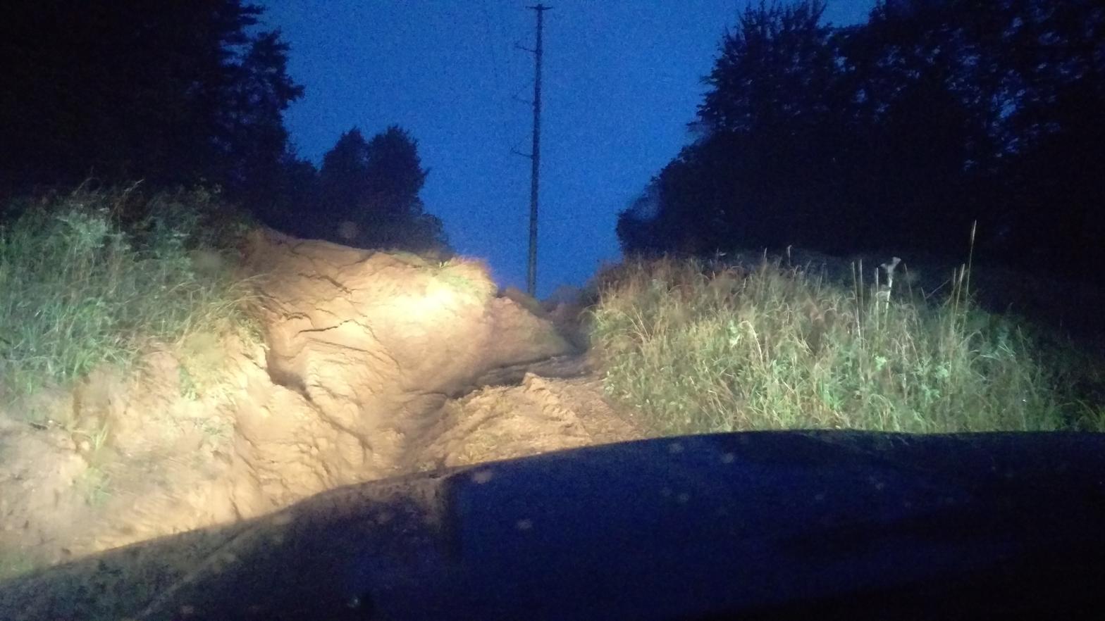

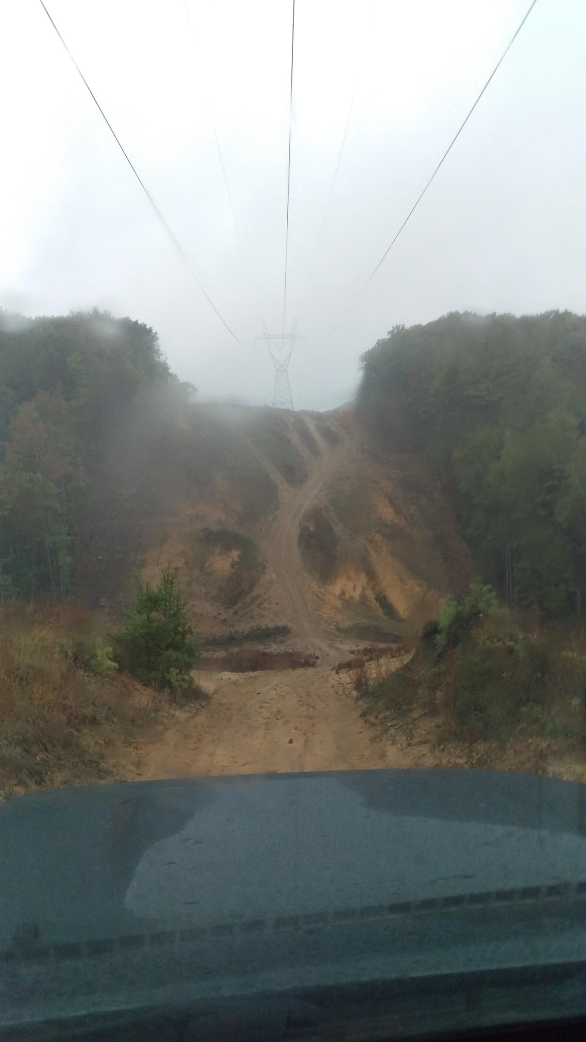

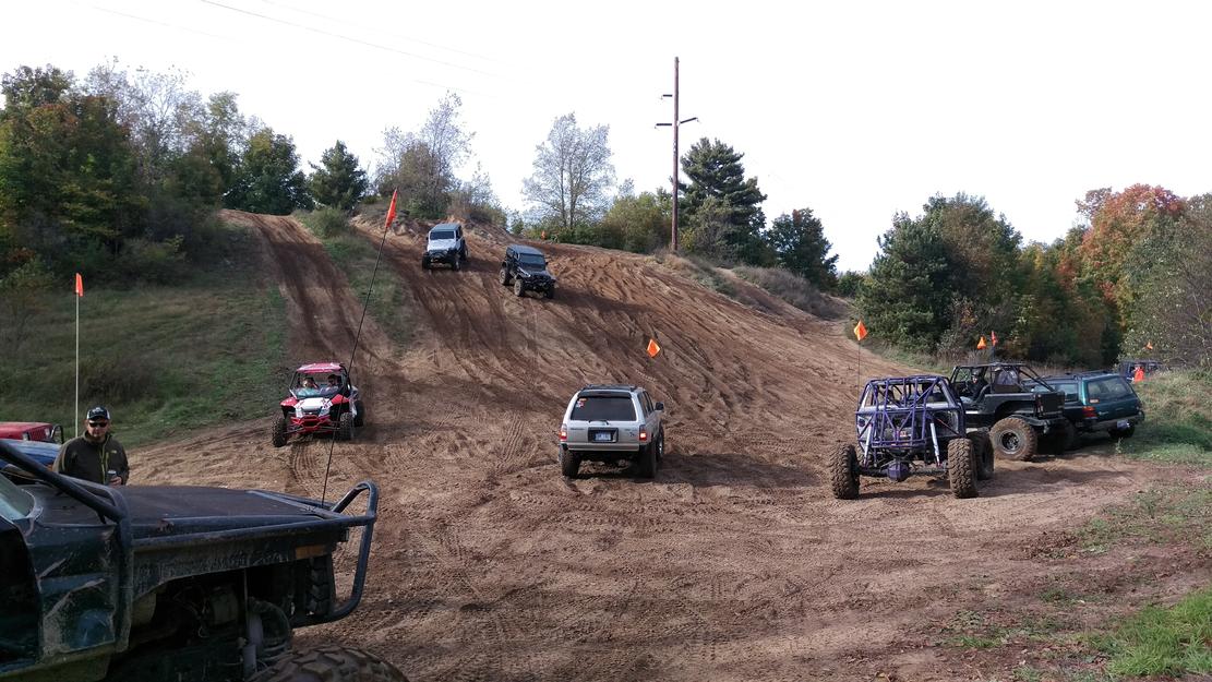

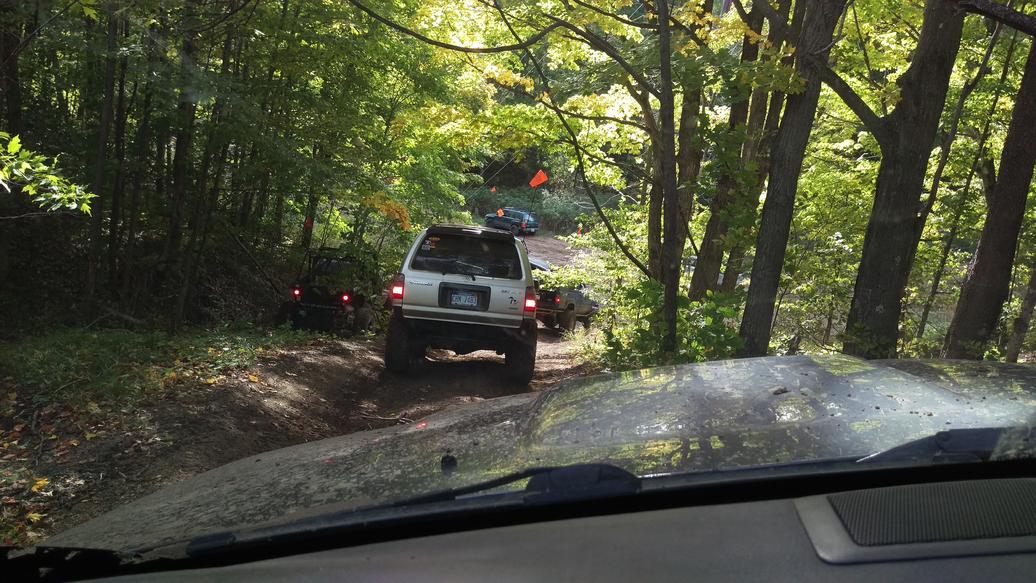

This Hill is crazy big! I have to hold it to the floor and hope for the best to make it over the top. Took me two tries today. uploadfromtaptalk1444352107508.jpguploadfromtaptalk1444352171845.jpguploadfromtaptalk1444352250341.jpguploadfromtaptalk1444352295760.jpg

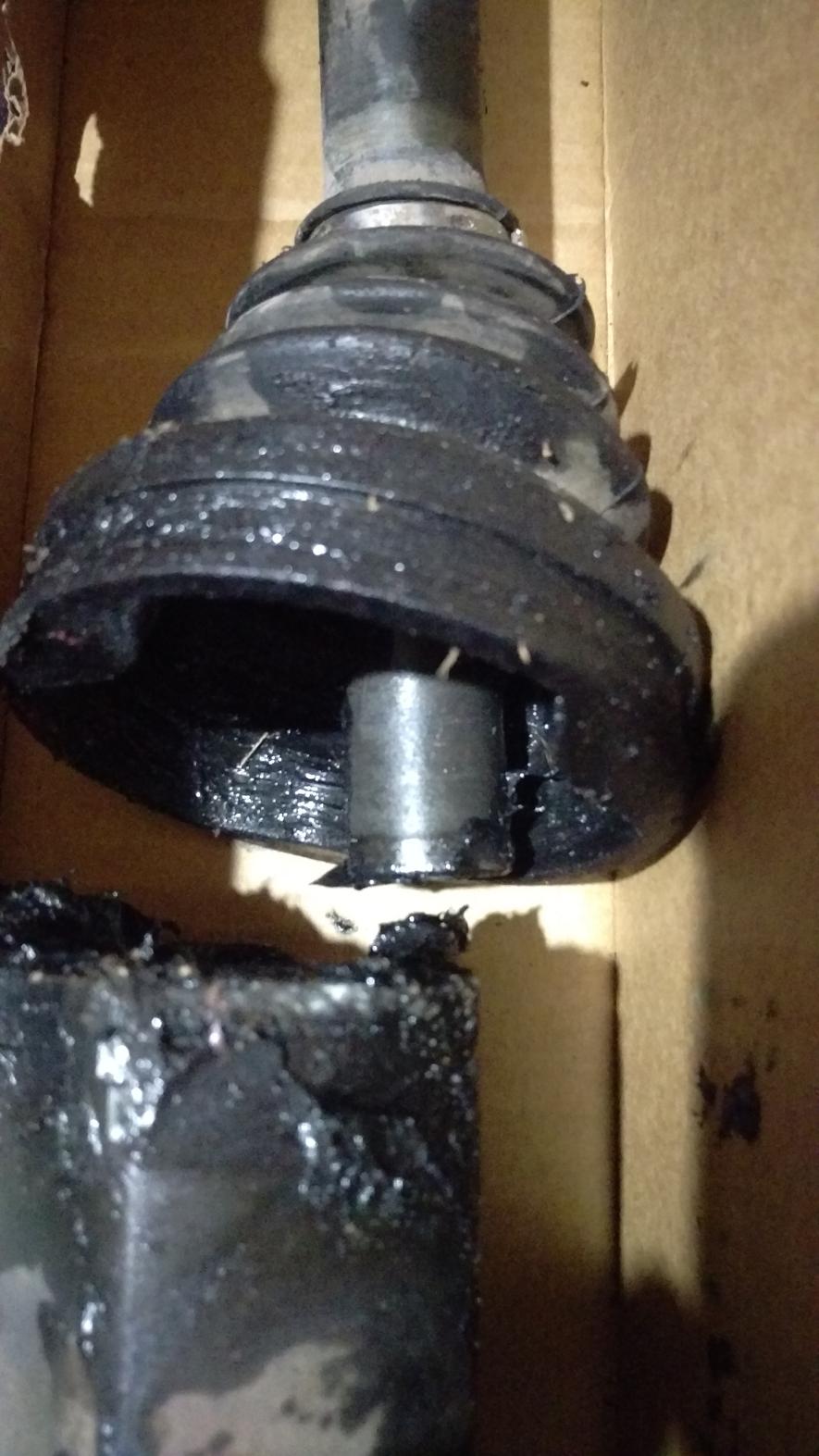

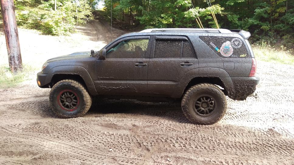

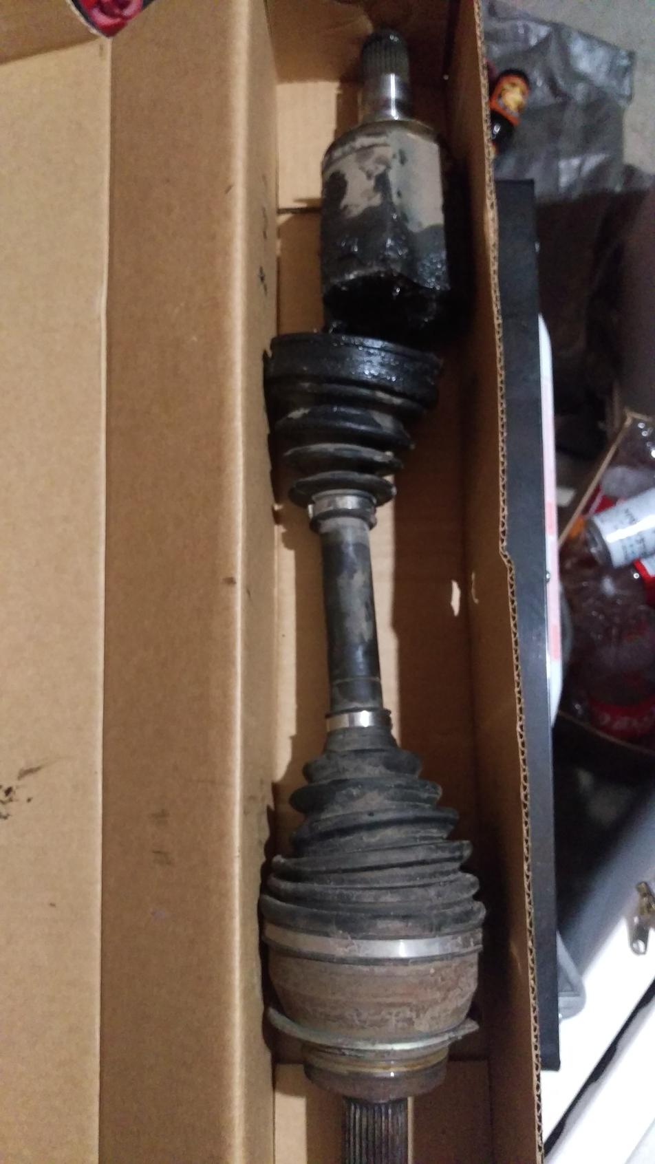

Went to the offroad park today, took my 7 yr old and had a blast! Came across a group of 8 jeeps, 2 buggies, and 4 4runners. 2 first gen, 2 3rd Gen, I was the only 4th Gen. Went through a mud hole to fast and got water in the intake, then broke my drivers side cv axle that I just replaced a few months ago. I've had suspicions that it wasn't very good right from the beginning, guess this confirms it. It was the regular Cardone not the HD one like I have on my passenger side.
I'm buying a new one from autozone that is duralast brand and has a lifetime warranty. Entirely worth it for $61!

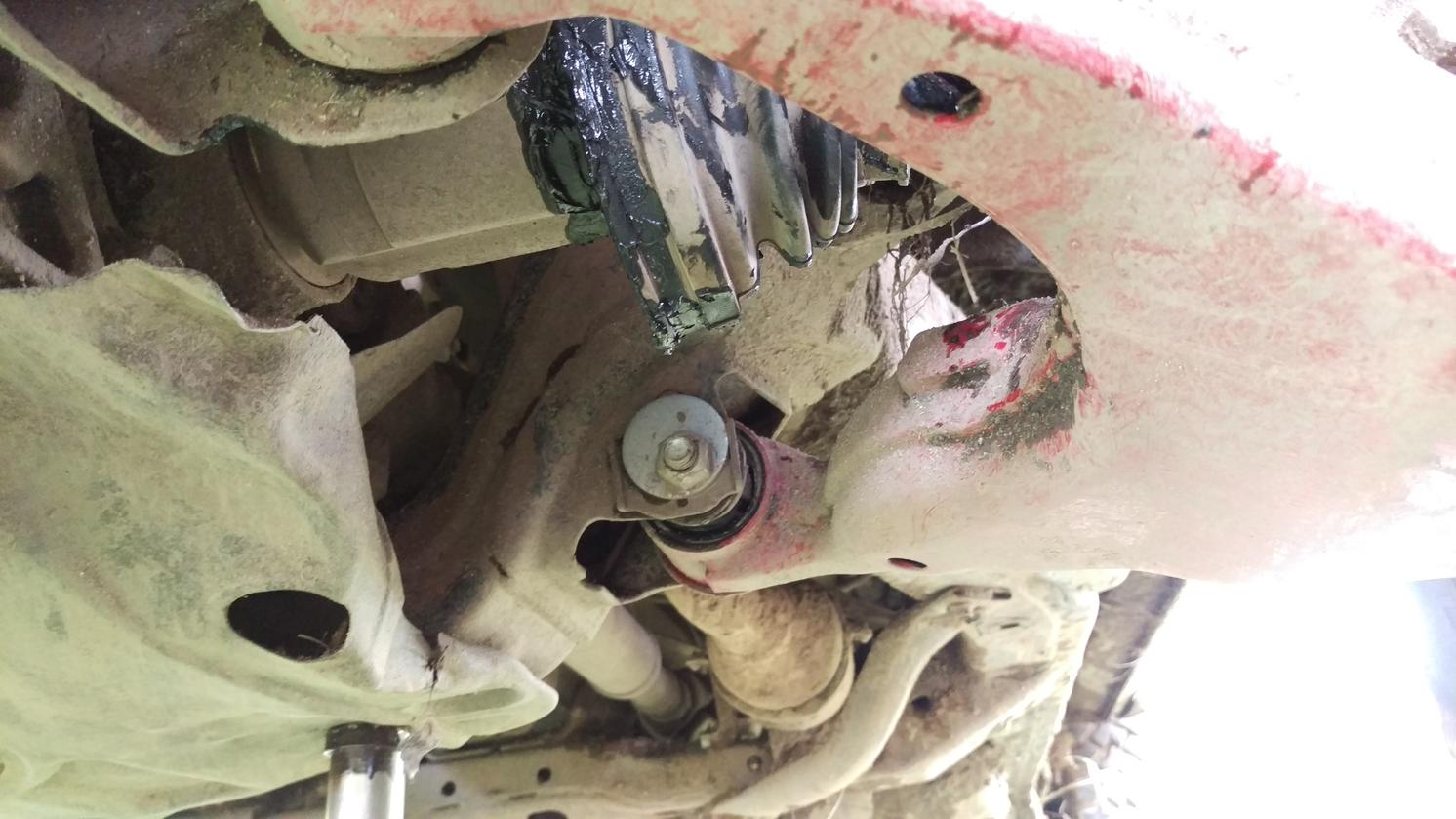

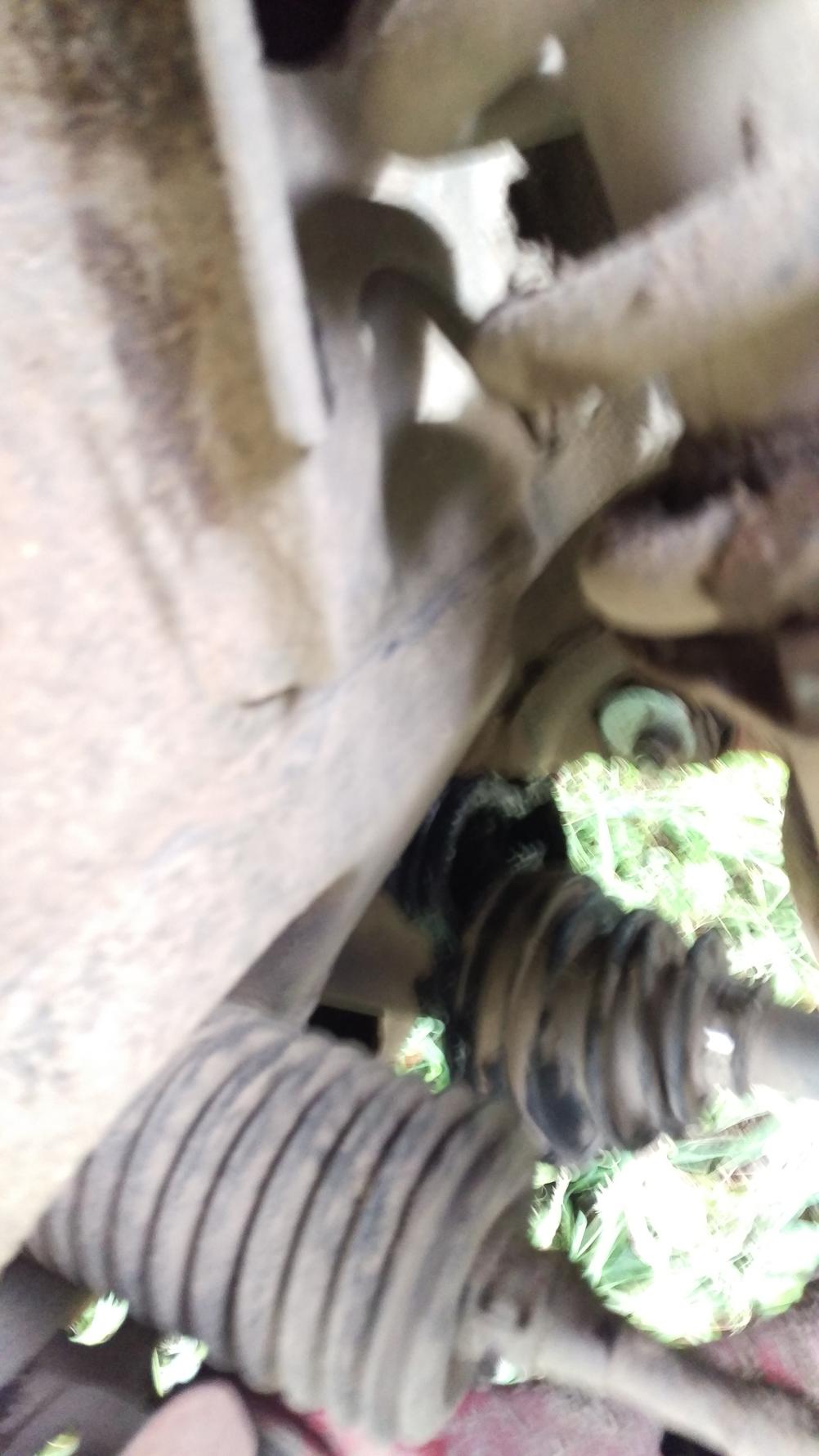

Replaced my broken cv axle today. Sheared that sucker clean off! Lol uploadfromtaptalk1444703921161.jpguploadfromtaptalk1444703942893.jpg
Nice work! Vsc/A-track doing its thing?
Thanks!
Yup, I worked the hell out of it this last weekend! I have to say, I don't know if it's worth my cost to get lockers for it. Probably, but I haven't needed them so far. Of course, I don't rock crawl, but I've had tires in the air many times and it just keeps chugging on.

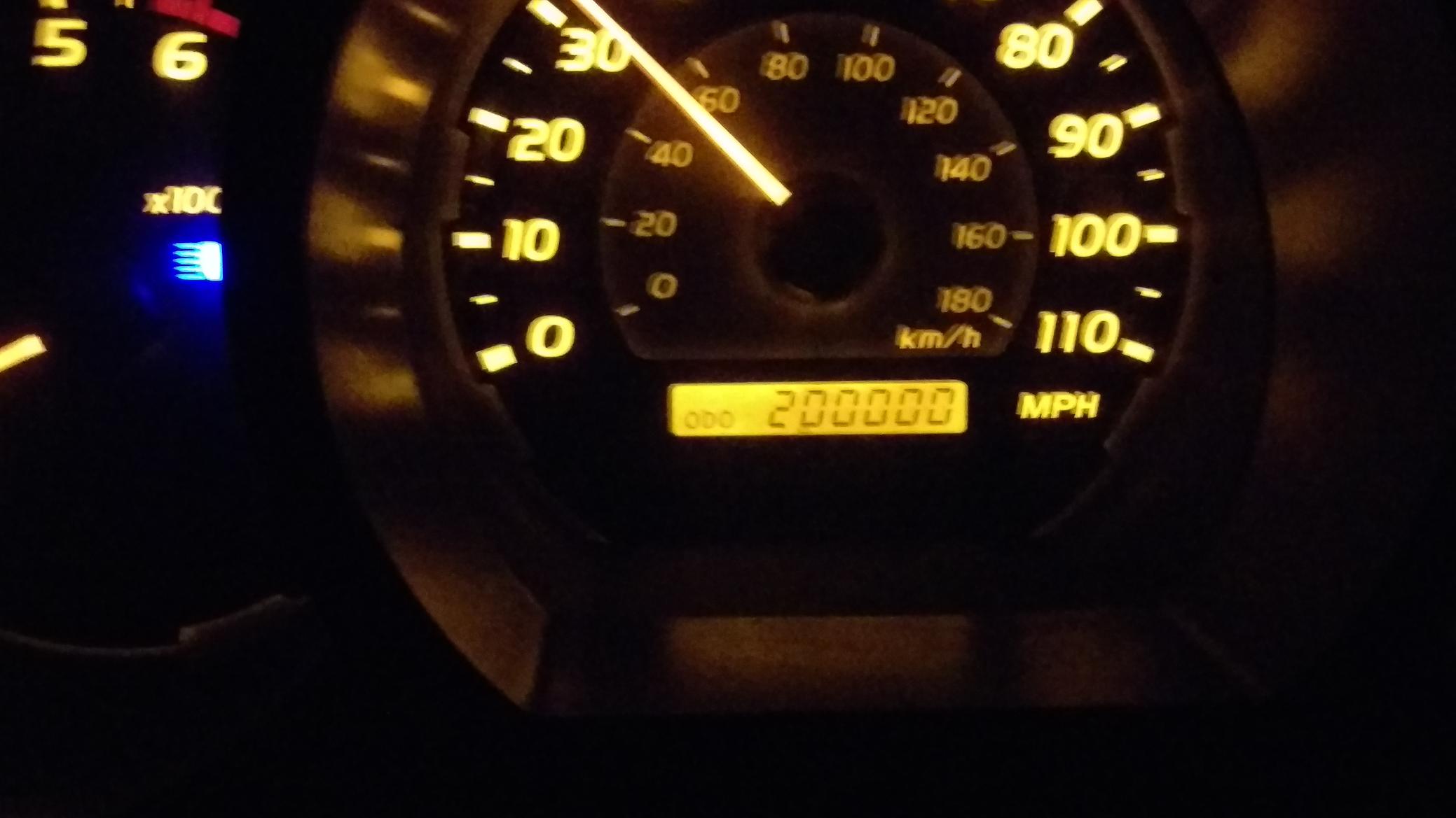

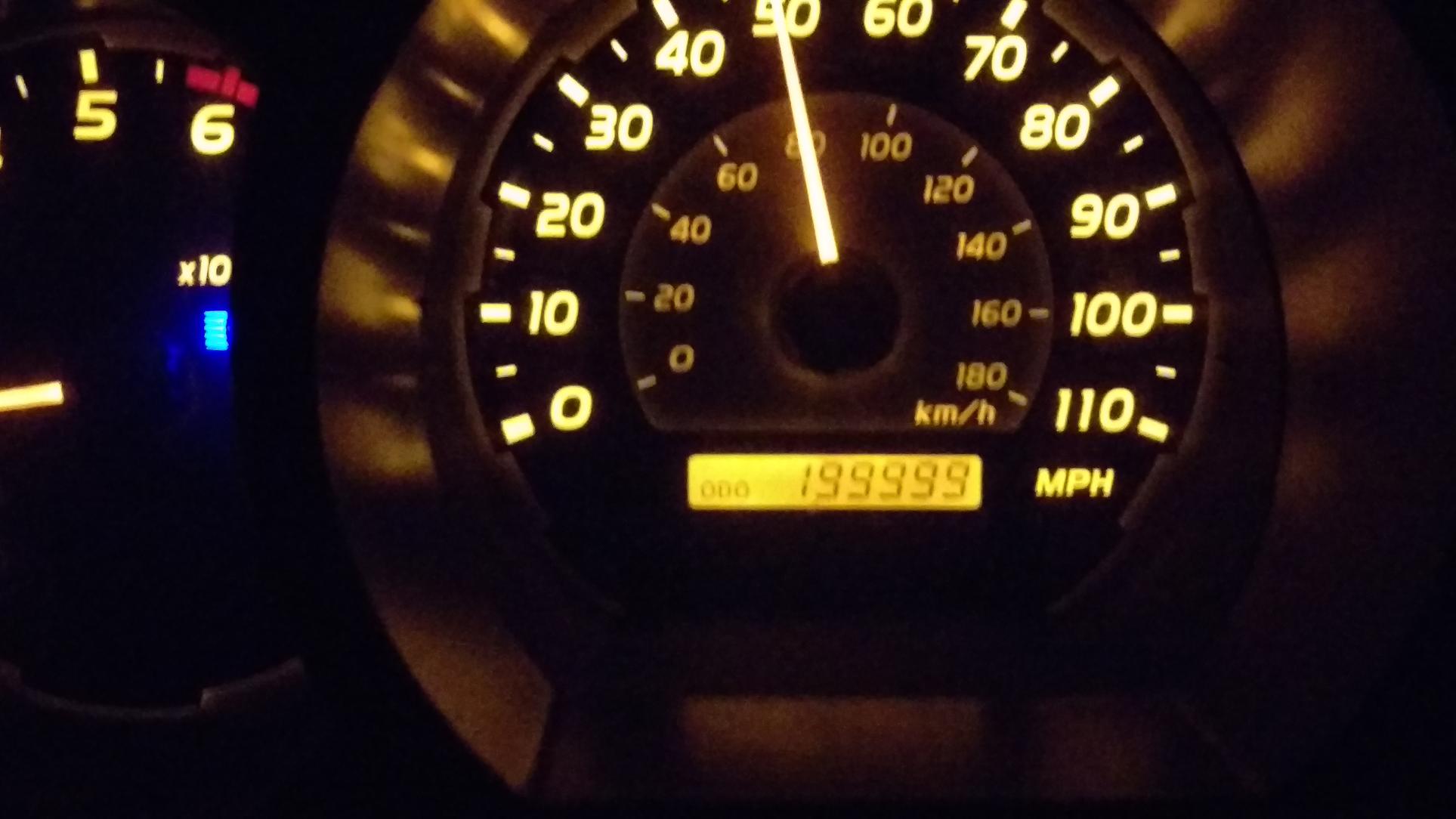

Rolled over 200k last night. uploadfromtaptalk1444876038748.jpguploadfromtaptalk1444876061025.jpg
When I went to replace my cv axle the other day I realized i had forgotten the key to my locking lug nuts on the good of my truck and it was long gone. So with some help we welded old lug nuts on them and was able to get them off. Replacing with some regular lug nuts. I also found my drivers side tie rod is shot which I do have a brand new part sitting in the garage. It came in the kit with my lca's. So I guess I'll be doing that soon too.
