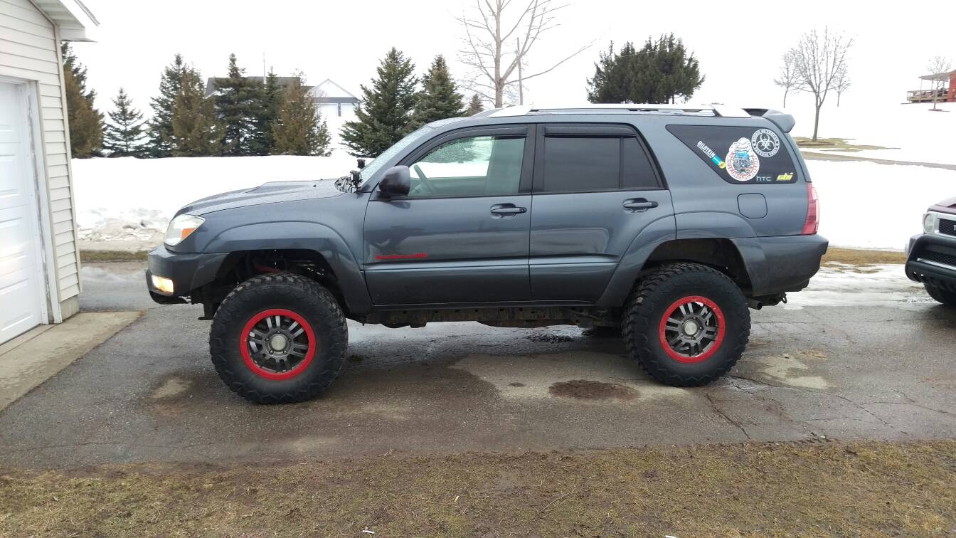

Well I need to aim my headlights now. Went for a drive last night and my headlights are really pointing up now! Unfortunately it was blowing sleet and there was no way I was aiming them! Lol
Front is so much higher, I can actually see traffic lights without craining my neck now! Looks pretty level even though the front is about an inch lower. Ride is fantastic now, no more tire rub, I can see better, it doesn't lean in corners anymore, and I am very happy with it!
Dude...your T4r looks sick!!!
My front is 1 1/2 lower (center of wheel to bottom of fender, but frame is dead nuts level!!) than rear. You look pretty level too IMO. The space inside wheel wells is deceiving.
I'm 1" lower in the front but I really like it! The ride is amazing how to!

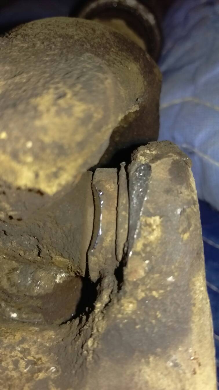

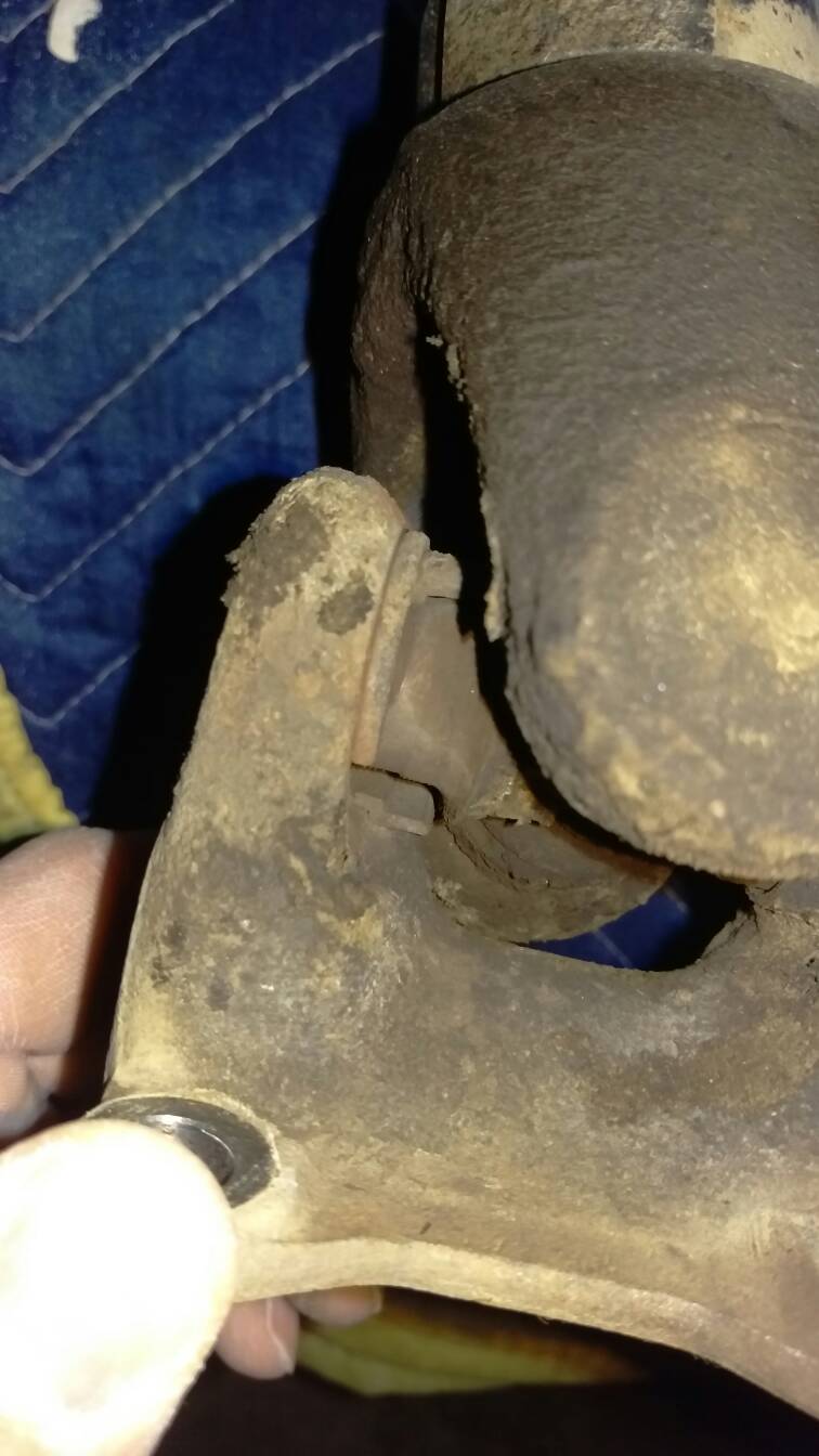

Pulled my front driveshaft due to a bad u joint. It's toast! I'm surprised it didn't fall out its so loose... Having fun with 2wd though!
You can see it was actually starting to rub there was so much play.
