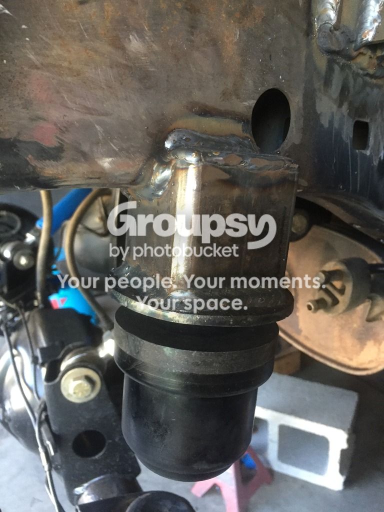

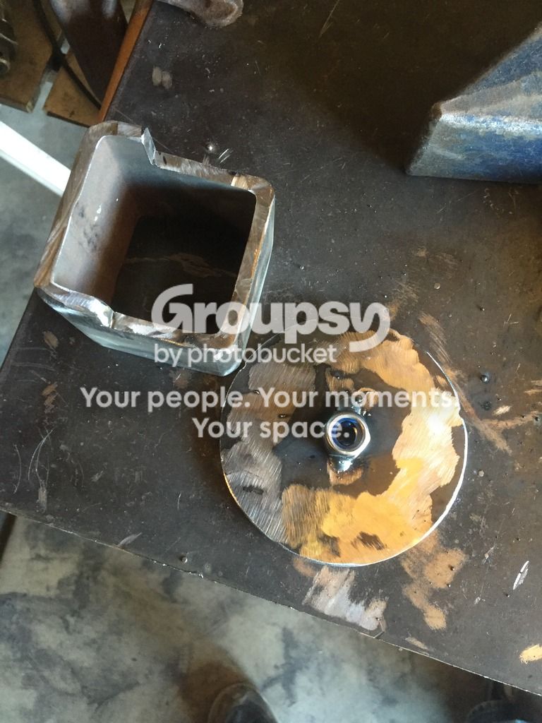

To mount superbumps in the back you are going to need to do some custom work. Here is how I did mine.
IMG_1404_zpsydqyclfr.jpg~original
Looks good! I was thinking of getting the rear Tacoma ones and welding them on.
That would certainly work, you are paying quite a bit for their piece of metal though and if you have the welder and fab skills, making your own is not much more work. I would try to mount them as far out board as possible instead of just mounting them under the frame to have them engage as late as possible in articulation, which is what I did with mine. I haven't had a chance to beat on mine yet, but they are certainly going to be a great improvement over the stock bumps.
