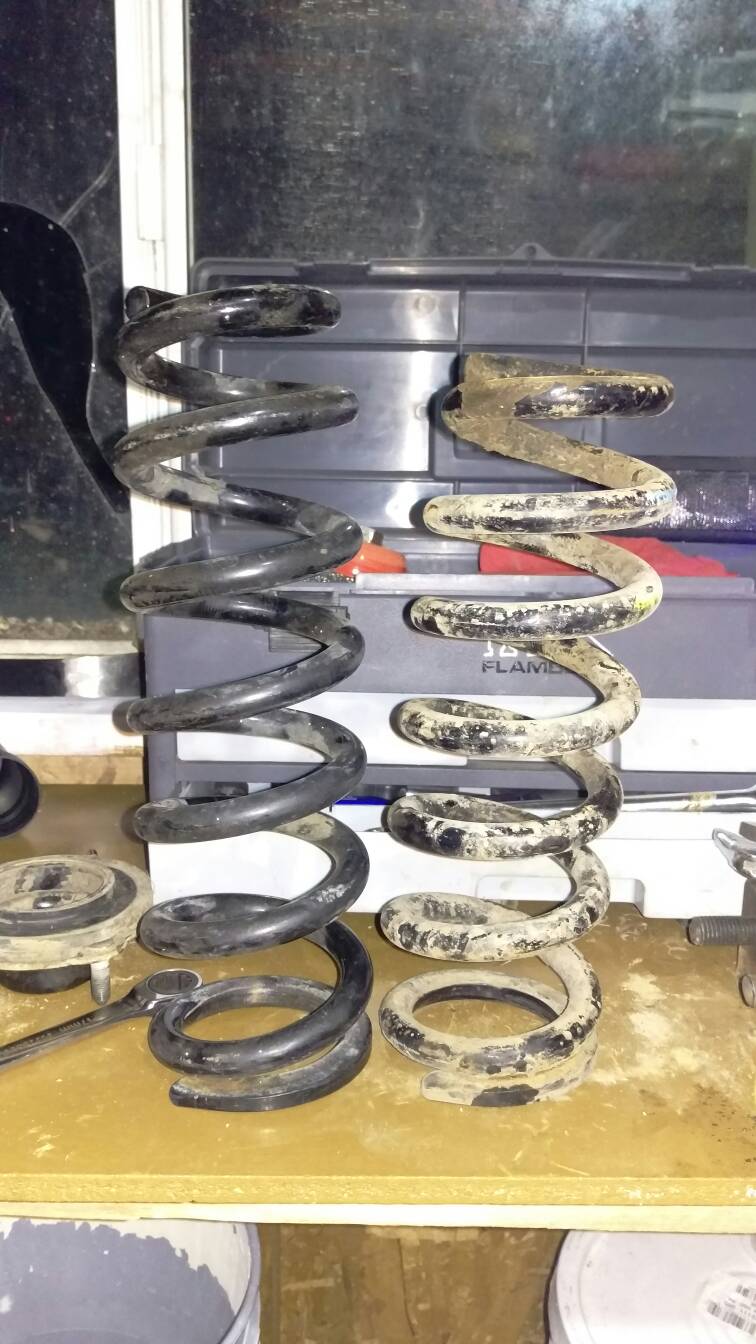

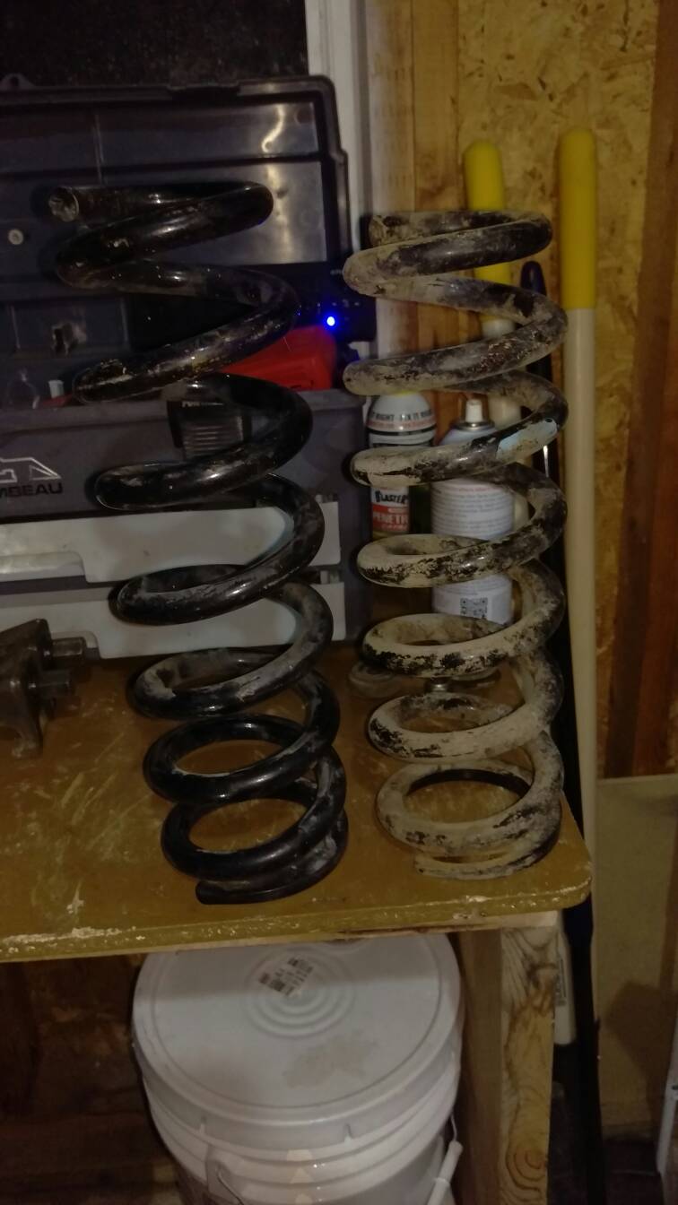

New springs going on! Tacoma TRD coils. Drivers side comparison to stock coil.

Not sure on year, but 05+ Tacoma coils will fit ours. They provide 1-1.5" of lift and are a slightly heavier spring. There is a thread on Tacoma spring swap if you search it. There are 2 kinds of Tacoma coils. Progressive and linear. These are the regular, linear coils.

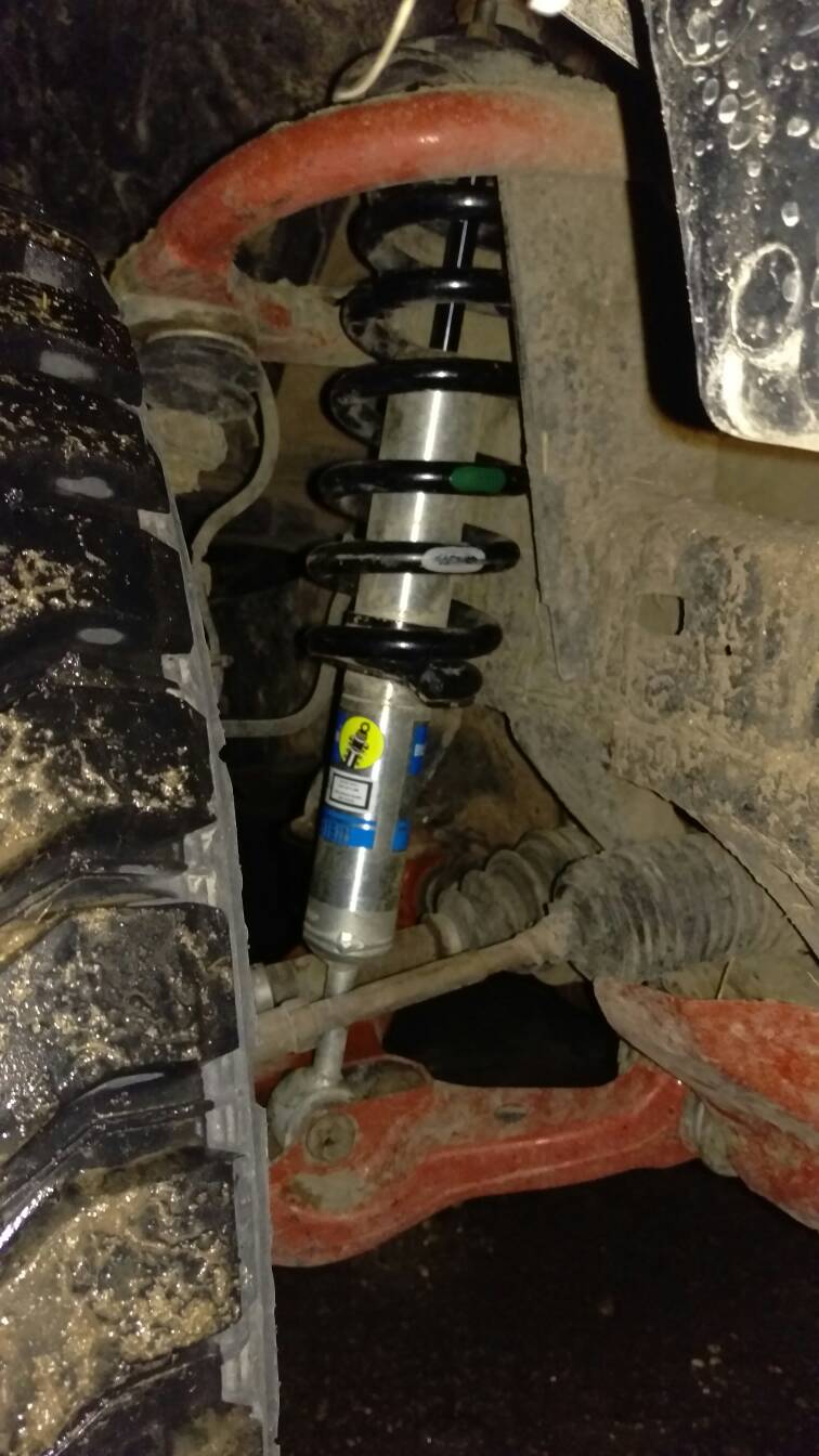

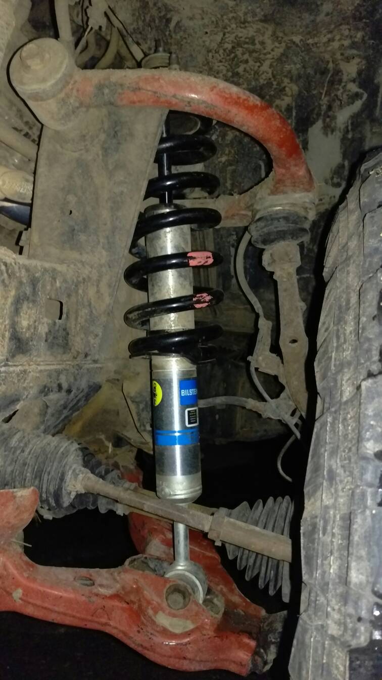

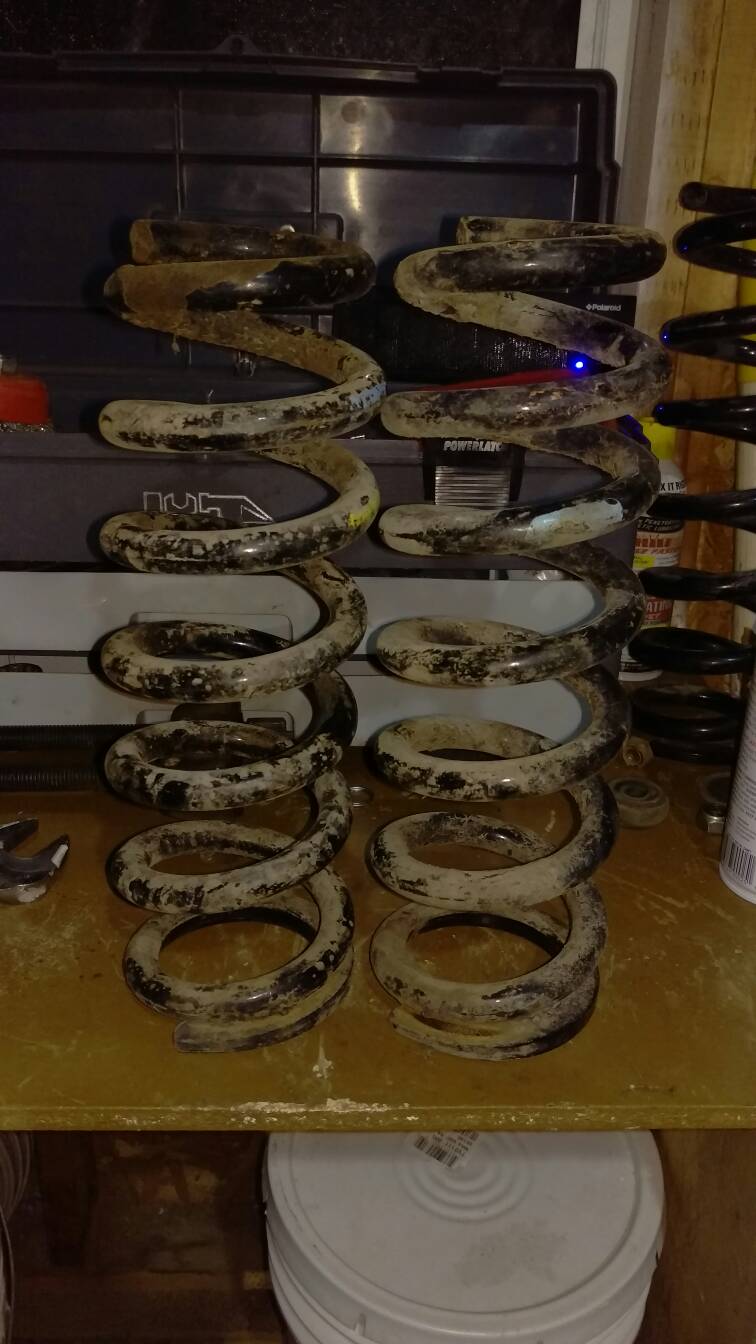

Ok, new coils are in and I gained almost 2"! Man my stock coils were shot!

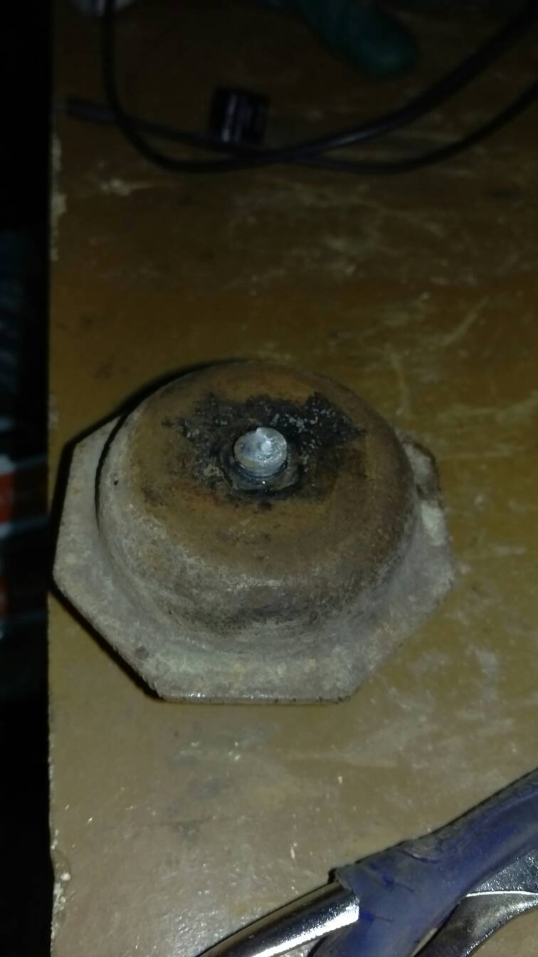

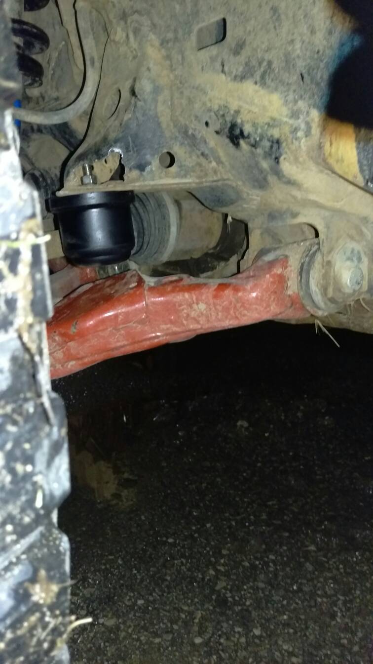

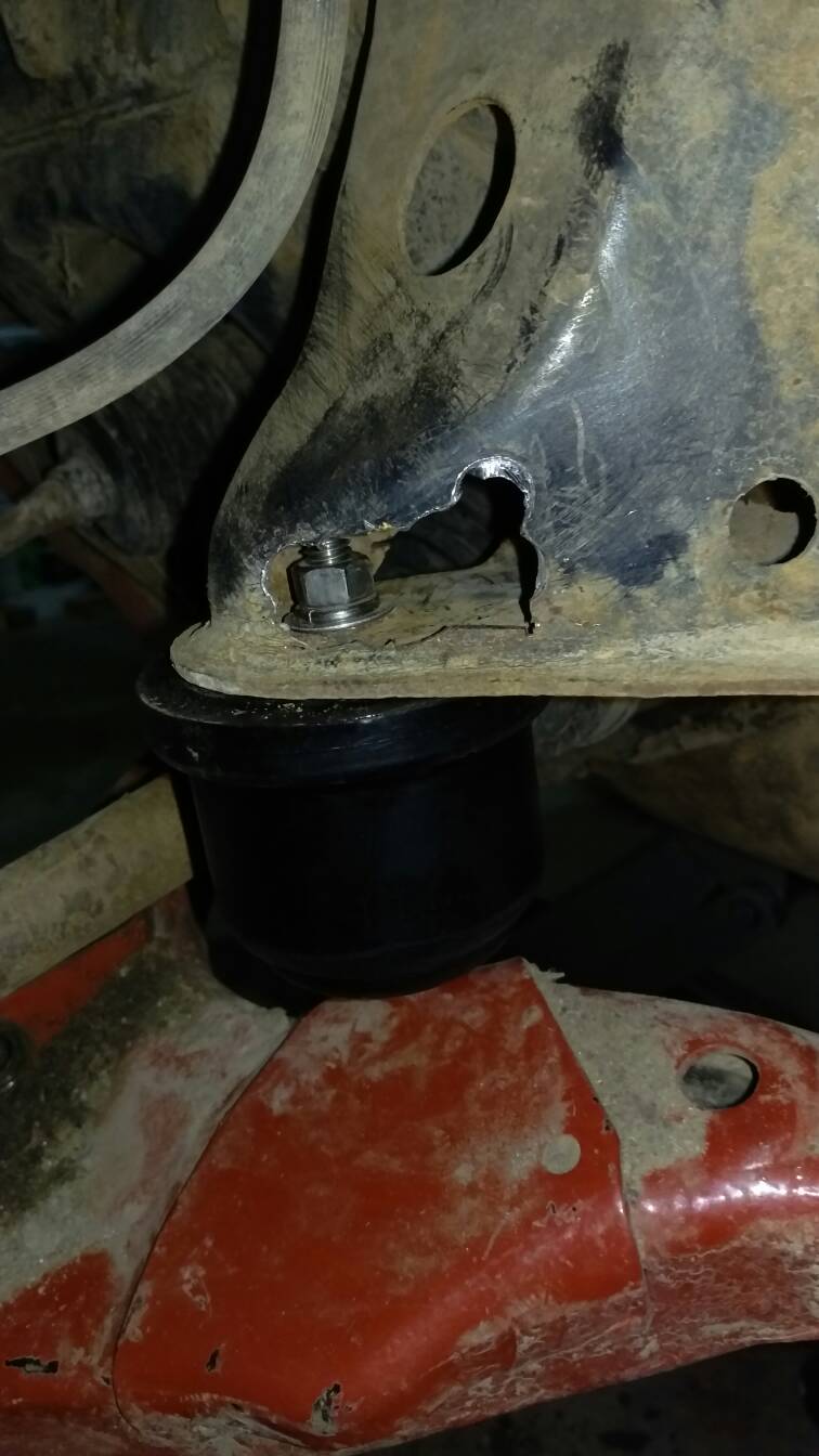

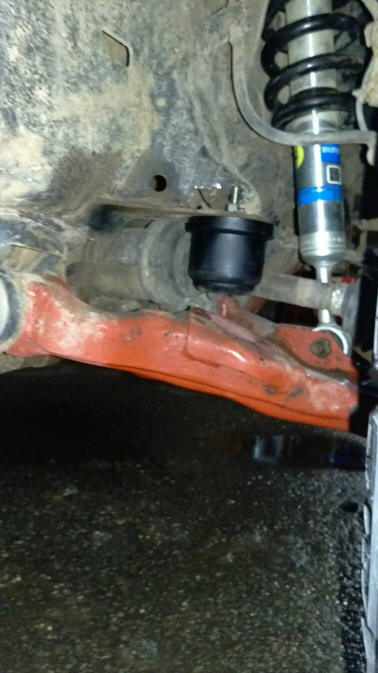

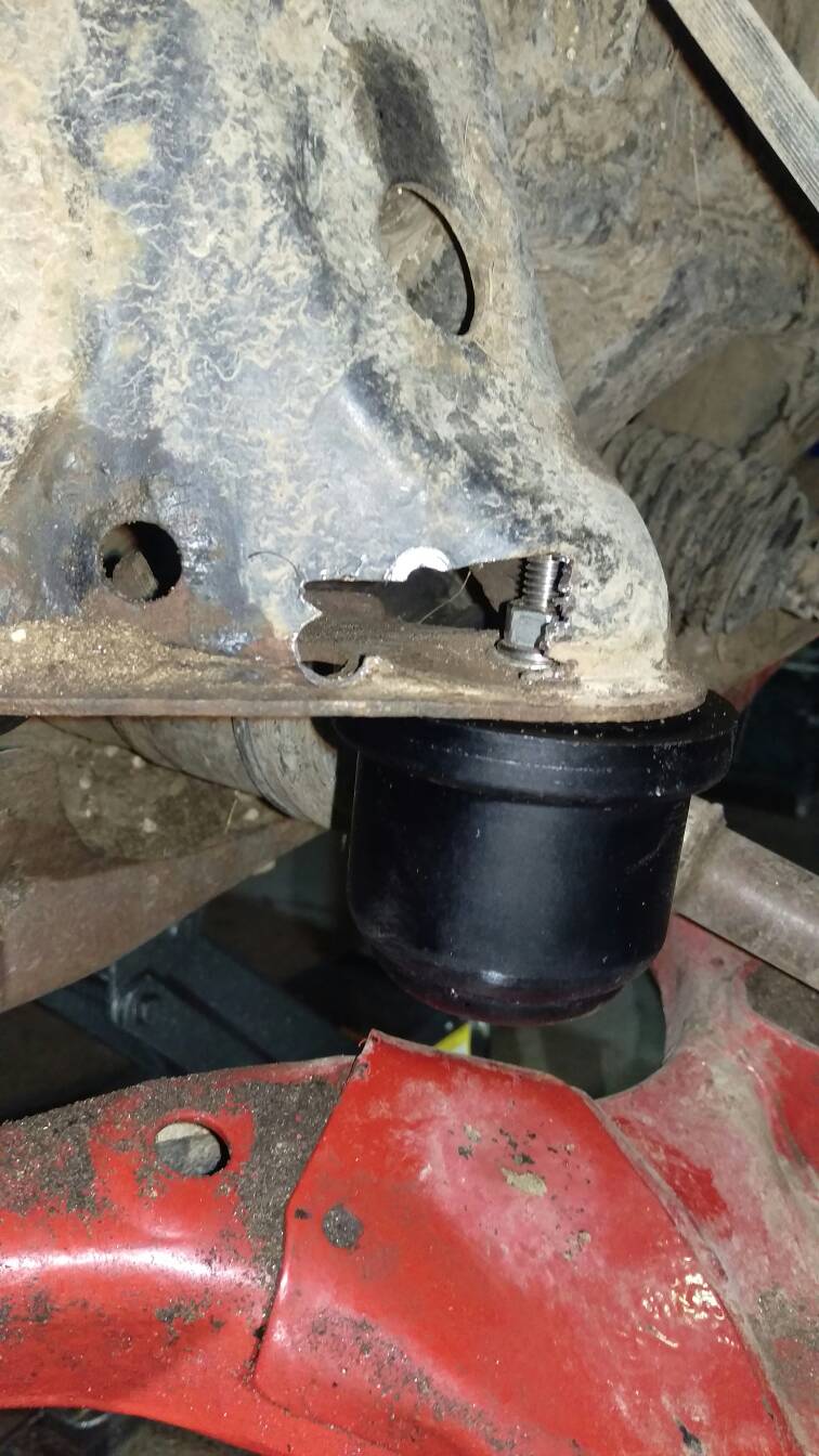

Also managed to get my superbumps in! Old bumpstops twisted off... So I had to make a hole, cut the welded nut with a Sawzall, use a cold chisel and pop that old welded nut out, then I used shiny stainless steel bolts, washers, lock washers and nuts to install them. Shouldn't go anywhere!

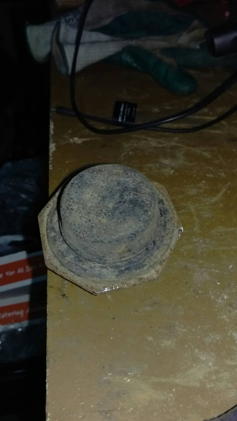

and here's what the old bumpstops look like. Hard a steel I might add....

Went for a short ride last night at 11pm to feel how the new coils are. No more lean, no more bouncing on bumps, very controlled and responsive feeling. Will test more hopefully today. :rockon:

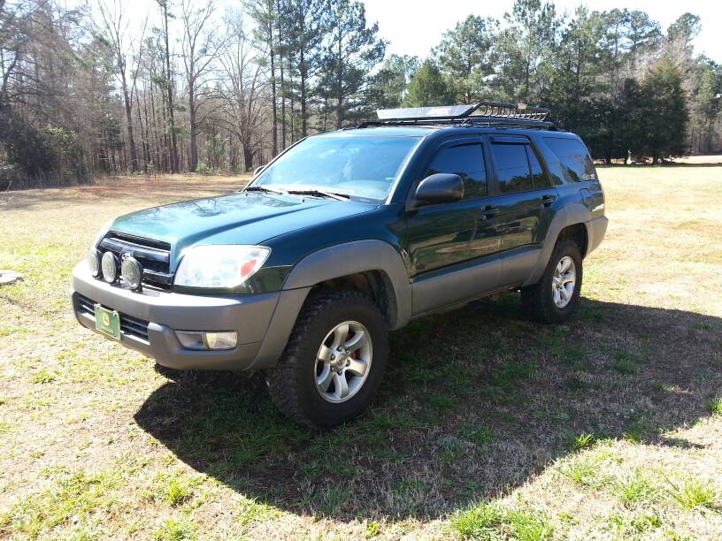

Front is so much higher, I can actually see traffic lights without craining my neck now! Looks pretty level even though the front is about an inch lower. Ride is fantastic now, no more tire rub, I can see better, it doesn't lean in corners anymore, and I am very happy with it!
Well I need to aim my headlights now. Went for a drive last night and my headlights are really pointing up now! Unfortunately it was blowing sleet and there was no way I was aiming them! Lol
