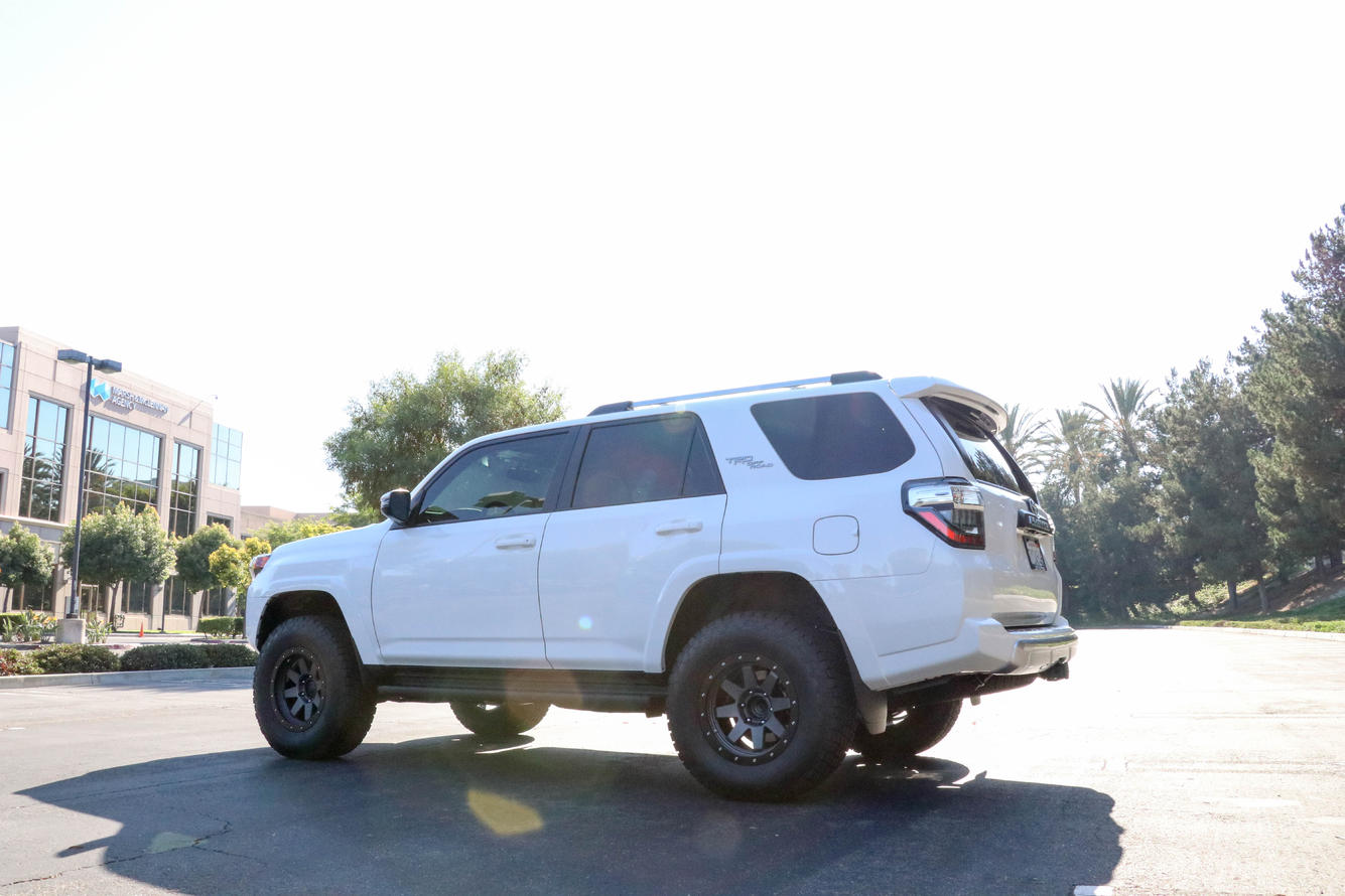

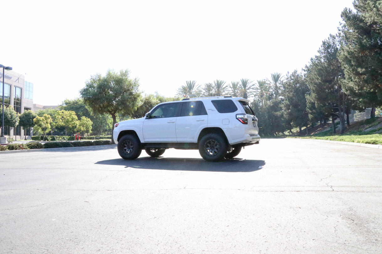

Side shot of the stance after 1300 miles. I have some stuff in the back that weighs about 50lbs and I am parked on a very slight incline.
Very happy with the ride.

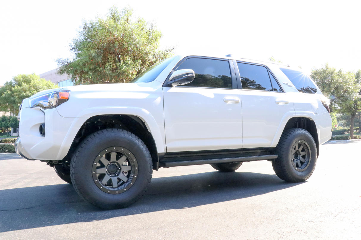

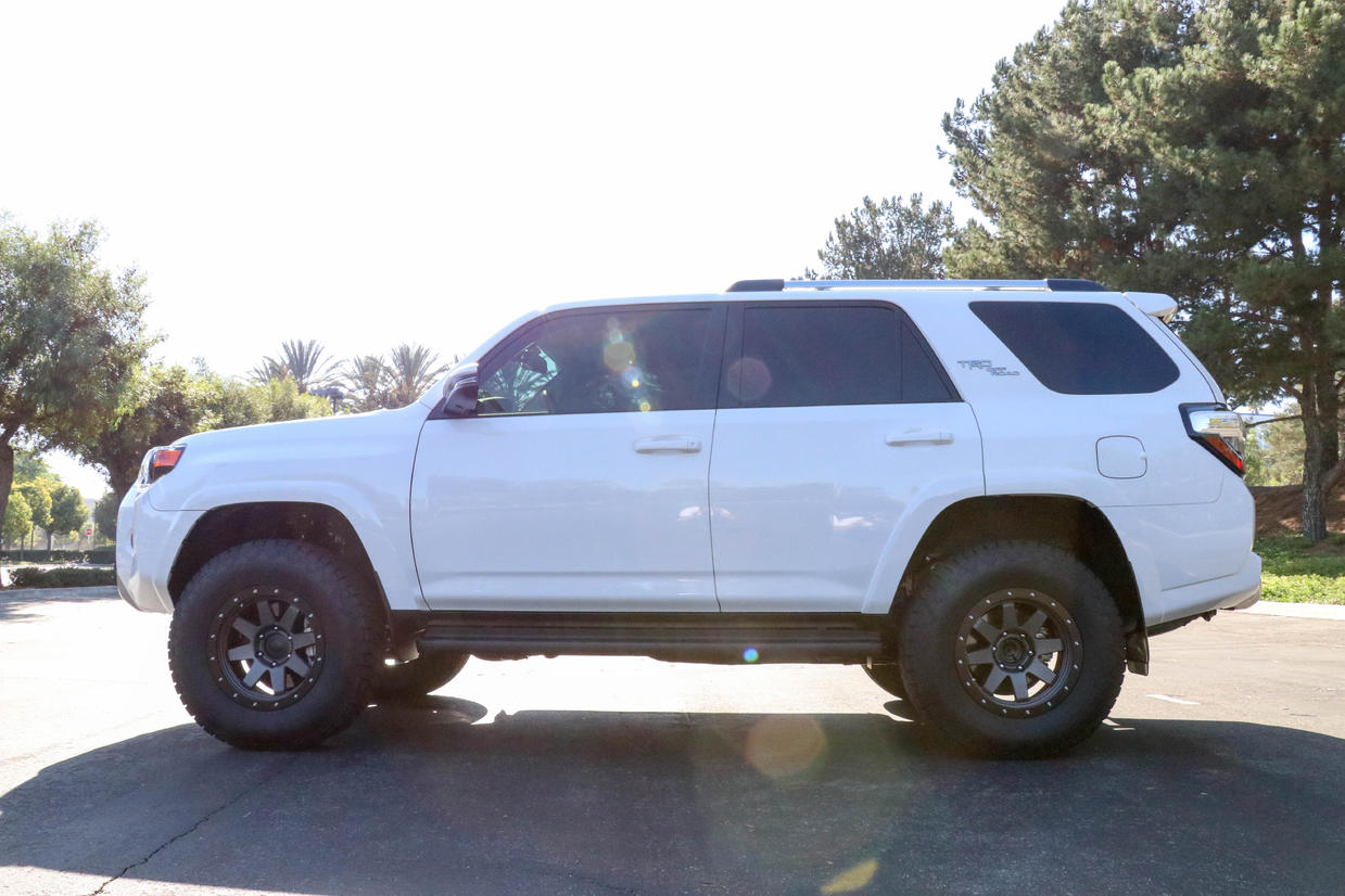

Here are some photos of the 6112/5160 with T13 Rear Coil.
6112 is set at the 6th notch (2nd from the top) on both sides.
