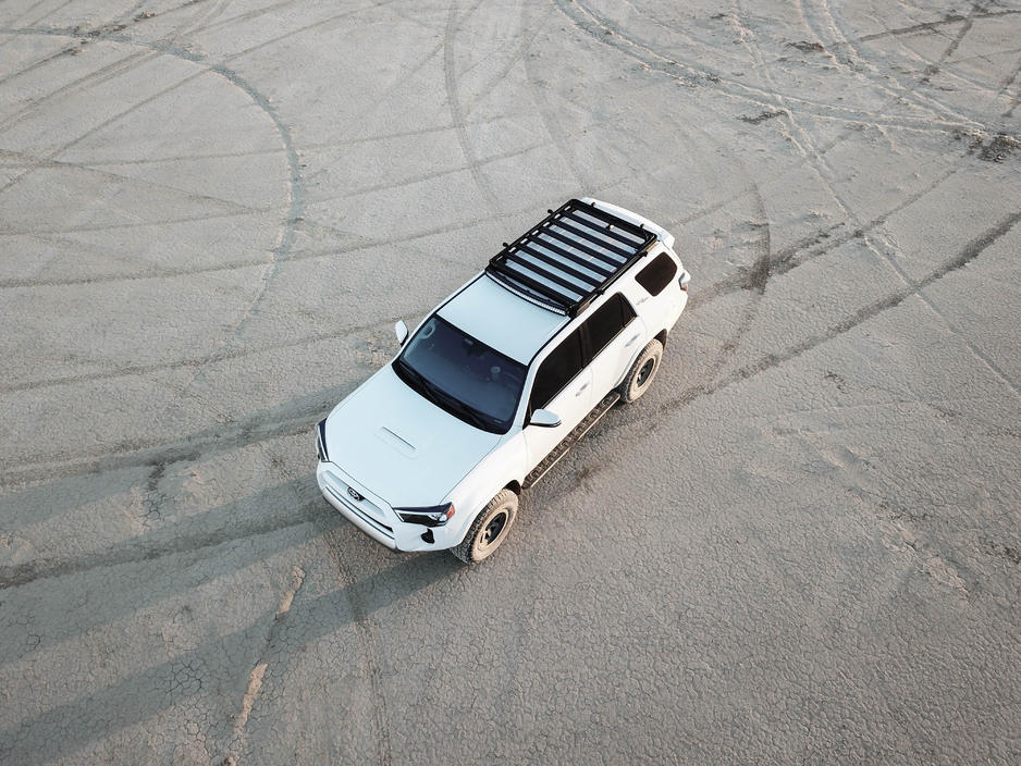

1. Front Runner Roof Rack
This was a fun one, I originally ordered the 1255mm x 1560mm Slimline II Tray without the mounting legs. I did this because I wanted to try and mount the tray to the factory roof rack. I understand the load carrying is reduced by not utilizing the Front Runner Legs, but I was ok with that. Once I got the rack I realized this wasn't the look I was going for. The pictures I had been going off were of a 4th Gen 4Runner. I wanted the rack to follow the lines of the factory rails. Because Front Runner has the best customer service I've ever dealt with, I was able to swap the tray for the 4th Gen Tray which is narrower, 1165mm x 1560mm. This was perfect and the exact look I was going for. Happy.
How I mounted the rack to the factory rails: If you visit 8020.net, they make an endless supply of brackets and mounting hardware for t-slotted aluminum framing extrusions. So I am using a corner bracket from them, along with some large t-slot nuts that fit perfectly in the factory rails. I will post photos when the rack is back on the truck.
Oh, and my sharkfin got a flat top hair cut.

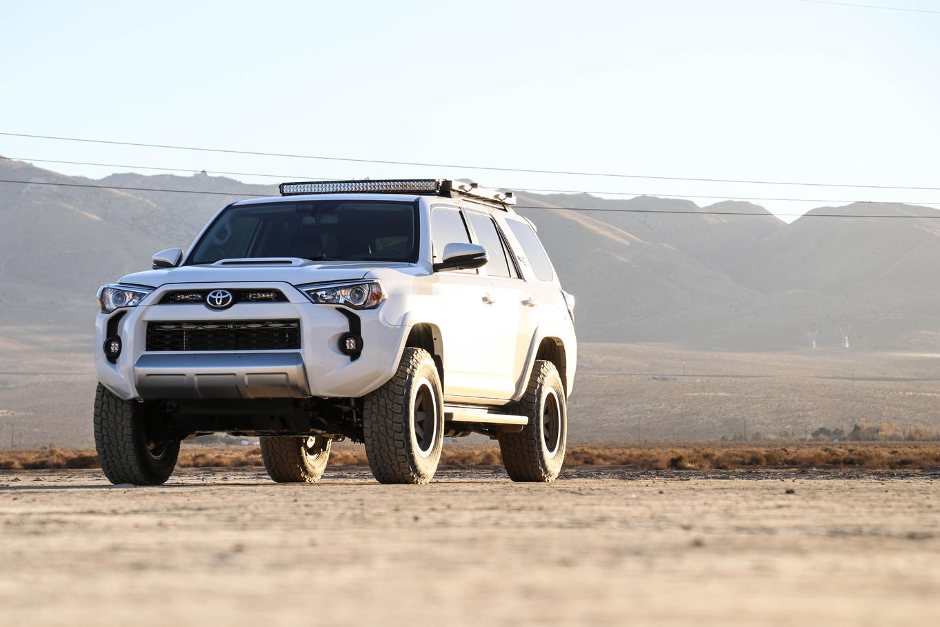

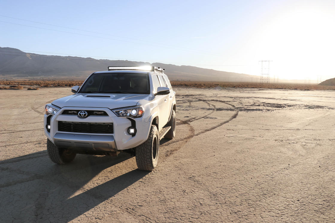

2. Lights: I love lights. Too much.
I added a pair of Rigid SRM's to existing bolts on the trailer hitch. I wired these into the "trigger" switch on the Switch-Pros panel. This allows the lights to come on when in reverse, and allows me to turn them on by pushing the switch.
I also added a pair of 6" Rigid SR-Series PRO lights behind the upper grille. I built up the framing using extrusions from 8020.net.
Right now I am finishing up wiring for the roof rack which will have a 40" RDS Light Bar and (6) Rigid Ignite lights (2 Left, 2 Rear, 2 Right).
For the roof rack wiring, I decided to run the wires through the roof at one of the factory roof rack mounts. Drilling was required and was the scariest thing I've done. Added a Deutsch connector to the end which will be hidden when the rack is on.

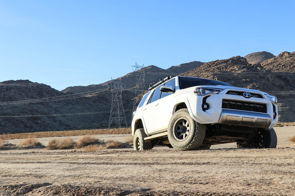

So I went on quite the suspension venture with this one. This 4Runner really tested my knowledge. Being a stubborn *******, I dismissed the advice of those who know there stuff (aka Scott @ Camburg). So below, I am going to share my experience so others dont have to spend 5 or 6 weekends in a row swapping shocks and springs. I've gotten my time down to 1.5 hours to swap front shocks and springs, including spring compression. Level: Master Builder.
I decided against coilovers because this thing is a pavement princess and will only see dirt 1% of the time. And when it does see dirt, I am not trying to keep up with a trophy truck through 3 foot holes where I have to worry about shock fade ect. I really question those who claim they are experiencing shock fade, because it takes a lot of speed for an extended period to get shocks hot enough to fade. Dont get me wrong though, coilovers out of the box are the best solution for these trucks, just a whole lot of overkill. I ran the first set of Fox Extended Length Resi Coilovers with an Upper Arm on a 2010 Tundra and they thing was like a boat on the morning glass.
1.
Front: Dobinsons 302 Coil / 700 Strut
Rear: Dobinsons 723 / Stock Shock
Lift Gains: 2.75"+ Front / 2.25"+ Rear (The rear sat about 1.5" higher than the front, measuring hub to fender)
The stuff from Dobinsons is heavy-duty. There coils have a few extra turns than most other products on the market. The wire is 17mm, and you can tell. The springs are heavy. I have no doubt in my mind that these would hold up over a very long time. If you beat the S out of your rig, you may want to give there stuff a shot. Especially the guys hauling a ton of extra weight. The on road feel was solid, not as comfortable as I had hoped for, but it definitely handled like a sports car. Low speed "sharp" bumps were a little rough, which is understandable considering how burly these springs are.
1A.
Rear: Dobinsons 599 / Stock Shock
Lift Gains: 2.75"+ Front / 1.5"+ Rear (The rear sat about .5" higher than the front, measuring hub to fender)
I swapped the rear 723 Springs for the 599 Springs. Gave me a very even lift.

More detail shots of the rack.
I am going to install a pair of heims and threaded rod to the second hole on the light bar for more rigidity.
The surprising part, even at 80 mph, there is NO noise from the rack, and I don't even have the Front Runner diffusers on.
Install took twice as long because I under sized my wire gauge for the light bar and had to run new wires. Used some Marine Grade 12 AWG, and surprisingly didn't get much voltage drop over nearly 24ft of wire. (Wires run towards the back, drop down near the rear hatch, then run under the truck to the front)

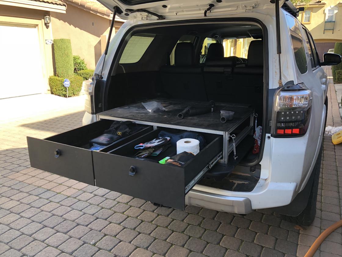

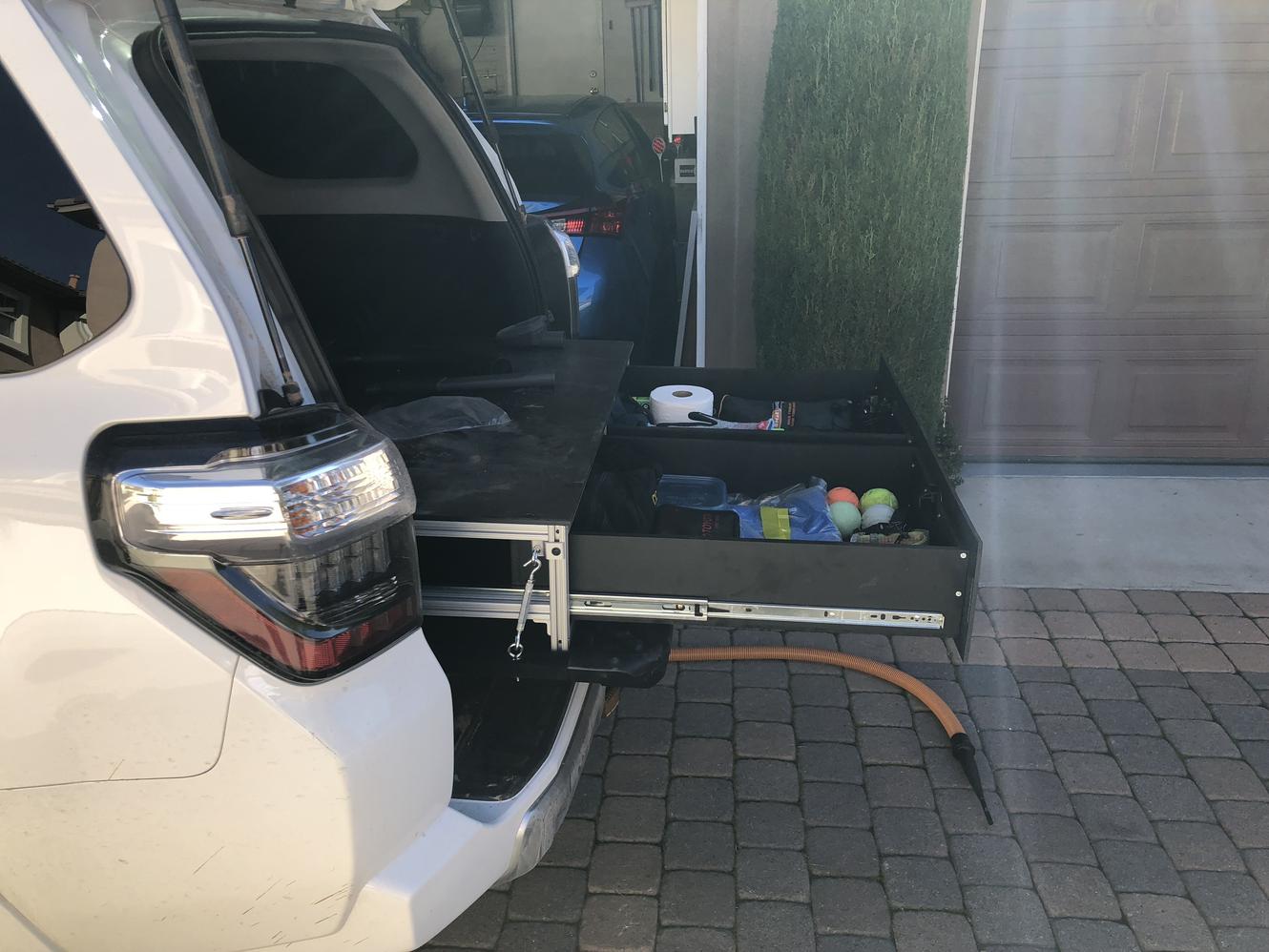

Built a drawer system from scratch using t-slotted framing and a HDPE plastic. It is mounted to the rear sliding tray. Came out way better than expected.
