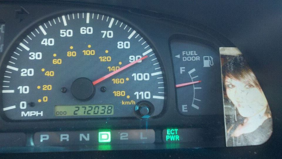

Wow that is pretty impressive! Is that still your original trans?
yeah...i have had the transmission flushed when i first bought it about 80k ago. Probably need to do it again soon...but yeah still the original trans...i think everything on this 4Runner was ORIGINAL! when i bought it. The ppl that owned it before me abused the hell outta it. Needless to say it was held together buy rustwelds and Toyota LUCK!

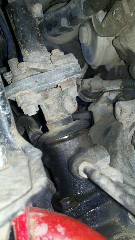

well as some of you know i have been putting alot of cash and work into my 4Runner lately. I Have ran into some issues but not too bad, thought i had everything fixed and was good to go! Ya right...so a few days ago i was looking around under my runner after going on a few trails and noticed my steering rack has a leak, not in the steering rack & pinion (idg) but the box on the top that connects to the steering wheel. So i went and picked up some Lucas, hoping it would give me time to buy a rack....
SO the good news is i went today and found a rack from a 99 toyota 4runner at a salvage yard for 100 bucks, the 4runner that the rack was pulled off of only had 80k on it!:naughty: Gonna check on a Elocker when i go to pick up the rack in the morning...hopefully i can get one on the cheap this dude seems to LOVE the fact i have "Veteran" tags! He talked my head off today, and i wasnt thinkin to ask about the locker was to pi$$ed about the rack! LOL..
Think what ticks me off the most is....i just had that dadburn rack off a couple weeks ago changing the bushings...fix one thing 2 others break! :wtf:
OHH and i went to the Stealership locally and all i got to say is WOW...them fers are crazy they want u to just bend over and take it in the :moon:!! wanted 600 for a RE-MANUFACTURED steering rack....needless to say i order my parts for the rear diff breather mod, and walked out of there quick!!

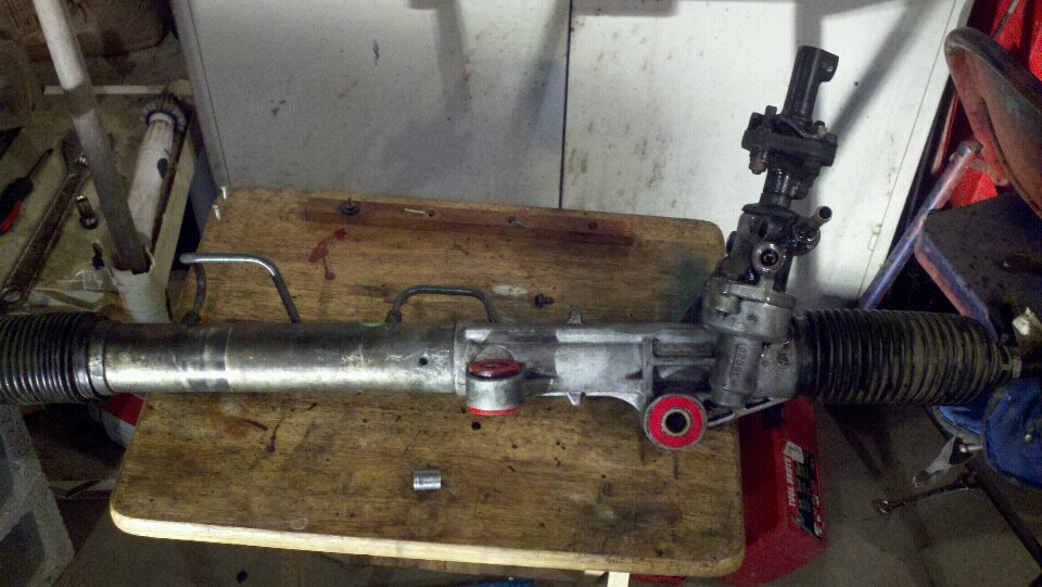

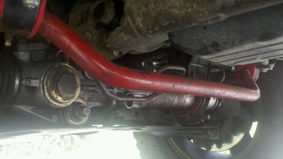

Steering rack installed.
well, this was not all that bad...ended up having to replace the high pressure hose as well, however i was lucky enough to find it for 25 bucks at a junkyard. I replaced the bushing in the new rack with the PolyPerformance ones i bought from Toytec all in all it wasn't that difficult for the first time ever doing this...
whats a build thread with no pics?....:toilet3: thats what!!!
So here is just a few...

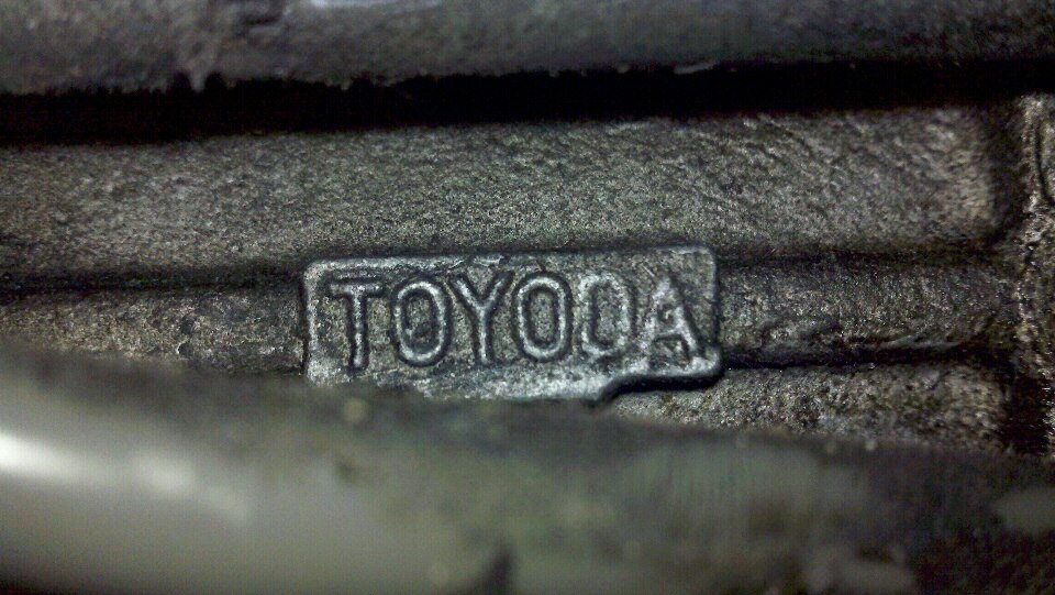

Here is the Toyoda OEM rack with Polyperformance bushing kit:
Just a lil bit of proof its "REAL"
Installed in my 4Runner....this was FUN...:jk:

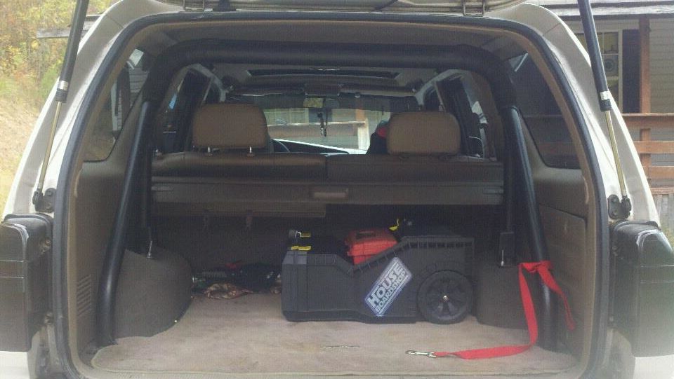

Here is a pic of my Rollbar that i installed a while back...with my small toolbox.

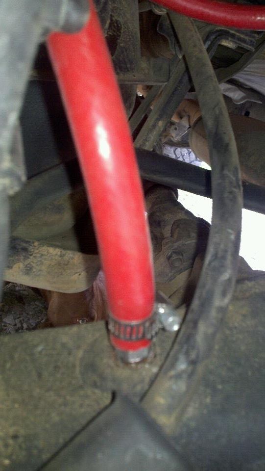

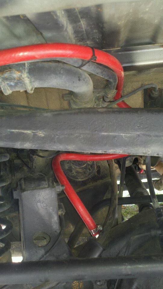

Rear Diff Breather Mod.

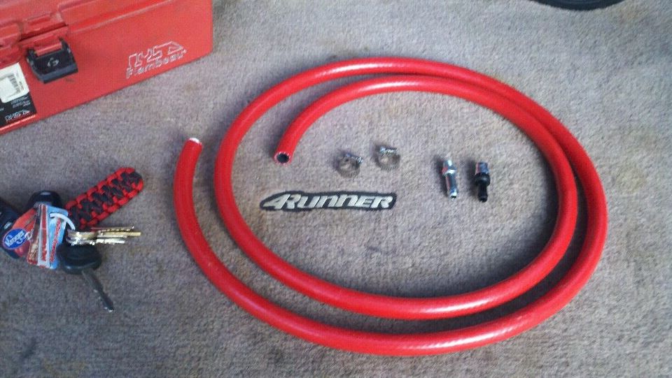

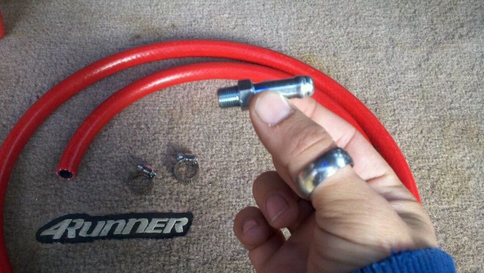

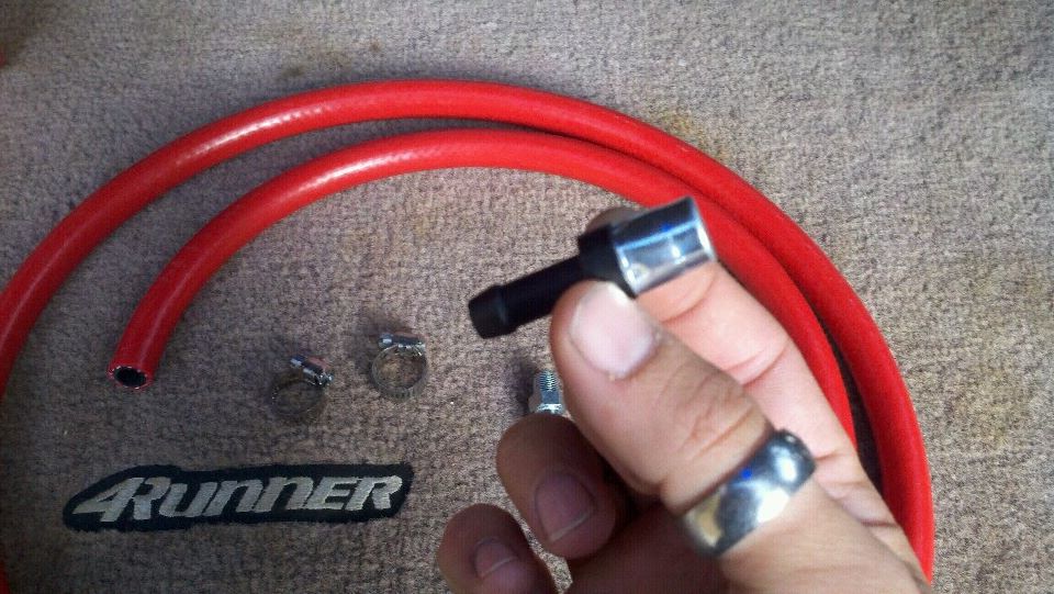

So i have been meaning to do this for quiet sometime! i am finally getting around to doing it. i went and gathered up everything i need to do my rear diff breather mod.
Parts
Toyota Union Fitting- #90404-51319
Toyota Breather Plug- # 90930-03136
6 Ft of Red air hose (my lil twist)
2 hose clamps
here is a few pics of the stuff i bought:

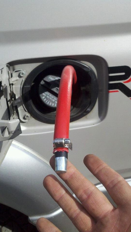

Rear Diff Breather Mod completed

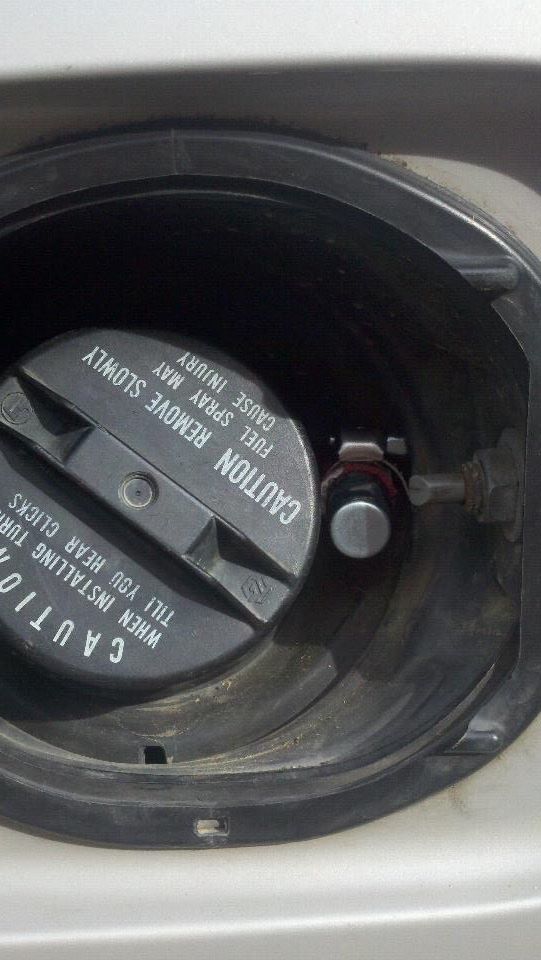

Rear diff breather:
Diff breather beside gas cap...(like everyone else does)
I used zip ties to secure the airline, left plenty extra airline for flexin' decided to throw my own lil style to it and find a "red" airline...
The reason this is done....
