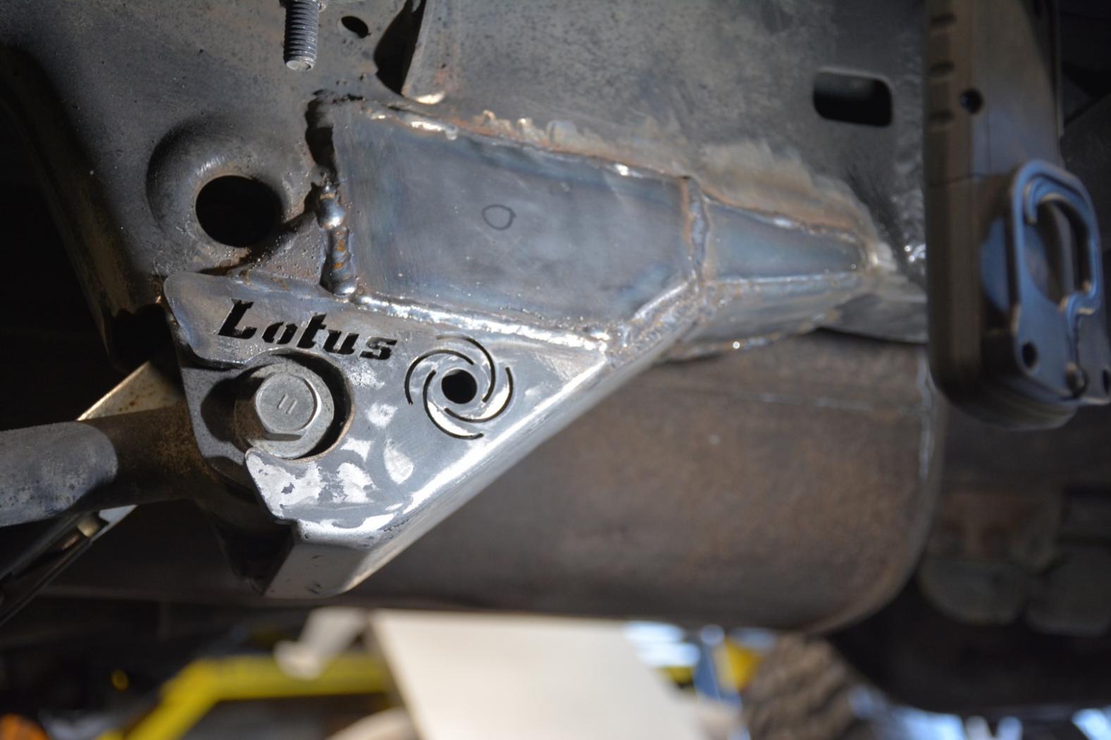

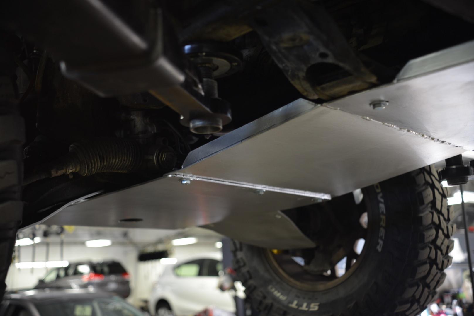

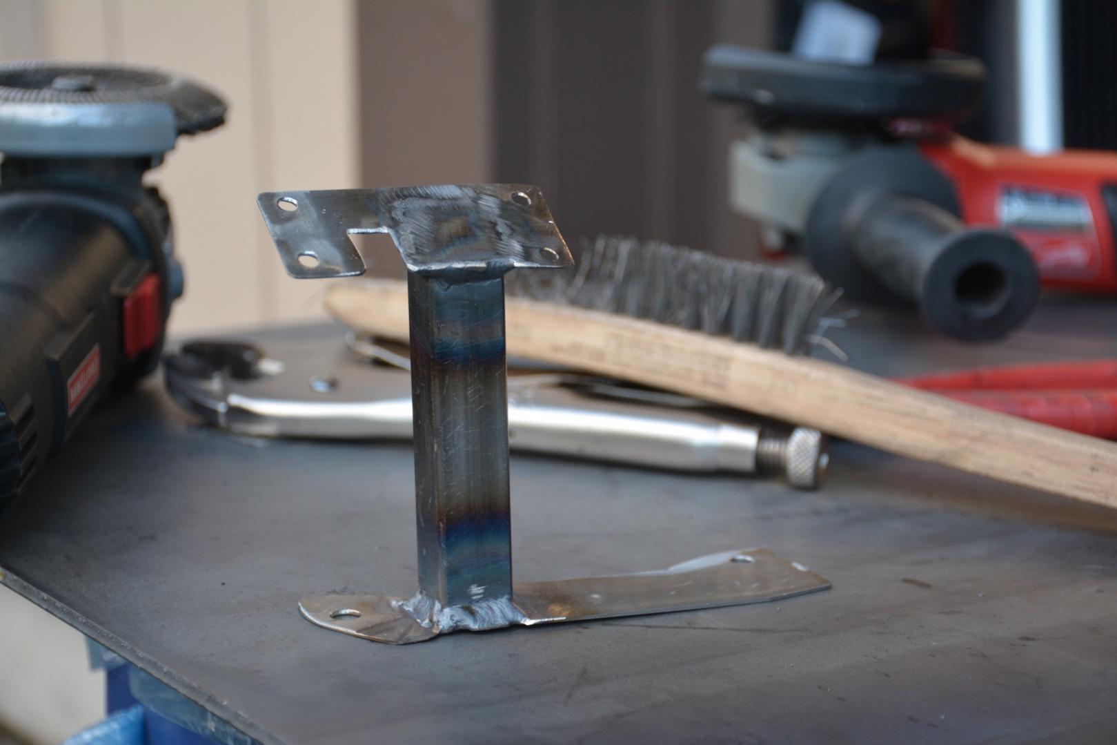

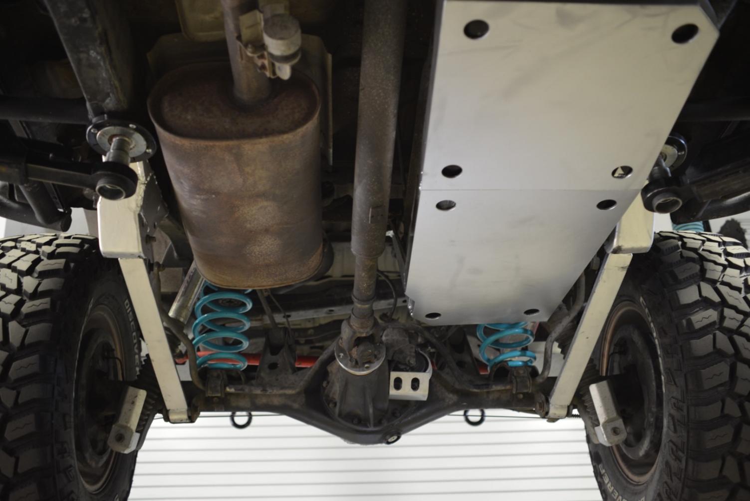

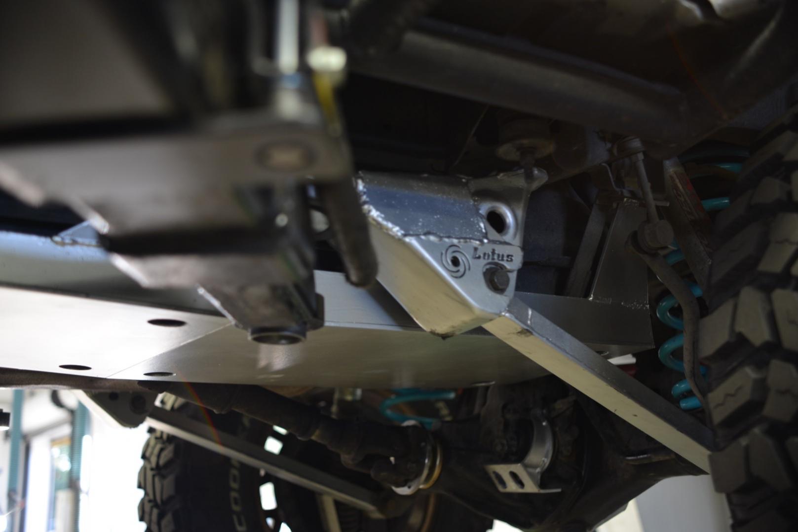

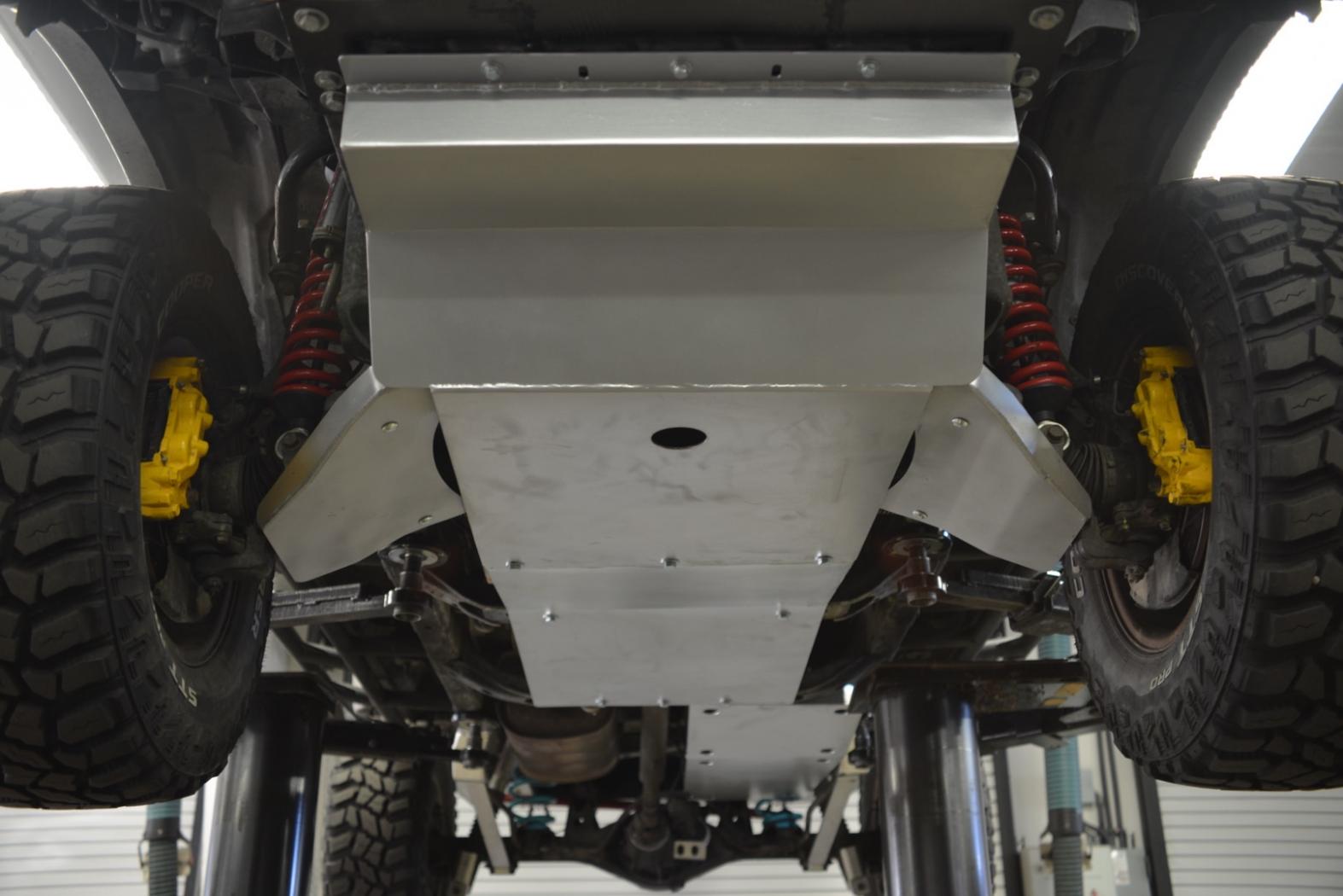

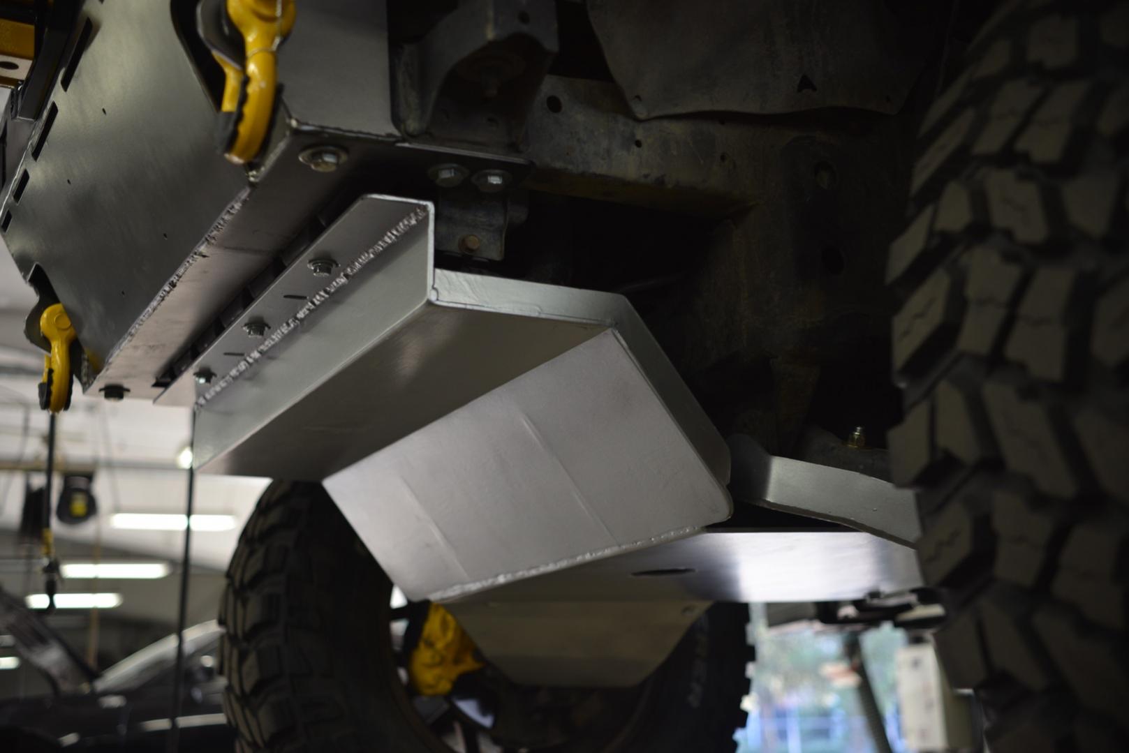

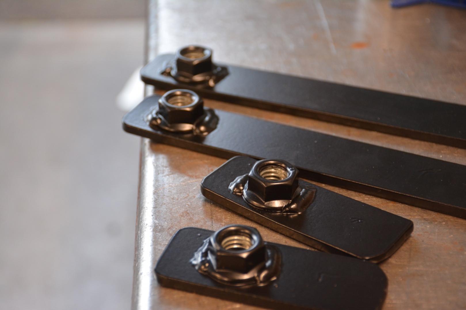

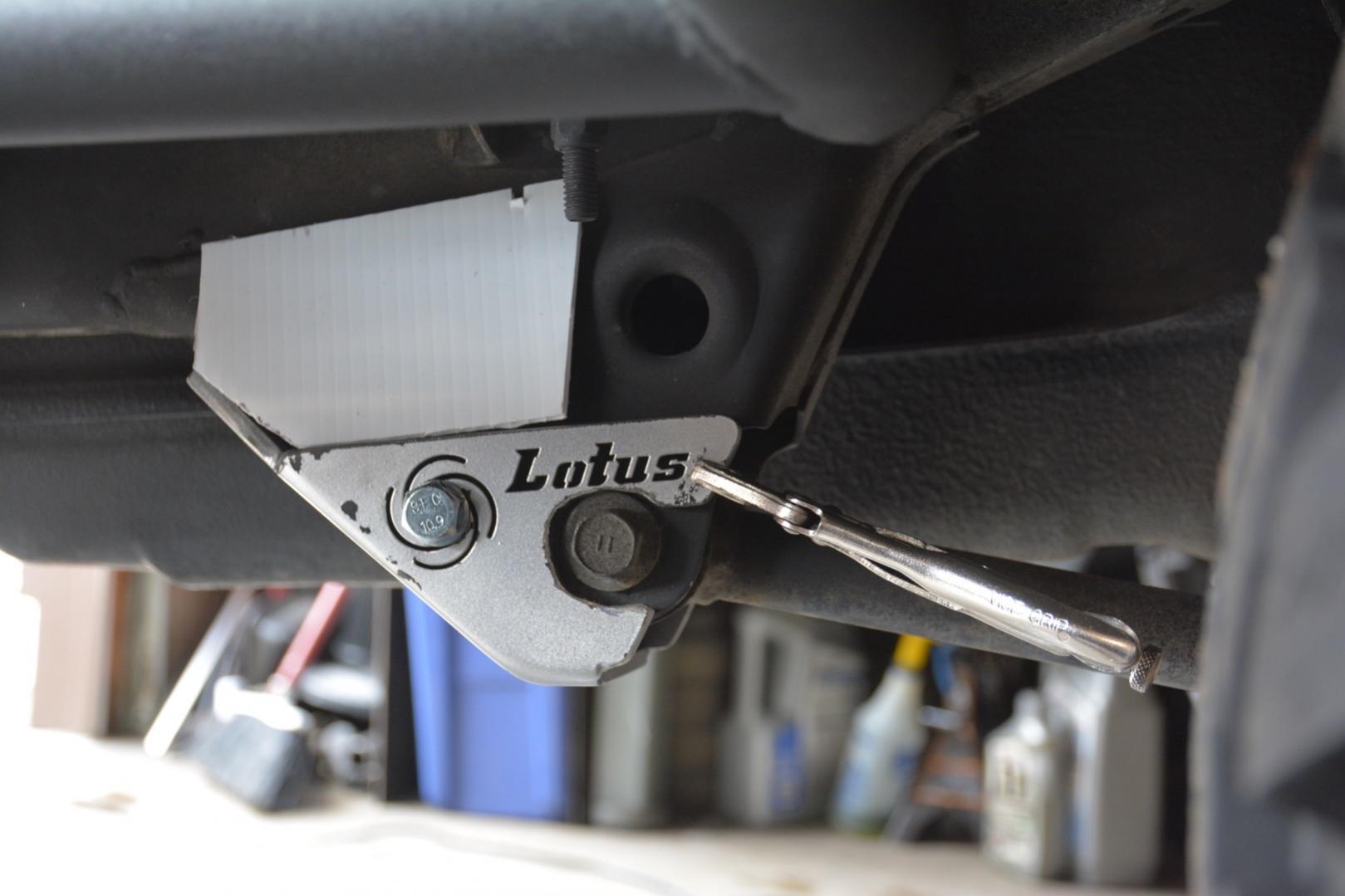

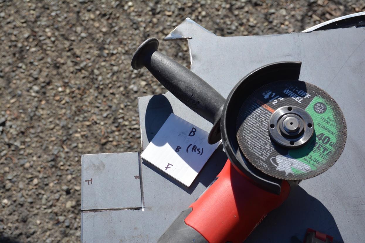

Went to install my Lotus lower link skid and realized there was one flaw... if enough impact was put on that section of the skid, it would still crumple the oem attachment... so I went ahead and started making pieces to fully box that area of the vehicle (it happens to be one of the most contact points going over rocks/tree roots)

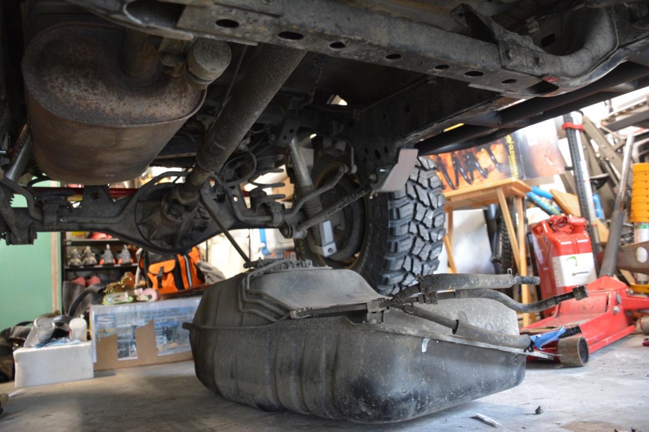

It was a lot more work than expected being I had to remove my gas tank (new OEM fuel pump/filter at the same time) to finish up welding and painting on the driver side

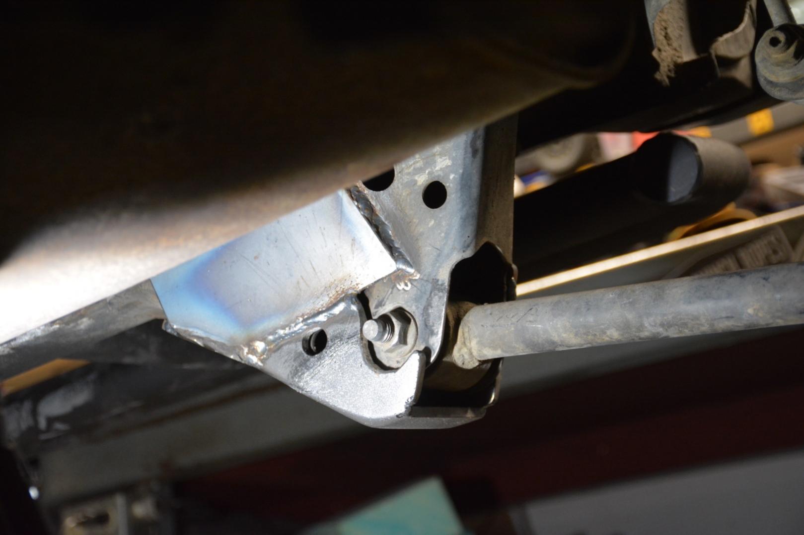

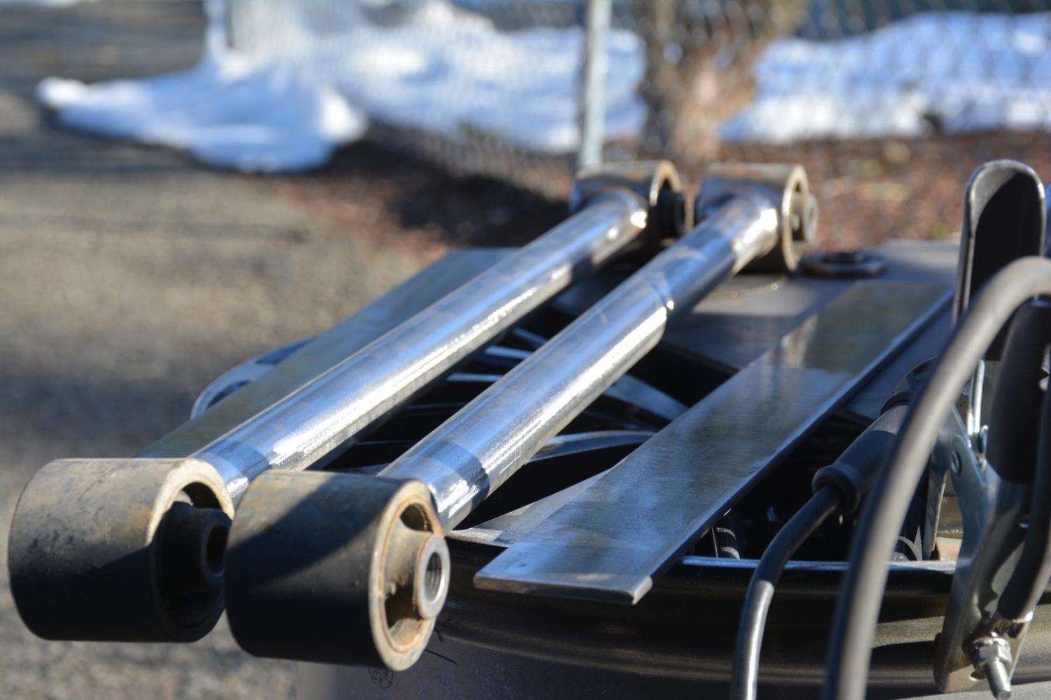

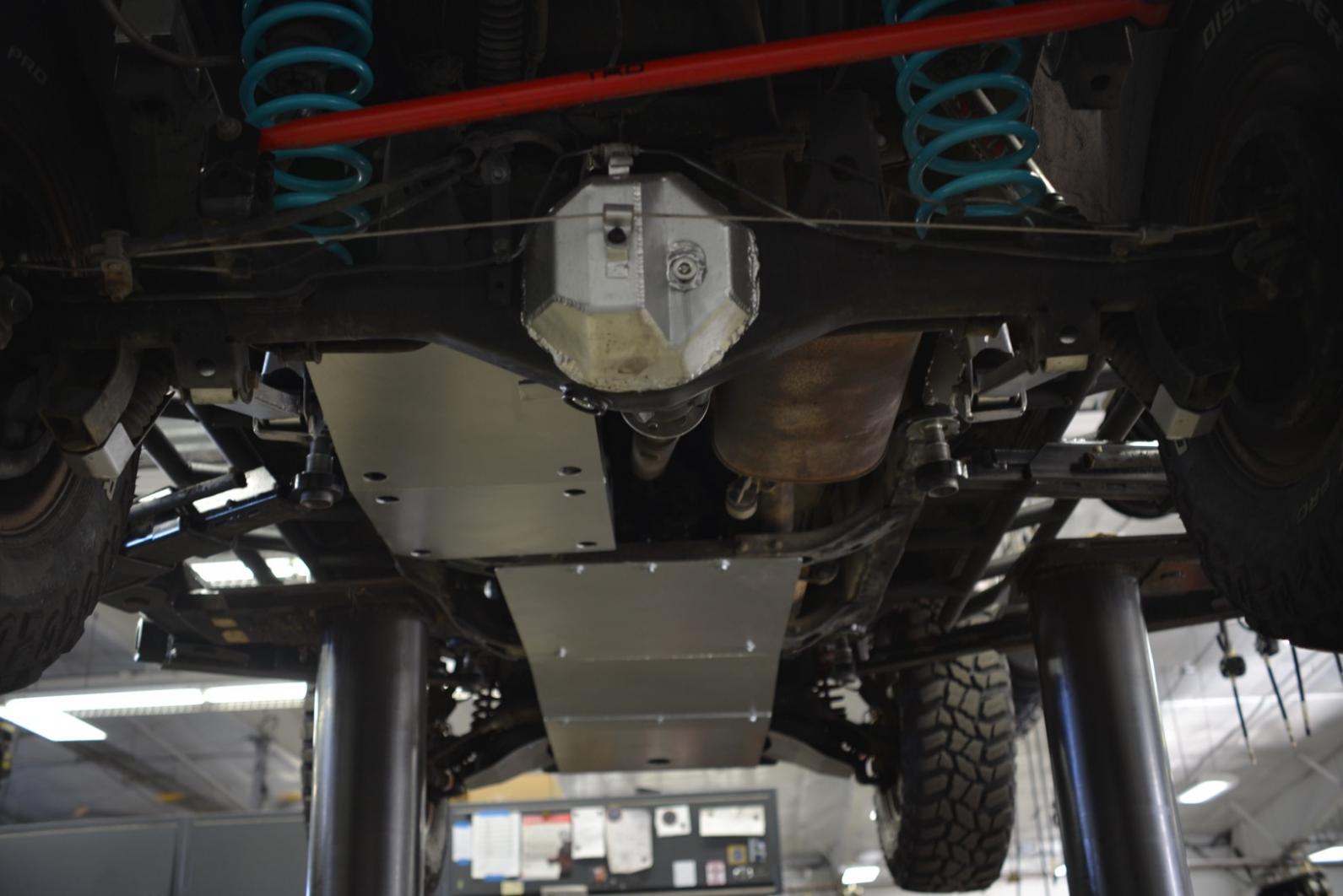

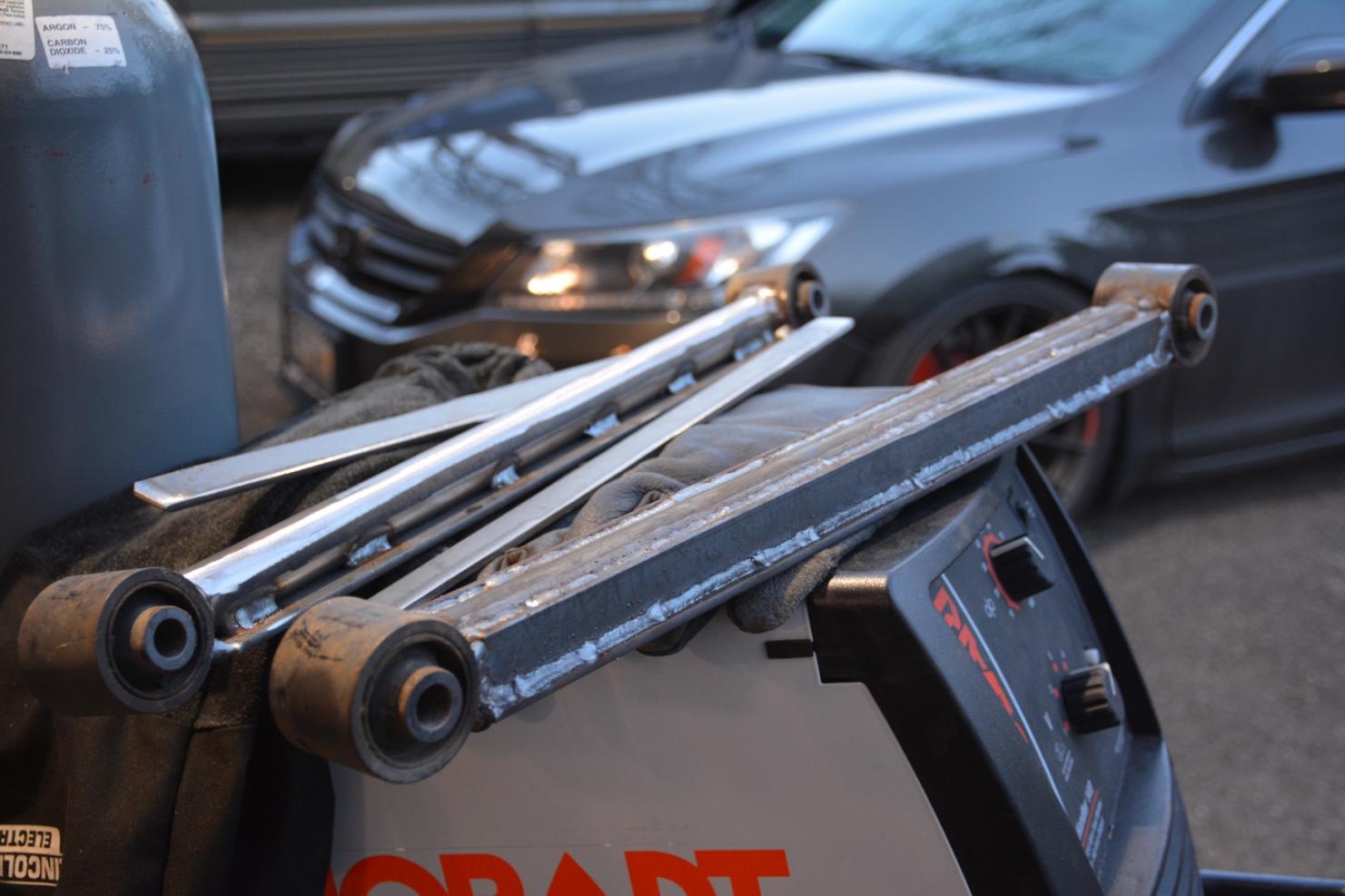

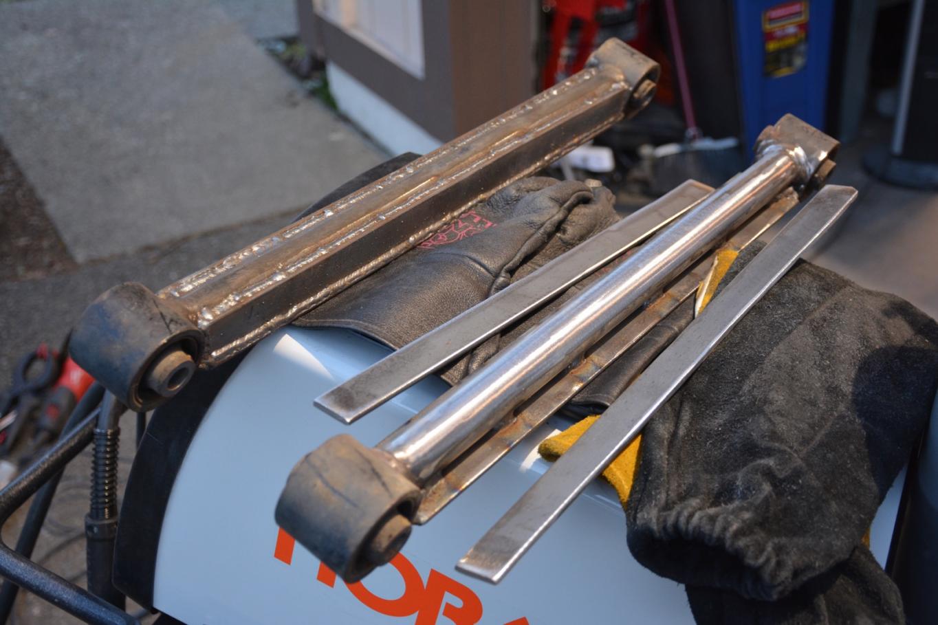

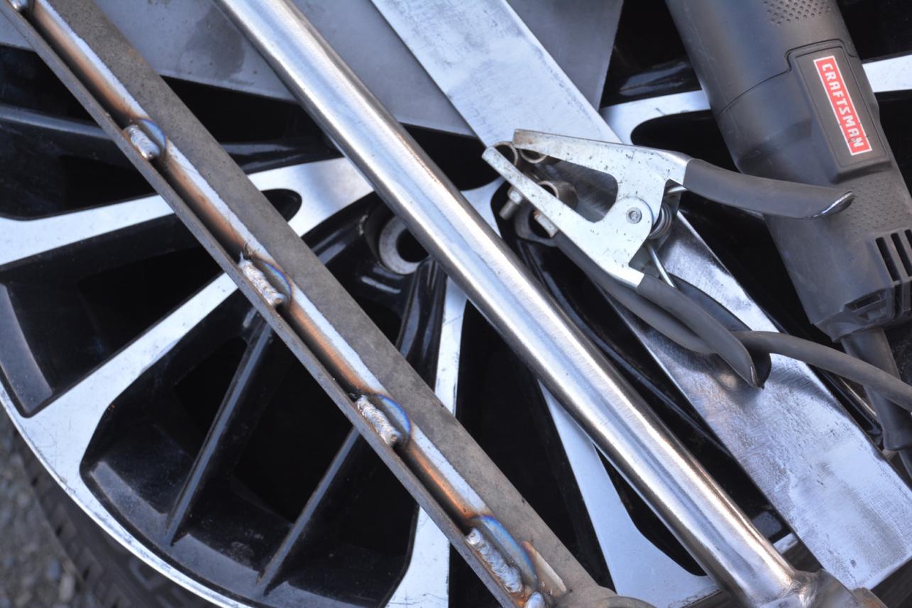

If you’re gonna bullet proof one thing, why not finish up with the following piece.... I went ahead and boxed/strengthened the lower links

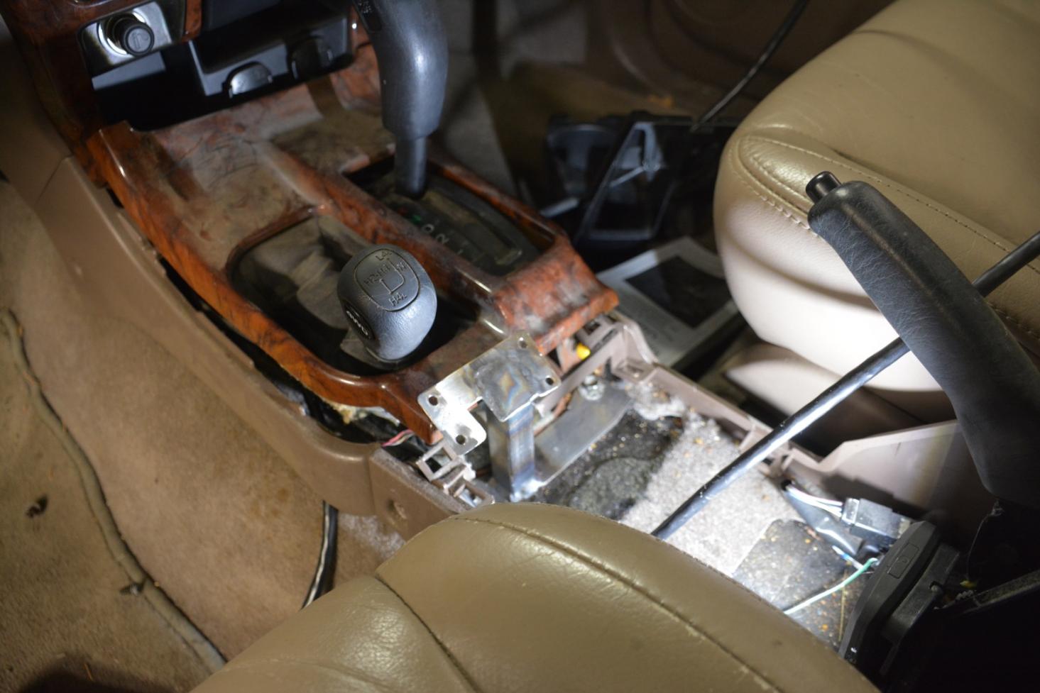

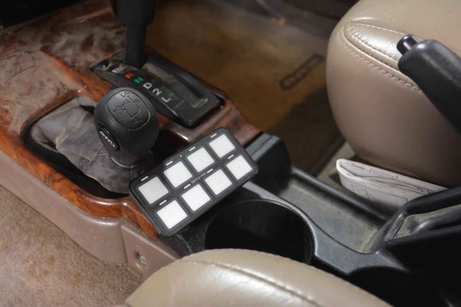

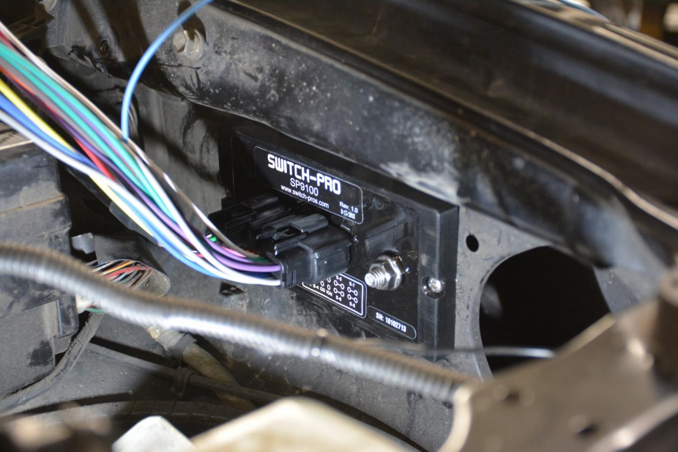

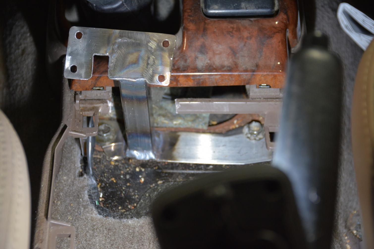

Switch pros 9100 install

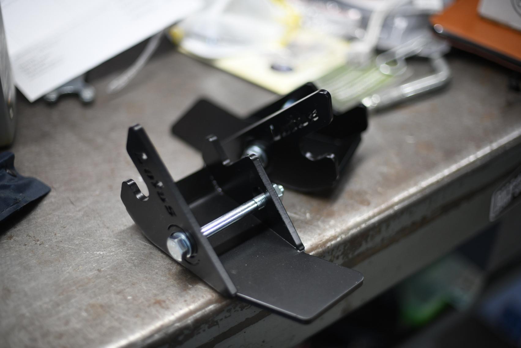

When I installed this I spent a little extra time tucking in the actual module to keep it away from heat/weathering. Also made a custom switch pros mount that mounts in between the cup holder and the 4wd shifter. It is completely clear of everything and within perfect reach even when my elbow is resting on the armrest.
^^**I might put these into production if anyone is interested**

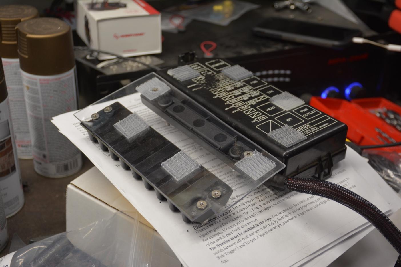

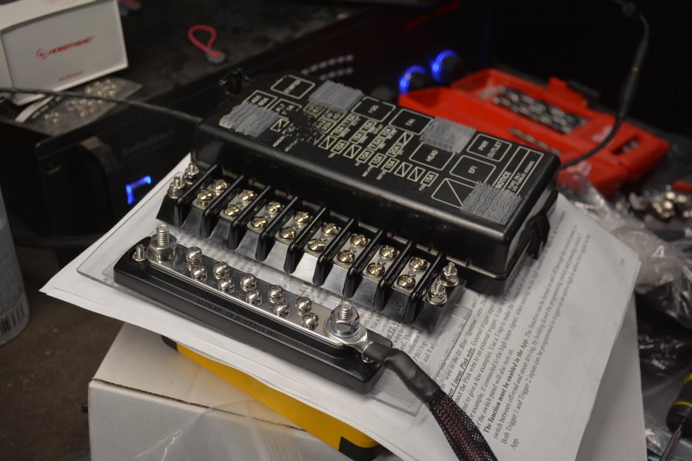

Made a quick release lexan plate to mount my BlueSea busbar/negative terminal

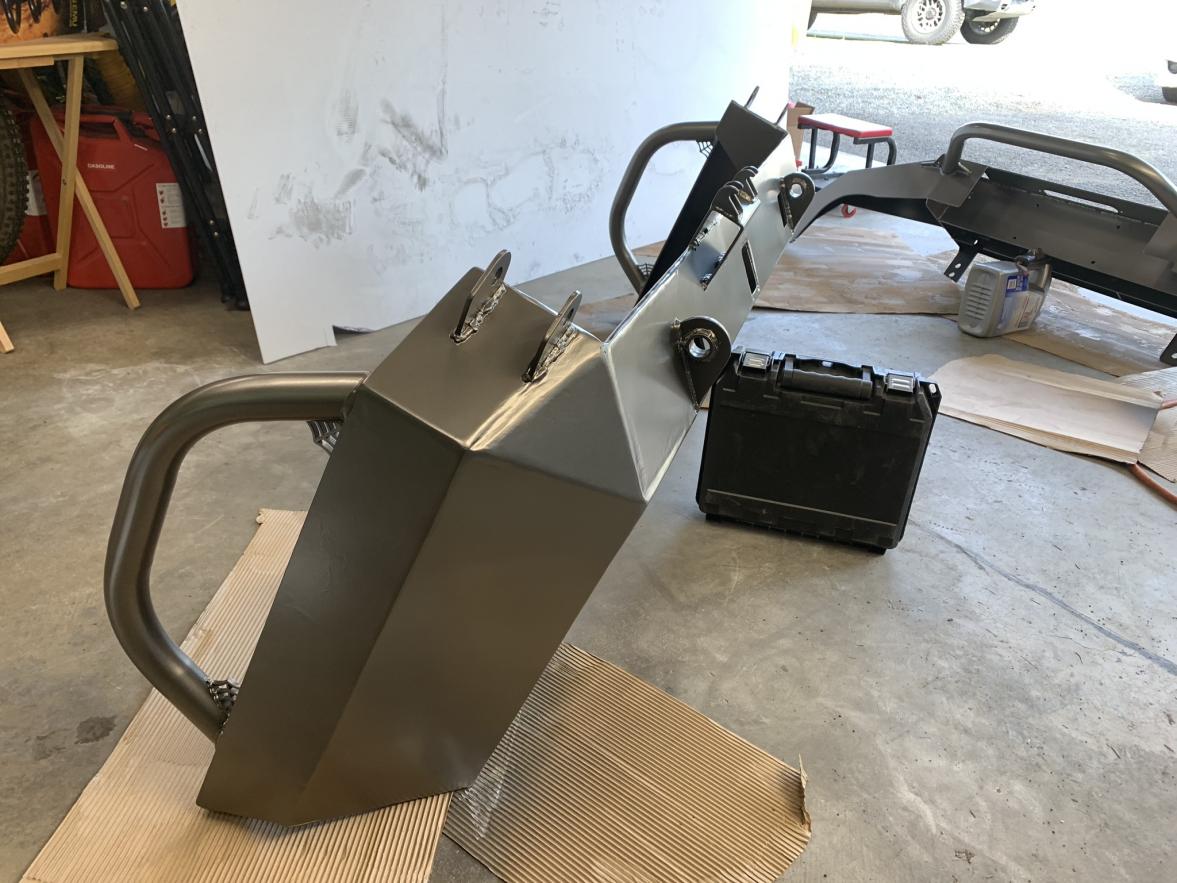

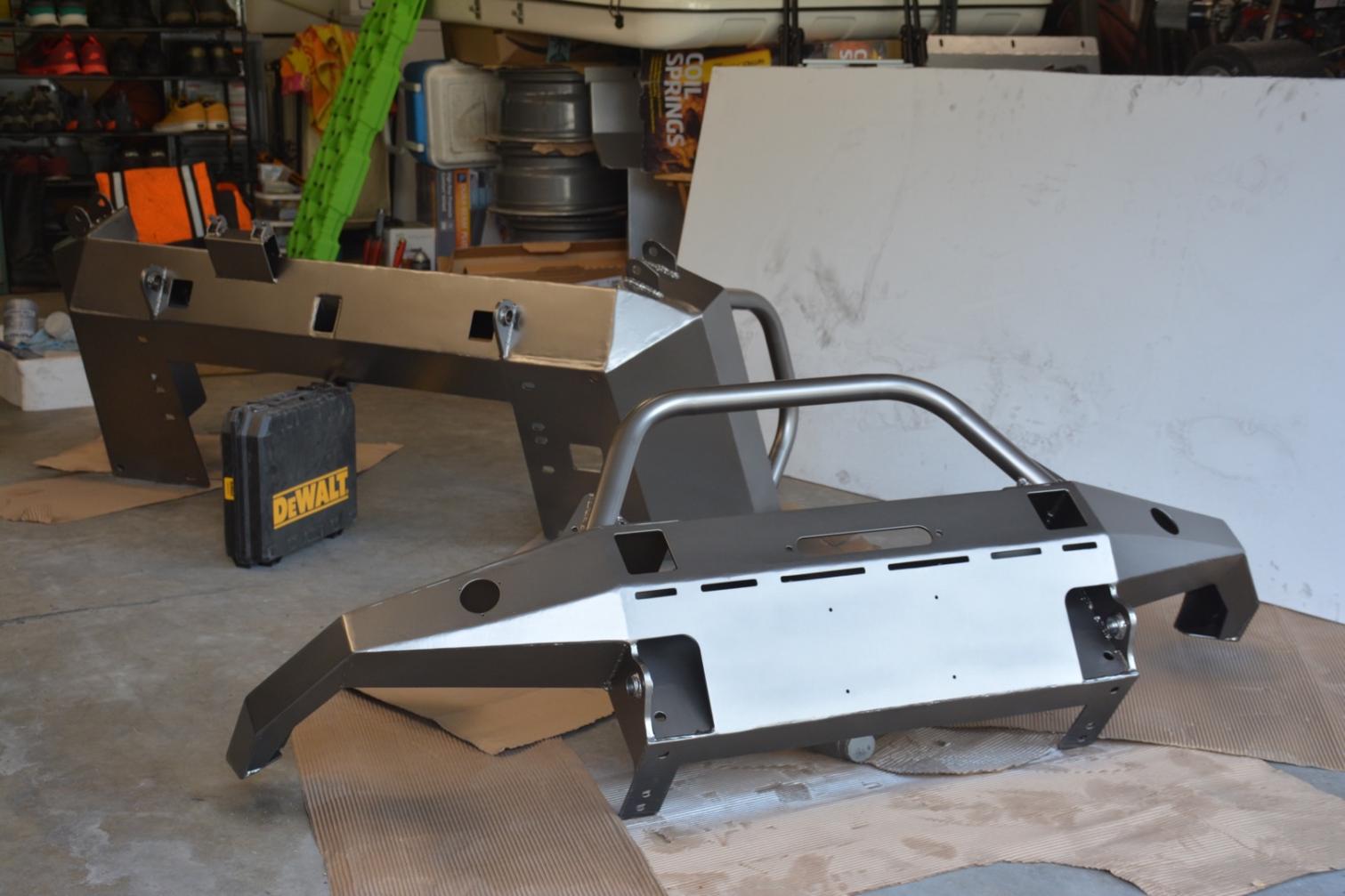

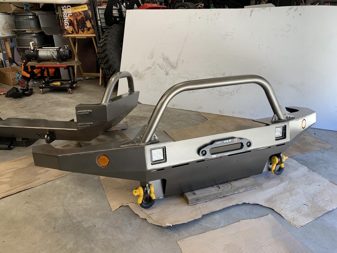

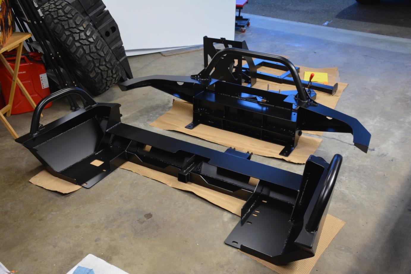

Powder coated Coastal Offroad bumpers

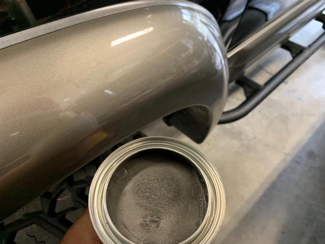

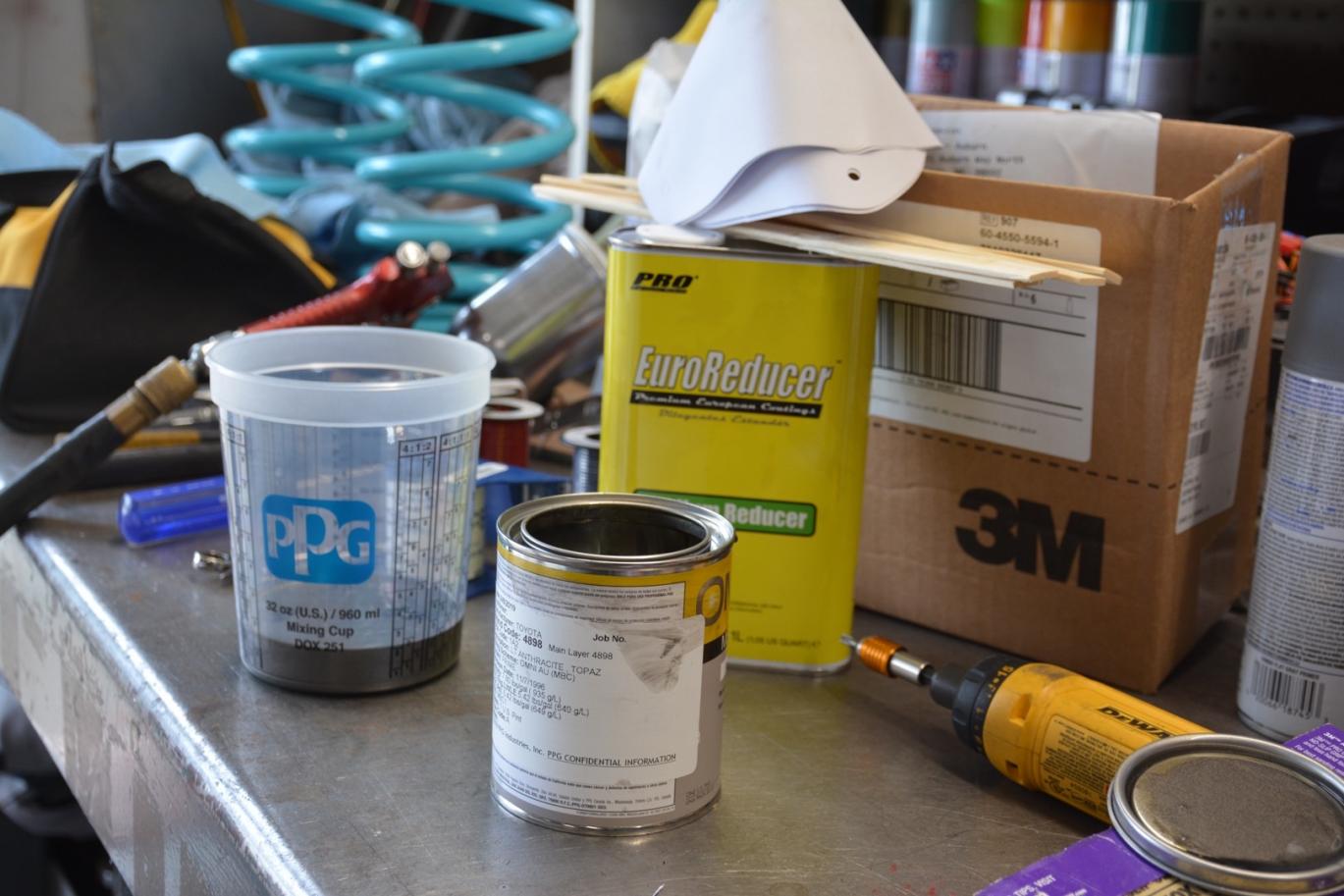

Paint matched my bumpers to my lower trim

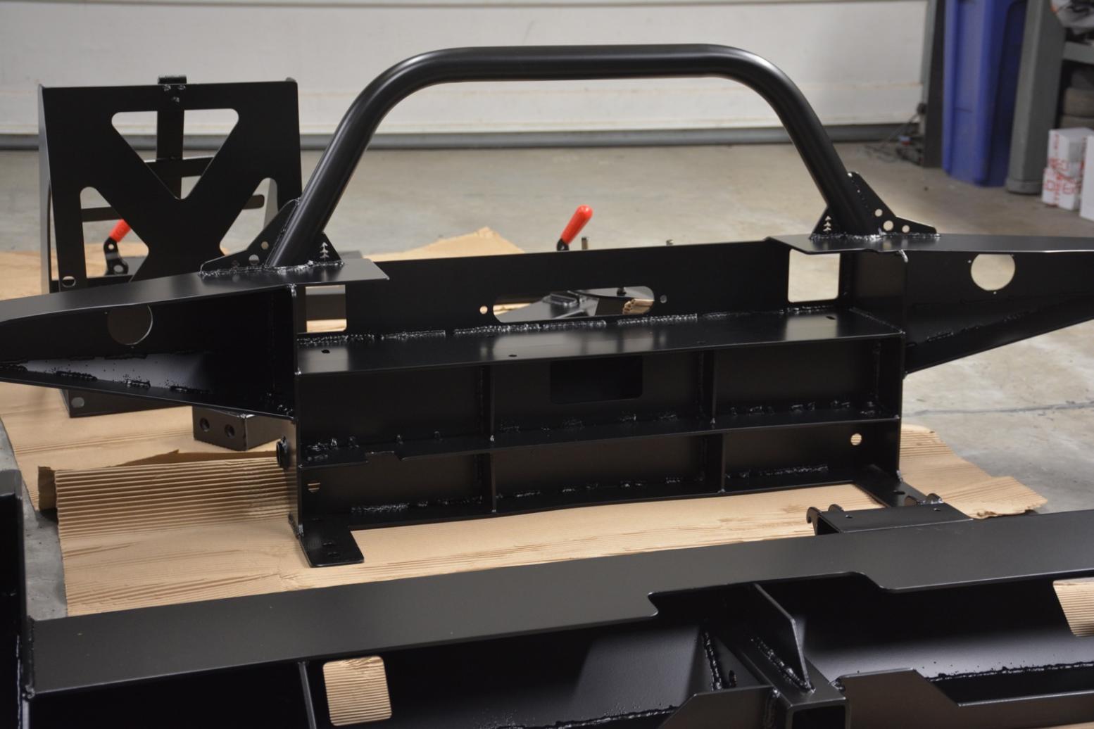

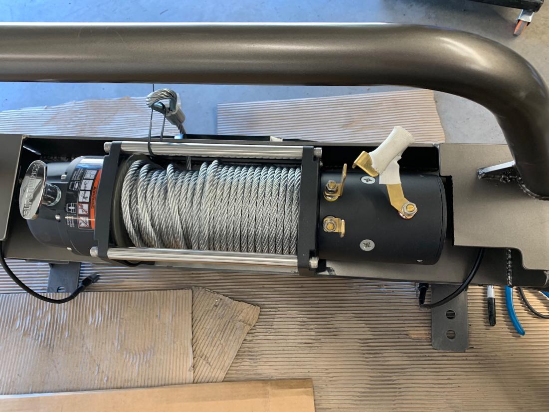

Installing my winch, had to do a little trimming of the top plate on the bumper to clear the motor

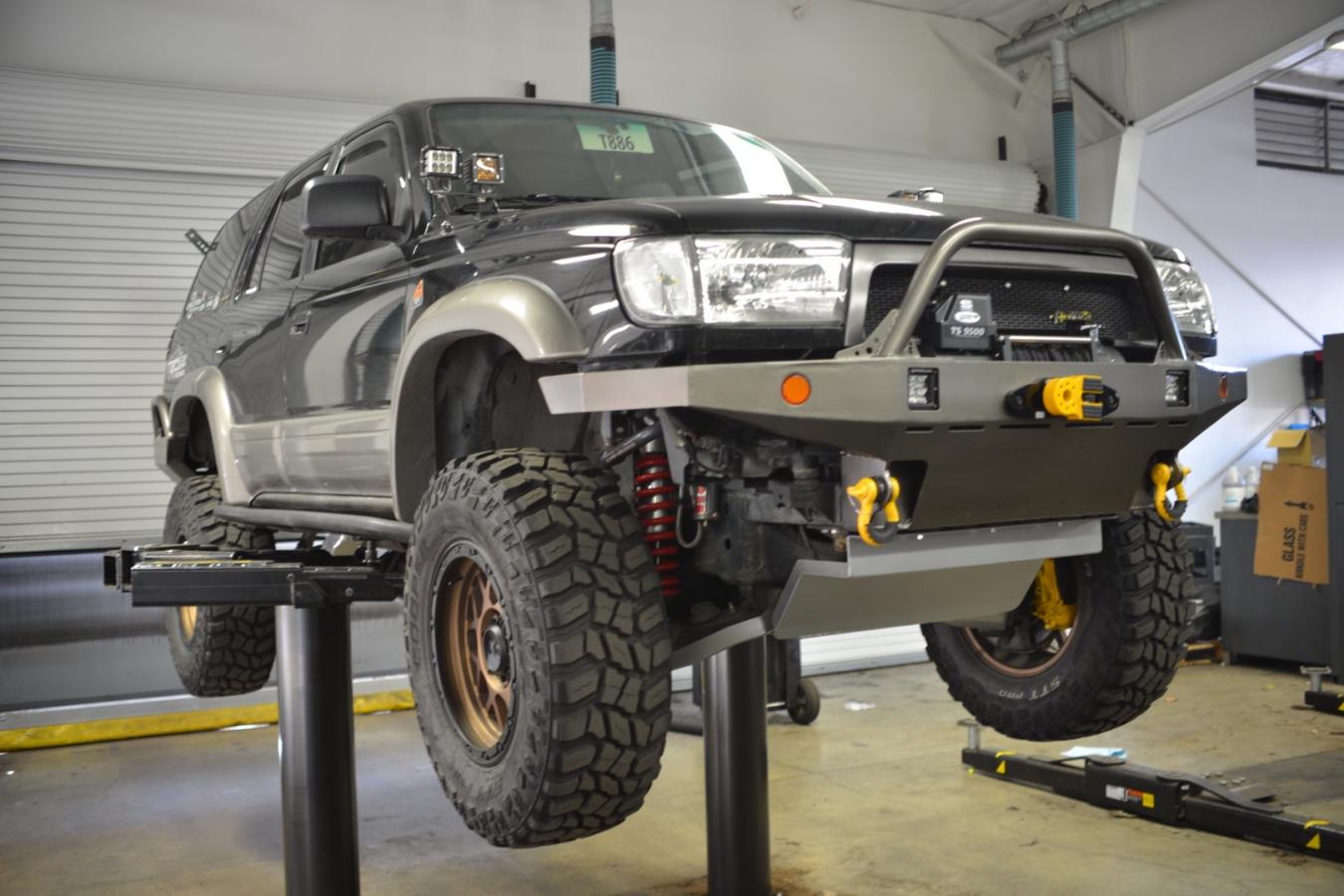

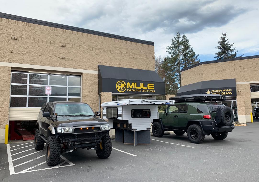

5.29 Nitro regear/Arb front air locker
First time vehicle is going to a shop to have work done. I’m completely confident I’m uncomfortable with setting up gears. Setting backlash and all that noise. No thanks... had good experience with Mule Expedition Outfitters here in Issaquah, WA.
5.29 Nitro gears

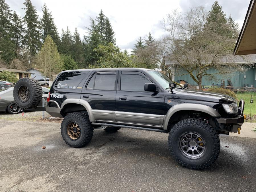

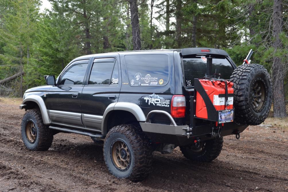

Finally, a moment I’ve been waiting for the past 2 months. Broke in the gears and finally installed the bumpers, and painted skids. Only time it’ll look this clean/unscarred.. might as well enjoy it

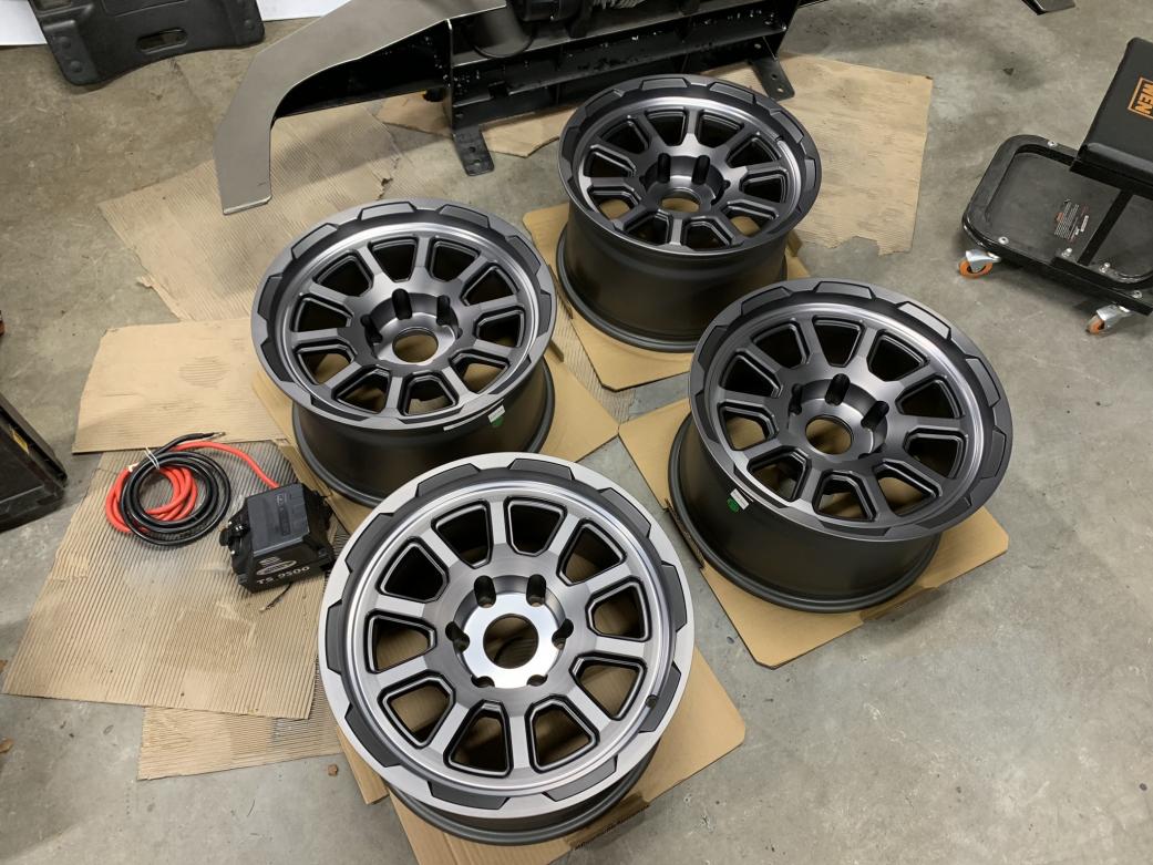

Just when everything is going fine.... I decide on switching to 35’s.... mainly for axle clearance. I was sliding off my rear differential a good amount of times on the past couple of trails
P.S. also got some new wheels. Black Rhino Chase rotary forged wheels
