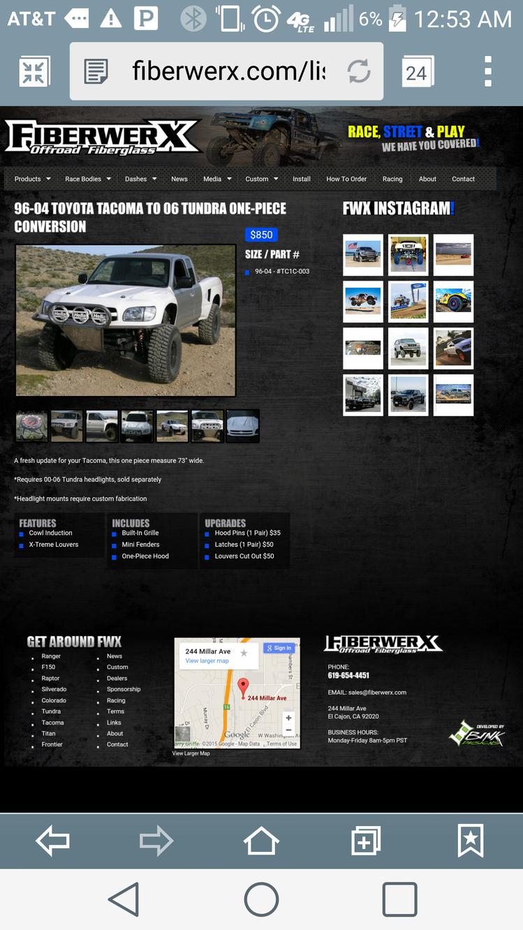

Quick question folks im thinking about doing an 04 taco clip conversion but I'm wondering if a kit such as the one in my picture that would fit a 96-04 taco would in turn fit my 4runner. If all 04 taco parts fit up with some slight modifications then this would work right?
Technically, yes you would be able to make it work I'm sure, but it is going to have massive 4" flares and probably 3-4" Rise on either side, so unless you're planning on long travel, it's gonna look goofy, there is also no rear set-up that would match the width.
Would it fit? Sure. Will it look hideous? Absolutely.
