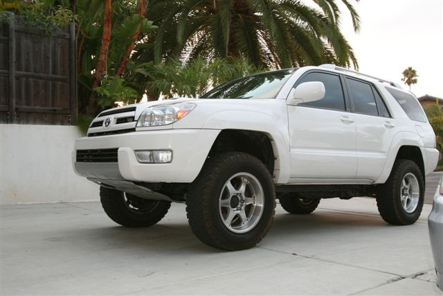

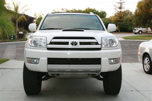

Yes, drilled one new hole, scrapped the existing mounting brackets, and bend it back it bit by leveraging it on a step and placing your weight on it...make it fit.

nice lift bro.
It is nice to see a 5" lift out there. I thought there was only the 2/3 cornfed lift available.
So is that a 5" in the front and 5" in the back?
How much for the lift? and installed?

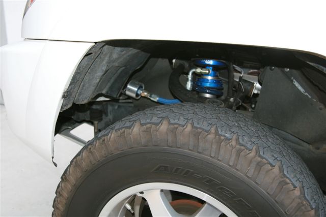

So is that a 5" in the front and 5" in the back? FRONT IS 5, BACK IS 4" USING OLD MAN EMU SPRINGS. I LEFT THE FOX CO AT THE STOCK SETTINGS, AFTER INSTALL I NETTED 1.5 INCHES OVER MY 4 INCH REVTEK (3/4 INCH TOPOUT NE SPACER) SINCE INSTALL 6 MO AGO ITS SETTLED TO JUST OVER AN INCH HIGHER THEN OLD SETUP, HENCE MY 5 INICH CLAIM
How much for the lift? and installed? I INSTALLED MYSELF, I THINK THE CO WERE PRETTY PRICY, MAYBE 1200-1600???
What are the biggest size tires you can run without rubbing? Height & width of tire? RIGHT NOW I HAVE 285/65/18 WHICH IS A 33X11.5, BFG HAS A NEW SIZE ON THE AT KO'S - 305/65/18 WHICH I AM GOING TO TEST FIT, THEY ARE 34X12.5
How is the ride, handling, gas? CORNERS BETTER THAN WITH OLD XREAS SYSTEM, HOWEVER SUSPENSION IS STIFFER, I AM USE TO IT NOW. I LOVE IT, I CAN CHIRP ALL 4 WHEELS NOW OCCASIONALLY...
Sorry so many questions, but I am preparing to lift my 4r and just wanted some additional info. I'VE HIT THE TRAIL PRETTY HARD, BLEW OUT MY FRONT BOOTS BUT THEY WERE REPLACED UNDER WARRANTY, PROBABLY JUST ORDINARY WEAR AND TEAR AS I HAVE 60k NOW. MY 4RUNNER NOW HAS A TENDENCY TO CHARGE DIPS AS FAST AS POSSIBLE REGARDLESS OF DEPTH AND ANGLES NOW, NOT SURE WHY BUT ITS FUN KNOCKN' MY NOGGIN AROUND...

I still like the older style since the new one sits way under the Runners and just looks like a regular plate just painted and doesn't stand out at all.
But, this one is probably more functional and eats less approach angle??
Hello - came across this old post of yours and I got inspired! I picked up the same Tacoma skid plate to put on my 07 4Runner. Seems like mounting it is going to be a bit harder than I thought.
Did you bend the front lip flat? Also, if you still have this 4Runner, any chance you would send a pick from underneath so I could see where you mounted the bolts and where you drilled the hole?
Many thanks if you can,
Mike -
Unfortunately I sold the 04 back in 11 when I bought the LC 200, I remember vaguely I had to drill 2 new holes, don’t recall if I had to bend any lips...good luck!
Appreciate the response. I think I have the front figured out using existing holes and will need to drill two holes for the back. Thanks again.
