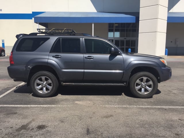

Here's my after pic. This is how it should have came from the factory. I took it on some swamped out forest roads last weekend and the ride was awesome. Truck is loaded with camping gear in this shot.
That looks incredible. What size tires are those? Any rubbing?
Thanks, they're just 265/70/17. Had some minor rubbing. I removed the front mud flaps but not sure if that was even necessary. It was definitely rubbing on the front of the fender liners, pushed them forward/in about 1.5-2" and there's no rubbing at all now.

Hmm. I do like that look. I bought the same spring setup, but I'll have Bilstein 5100s all around instead. I'm installing it Saturday, and I wanted to put it on the .85 setting. It seems like it'll for sure make the front higher than the rear. Might need spacers for the back.
Yeah if I had to guess you'd be ever so slightly higher up front. I have some positive rake right now (which I wanted), so I suppose there's a chance you'd come out level. Plus you have more weight up front with the V8. Tough call.
Yeah, I'm hoping the V8 brings the front down just a tad and I don't get the full 1-1.5" that the TRD springs supposedly give. I think I'll have to just do it and see where it sits afterwards and adjust accordingly.
FWIW my springs added 1.75"-2" up front. But my old springs had 160K miles, so there's that.
