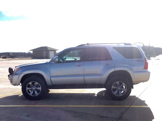

That's pretty much it. The Sport/SR5 springs I used are not the progressive rate springs. It's pretty easy to tell which is which since the Off Road springs have a brown plastic insulator near the top of the spring and the top few coils are much closer together. Here is a picture of mine with the Camburg ball joint control arms.

All done finally. (Partial cross post)
2004 V6
Height
Before
Front pass 35.5
Front driver 35.5
Rear pass 36.75
Rear driver 36.75
After
front pass 37.5
front driver 37.5
rear pass 38
rear driver 38
Start
The bushings. I used a carriage bolt and two sockets (without a vice mount) for a while. Then I got impatient and frustrated and started hammering the thing. Hammering was fast and easy. Then I pushed the new bushings in by hand most of the way, and a few taps from a rubber mallet. I also managed to get one bushing stuck in a socket for good.
Mounted
Then these *****es...
Wouldn't come off, so had to sawzall the bolt.
FJ Springs and new shocks
All done finally.
So you kept the daystar spacers on all the way around with the swap?
I made the mistake of removing the front spacers. So I am butt high... However if I had kept the 2.5 front daystar spacer I would never have fit in the garage. Sooooo I got some 1" toltec spacers I am going to add to help level it out.
Well, I originally bought the Daystar 2" spacer (1" size) and was planning to replace the fronts with them, but decided to leave the 2.5" on after all. Given the before and after lift heights, I'm glad I did or I would have been butt high also.
I thought it was going to be very nose high even with the 2" spacer, but I was clearly wrong. I'm still butt high with the 2.5" on there. I'm debating taking the rear 1.5" spacer out actually.
Yeah. I really could keep my daystar up front to get level but then I would have to remove my light bar to fit in the garage. So I'm hoping the 1" spacer will make me happy.
