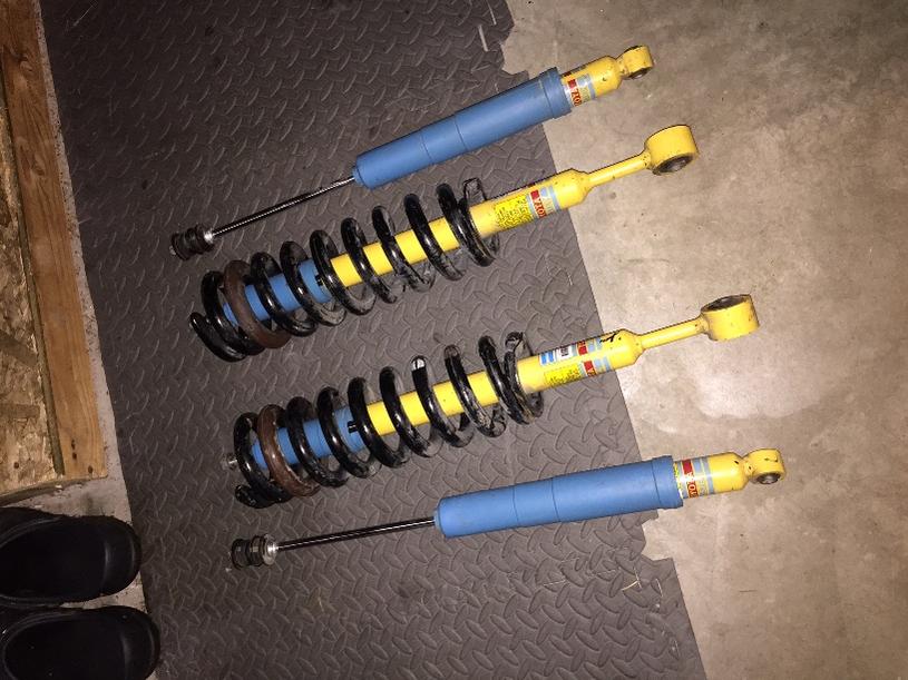

Hey guys, new to the forum and this is my first post.
I've been doing some research on swapping out my X-REAS to level it out and gain more off road capabilities and decided on going with the Tacoma TRD Off Road swap. At the same time, this is my DD, so I want as much of a complaint ride as I can (plus I don't want to piss off the wife) with the added capabilities.
I found a local guy selling his used set from a 2013 and he claimed there was only 15K on them (although based on their condition, I wonder if he left off a digit). Anyway, I went ahead a bought them and I'll be doing the sway in a couple weeks. I still need to buy the bushings and get them pressed.
I was planning on using my stock rear coil, but after reading some of the comments, sounds like I need to either add a 1.5" spacer or pickup some rear FJ springs. It looks like I purchased the progressive springs and now I'm reading that it may be too soft? Should I add a 1/4" or 1/2" spacer up front to add some preload?

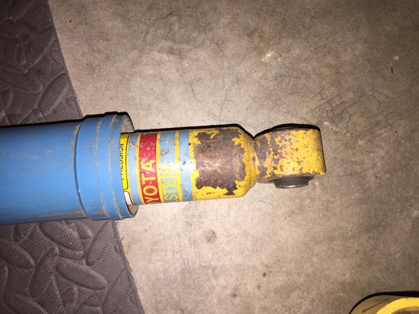

Also, I'm planning on sanding and spraying the rear shock to make sure the rust doesn't spread any more. Is this rust in this location common?

RL: $273.48 RR: $248.39 FL: $196.30 FR: $196.30 total $914.47 (list price is about $350 more). $1,135.65 with shipping and tax to Washington State. That's without install or alignment. Install is a bit trickier too because you have to raise all 4 corners at once to allow the shocks/struts to completely extend so you don't lose any hydraulic oil when you disconnect. That's about the price of some nice coil overs, hence the reason people ditch it for something else (Bilstein 5100's are around $350 for a set as a comparison).
When I first bought my 4Runner, I just liked the look of the Sport Edition, but didn't think much about the suspension (didn't do much research), I just figured that it would be off road capable since it was a 4Runner.
I'm choosing to go with the Tacoma TRD Off Road set up which has progressive springs (different than the linear springs on the TRD Sport) with my stock rear spring, because as I stated above I want some off road capability and a bit of a lift in the front. I still haven't determined if I'll be adding any spacers, might need some in the rear as I've read the Tacoma rear strut can out extend the spring. I'll be doing the install in the next couple weeks and I'll report back on the ride quality.

Local guy on craigslist took them off when he upgraded to OME. Searched "Tacoma" on craigslist auto parts section and just scrolled through the mostly junk until I found some. There's one from a 2016 TRD Sport I believe for sale too. Not sure if they'll ship, but worth a shot I would talk them down to 100-150 for the shocks and springs only.
