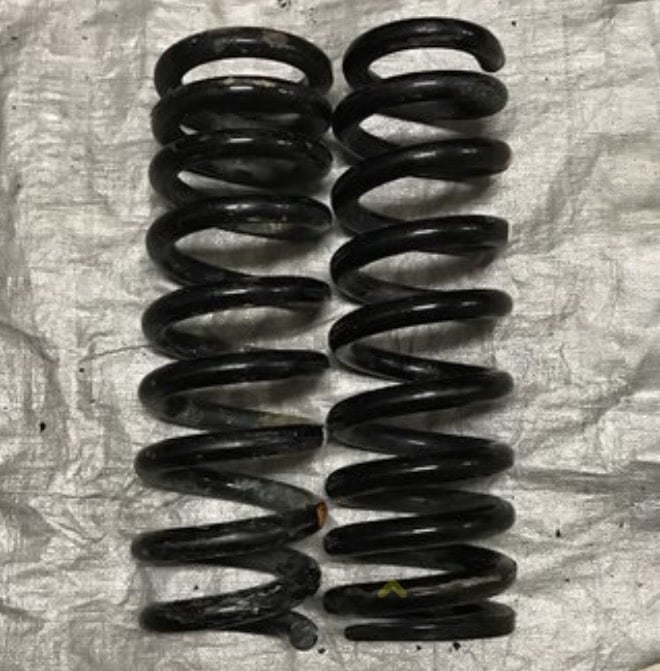

While researching a few different lift options, I located these part #'s for the Tacoma TRD Off Road front coils:
48130-04820
48130-03830
Good luck to anyone else researching.
for the rear, 4Runner OEM coils:
48231-35281

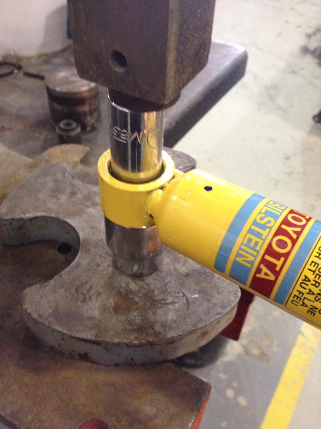

Pressed out the rear bushings
Didn't need much pressure to press them out.
I didn't have a press, so I just used the 3/8" rod stock and bolts in the vise method. I used a 1 1/16" socket because it was cheaper that a 26 mm and a 19 mm socket on the other side. It worked pretty well. Only recommendation I have is to buy some stainless steel washers to back the sockets. The zinc ones totally failed and the galvanized ones didn't fair much better. I used a combo of stainless and galvanized and that did the trick.
