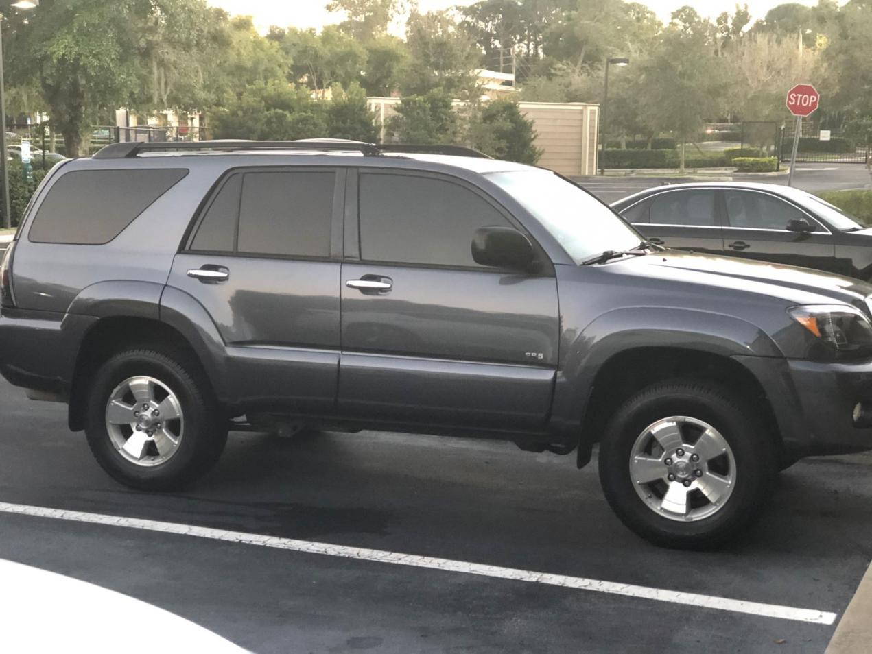

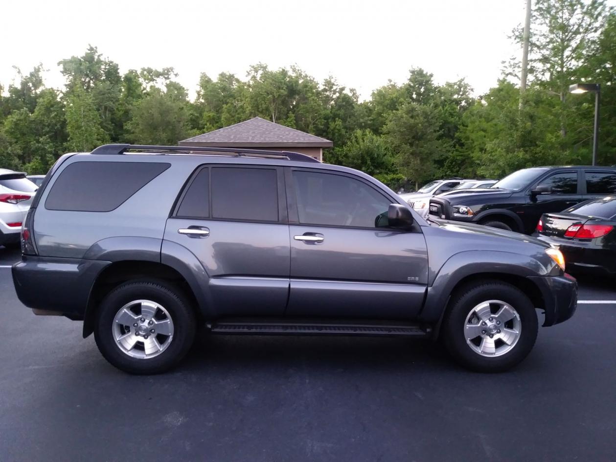

I just installed the same 3rd gen Tacoma TRD setup in the front of my 168k mile 2006 V6 SR5 the other day, and I am super happy with it. My suspension was sagging for sure, so I actually gained right at 3" lift. It is dead even with the rear now, which is still stock, but I do have the .5" driver side lean LOL. I am leaning towards the OME 895e springs for the rear with the Tacoma Bilstein shocks that I got, and from research and even talking to Toytec this should get me about 1.5-2" lift in back. I also carry about 100lbs around in the trunk normally, and occasionally tow a jetski or small trailer, so I think it will give a slight rake and handle the load fine. Pics below so you can see the difference in just the front.
