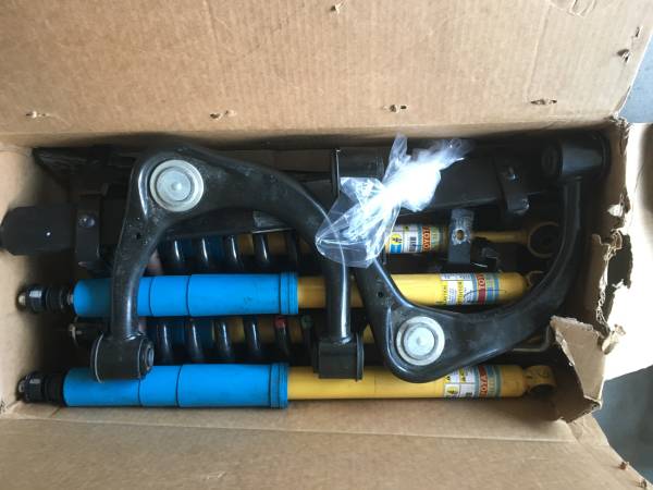

2017 Tacoma TRD Offroad suspension
make / manufacturer: Toyota
model name / number: Suspension
Suspension componenets from 2017 Tacoma TRD Off-road. Removed from truck at 150 miles.
Includes:
4 Bilstien shocks
Upper control arms
Coil Springs
Overload leaf springs
These parts were removed from a brand new 2017 Tacoma TRD Offroad with only 150 miles.
Will fit all gen 2 and gen 3 Tacomas. For the Gen 2 bodybstyles, this suspension will lift your truck about 1.5".
do NOT contact me with unsolicited services or offers

If you haven't installed them yet, yes they will bolt on after replacing the rear bushing. I don't think a C-clamp will be strong enough to press out the bushing, I used a 5" vice bolted to my work bench and bent the crank rod a bit doing it. Take it to a shop and have them do it for $10. I think the rear shocks are too soft however, so I'm looking at getting something different. Maybe Fox, ICON, or Bilsteins. Just too bouncy on the freeway.

https://newjersey.craigslist.org/pts/d/trd-toyota-tacoma-off-road/6201655193.html I have an '04 Sport with xreas that is totally shot. Front end bounces all over and steering shakes. Would this be worth the purchase and a direct fit (minus having to press out the bushings)?
That's exactly what I installed on my '06 Sport a few months ago. However....that's way, way too much to pay for those parts. I got the same pieces off a '16 that were literally "new take off" (90 miles) for $200. For $350 you might as well just buy some new 5100s on sale.

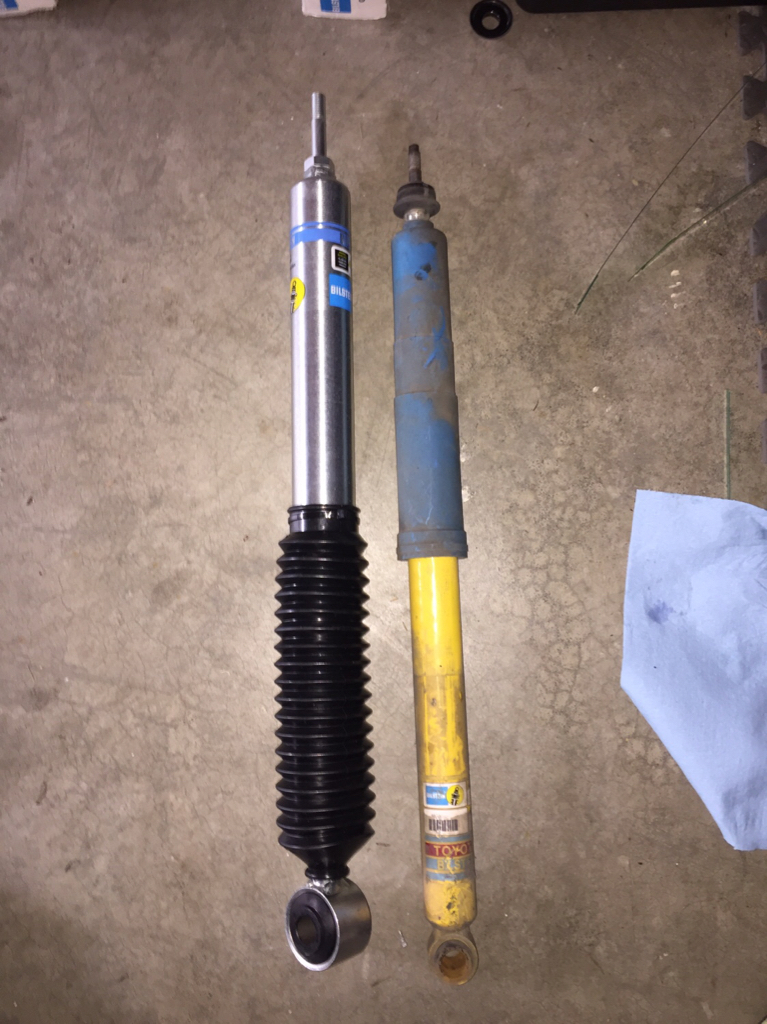

Got some rear 5100s for my birthday and installed the today. Wow, what a difference. The rear end feels so much more stable and connected to the road. We'll see how long before I start tinkering with the front. Did a bit of off roading with it and the front played really nicely with the wash boards, smoothed them right out. Might be okay with the set up but we shall see. Can't believe the difference in diameter between the Taco and 5100s.
Our rears are heavier than the Tacos so their shocks are inadequate. I also did the same move a couple weeks ago and the difference is night and way, I regret not doing it sooner.
For the front the Taco TRD O/R struts are a good cheap option but on the rear I would at the very least put 4Runner HD bilsteins (if not 5100s) - they would be an adequate match.
