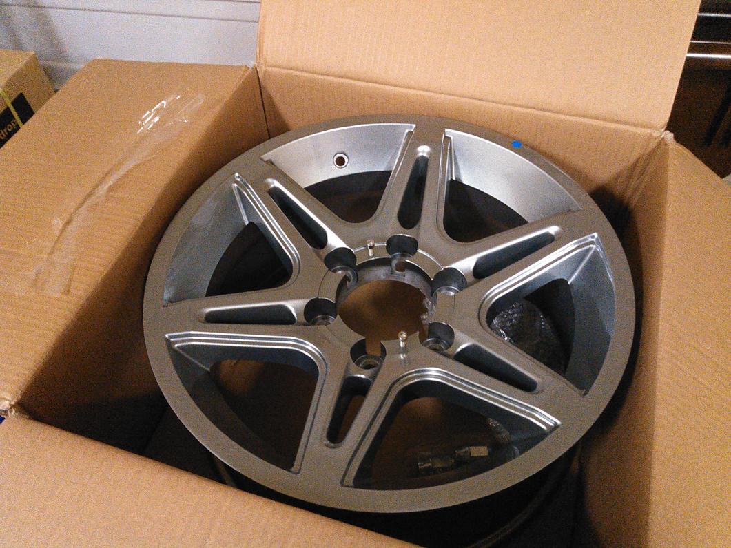

Greetings 4Runners,
I sold my 11' 4Runner and we just bought my wife a 15' SR5. We installed an Icon stage 2 lift already. I decided we wanted to install the Texas edition Tacoma wheels made by Ultra on it. They are listed as 17x8 18mm offset. When they arrived special order from the Toyota dealership, they showed it was a +18mm offset. My friend at discount tire said the factory rims on the SR5 are +12.
Has anyone installed these rims on a 4Runner? I've usually gone 0 offset all the way up to -20mm offset on my 11' 4Runner.
Thoughts, pictures or ideas?

do post how they fit once you have them on. would be interested in how they look.
