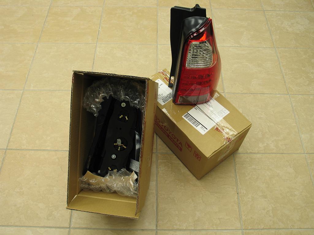

Here they are:
So I opened them and there is the lights out of the box.
They have the same fixtures, so they PERFECTLY fit to original place.

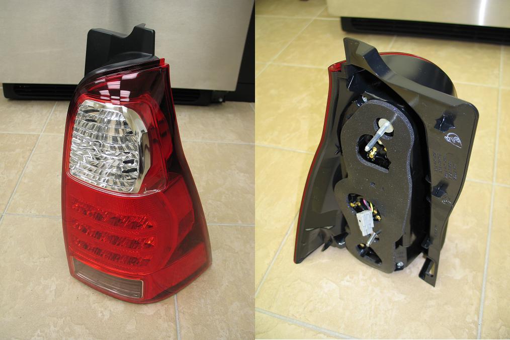

LED lights out of the box:

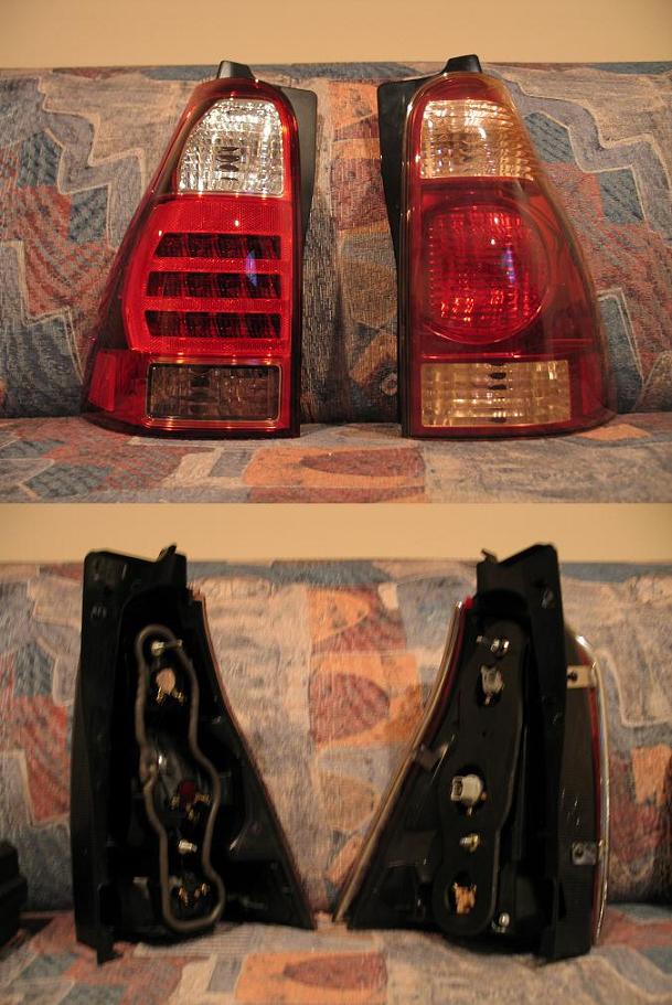

I took of my old ones from the vehicle. It was simple just unplug the connector and then unscrew two nuts holding the light itself.
Here is comparison of both NEW and OLD tail lights:

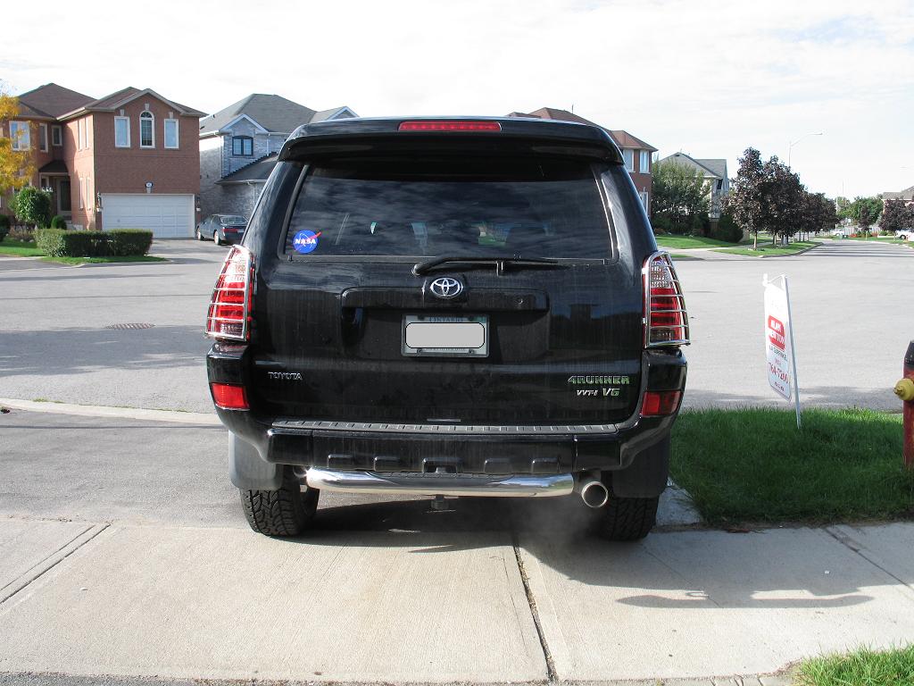

Finally done and on truck
After all I just reinstall the new lights to the truck back using the same procedure as I remove the old ones, in reverse directions, of course.
So now my truck looks like

Do you have any night shots of them yet?
I like how the 06 lens don't have that pinkish color over the turn and reverse sections.
That's awesome!
I'm glad to see it's an easy install. I was worried the wiring to the LED's was different! Thanks for trying it out and letting us know about it!
BEAUTIFUL! Thanks for a great detailed write-up; we all appreciate it. [And by the way, you are the man.]
