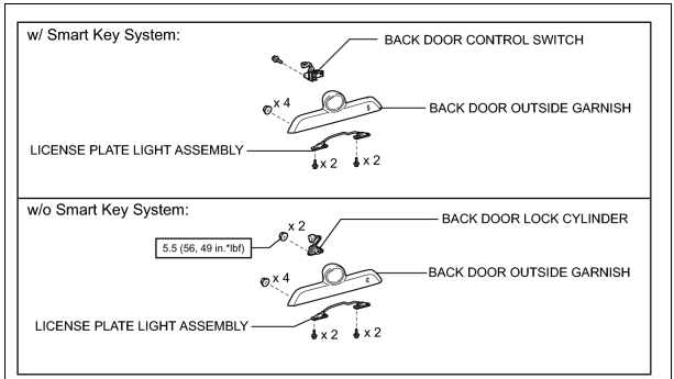

I was able to remove the ''T'' symbol easily but how about
the actual 4Runner emblem...is it held in place like the T or
is it glued?
From looking at the repair manual, it appears that there are 4 nuts on the back of the emblem holding it on. I'd assume removing rear door panels would allow access to this. I've attached what I'm seeing...

the 4runner emblem is simply glued in.
i used a heat gun on the low setting and removed them one piece at a time. took all of 5 minutes.
the thing thats actually going to take work is removing the glue residue left after removing the 4runner emblem.
Sorry, upon looking at the parts catalog it appears the emblem is separate from the pull assembly. They list the part as "Nameplate (Adhesive)", so I'm guessing that it's glued or taped down. I've never pulled mine, so these are guesses based on looking at paper.
From deka3's first link:
"It's not flat under them though as there are 4 indentations in the chrome plastic handle part to help line up the 4-r-u-n-n-e-r badge when it was installed."
