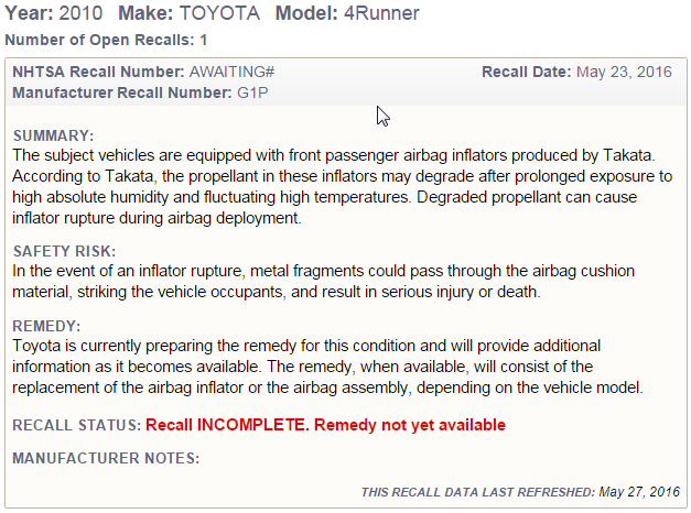

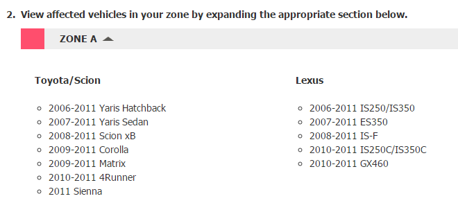

2010 - 2011 4Runner now added to recall
Toyota announced today (5/23/16) an expansion of the recall of Takata front passenger airbags to include the 2010 - 2011 4Runners. Like the previous recalls, it will be phased in based on regions with weather conditions that cause the propellant to degrade faster than other regions.
See Toyota's Takata Airbag Recall Information webpage (http://www.toyota.com/recall/takata#expandedTakataSafetyInfo), Update May 2016 section for details.

"SUMMARY:
The subject vehicles are equipped with front passenger airbag inflators produced by Takata. According to Takata, the propellant in these inflators may degrade after prolonged exposure to high absolute humidity and fluctuating high temperatures. Degraded propellant can cause inflator rupture during airbag deployment.
SAFETY RISK:
In the event of an inflator rupture, metal fragments could pass through the airbag cushion material, striking the vehicle occupants, and result in serious injury or death.
REMEDY:
Toyota is currently preparing the remedy for this condition and will provide additional information as it becomes available. The remedy, when available, will consist of the replacement of the airbag inflator or the airbag assembly, depending on the vehicle model.
RECALL STATUS: Recall INCOMPLETE. Remedy not yet available "
See Toyota's Takata Airbag Recall Information webpage (Lookup Safety Recalls & Service Campaigns by VIN), Update May 2016 section for details.
