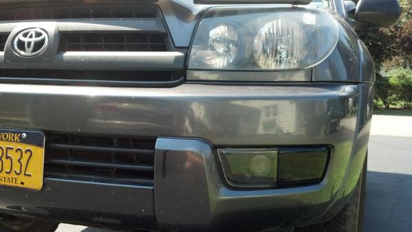

yeah I niteshaded mine and i love the look of the light when its lit but i dont like how dark it is when its not lit
Lit it is still plenty bright.
it doesnt match the subtle black of the other lights when not lit
Maybe throw like one coat of nightshades over the fogs to kinda blend them?
