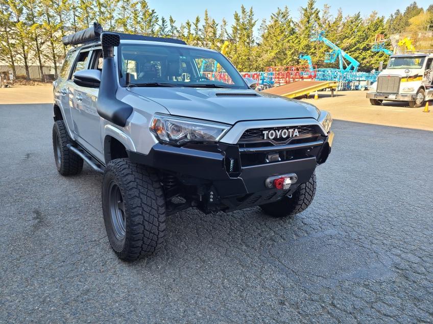

Title pretty much says it all, and my sig line says the rest... just totally on the fence on this one.
I’m a form follows function kinda guy and thinking goes something like this:
Since each tire is 1.2” narrower than stock, I probably have that much narrower of a wheelbase anyway. Consider then a full 3” of lift and I’m starting to feel like widening the stance for safety/stability would be prudent. However, I’m not dissatisfied with the appearance, nor the handling. If anything I like it and I’m loath to give up a slightly narrower track and turning radius. Given the tire size, lift, UCAs, shrockworks bumper, rubbing ain’t gonna happen—I got all kinds of room and don’t exactly need more.
So what say the rest of you?

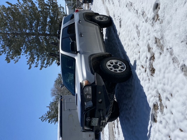

I've had mine installed for 250 miles now. If you do some Google searching you'll find that pretty much anyone who has experience with them have been positive. Just make sure you installed them correctly. I've done my 2nd spacer lug nut check and nothing has loosened. I'm going to drive from Seattle to Moab, UT with this set up. Spacers or really low offset wheels will decrease wheel bearing life but I'm already at 90k so I plan to change out the bearings by 130-140k miles anyway, if needed.
1. Clean your wheel hub and lugs with brake cleaner and brush.
2. Apply a tiny amount of anti-seize to the mating surface of the spacer.
3. Apply a dab of red loctite on the threads of the supplied lug nuts. Hand tighten all six of them. Conical end of nuts goes in first.
4. Torque nuts to 90ft/lbs utilizing a star-pattern. I added witness marks with a yellow paint pen. Torque wheels nuts to factory specs.
5. After 50 miles you want to re-check that the spacer nuts haven't loosened. Set wrench to 85ft/lbs so you wont break the loctite. If anything moves, you needs to re-torque that nut with fresh loctite.
6. After another 100 miles re-check the spacer nuts.
7. Re-check nuts every 5,000 miles or every tire rotation.

My 2011 is configured similarly to yours. I'm running the 1.25" spidertrax with OME lift. I have factory size tires on it and trail wheels, and the closest point of approach leaves about an inch in the front. I also have mudflaps on. I'm planning to go up a size with my next tire purchase.
The stance is perfect with these on. The tires are even with the side of the truck, which avoids beating up the body and removes the tucked look of stock.
