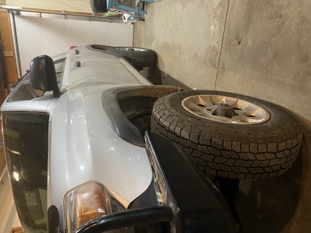

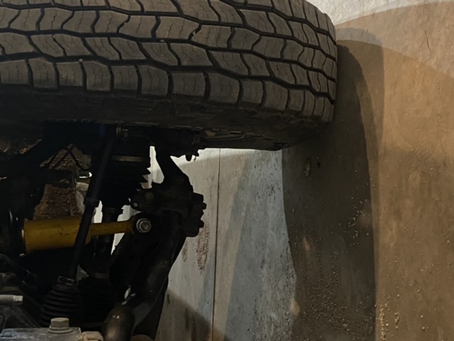

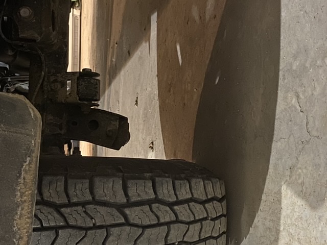

I’m still totally on the fence on adding these—at least I was until I impulse-bought sets of 1.25” G-2s this morning and put them on tonight. Just had an alignment done today anyway so time to form an opinion of my own.
Here’s the garage pic as she sits now.
Looking at it a little closer tho, moving the tire out seems to leave the LCA and rear axel shock bracket slightly more exposed being further off the wheel/tire. (Hadn’t thought about that till just now). But then come to think of it, I’m overdue for a real skid anyway, so what’s a couple more pieces of armor? (That’s the spirit, right? Lol)
Anyway, I just took it out for a cruise tonight and first impression is it handles just fine. Can’t tell if I’m feeling or imagining a wider turn radius yet. Oh well, away I go just the same.
Edited to say: Dang the picture reorientation
