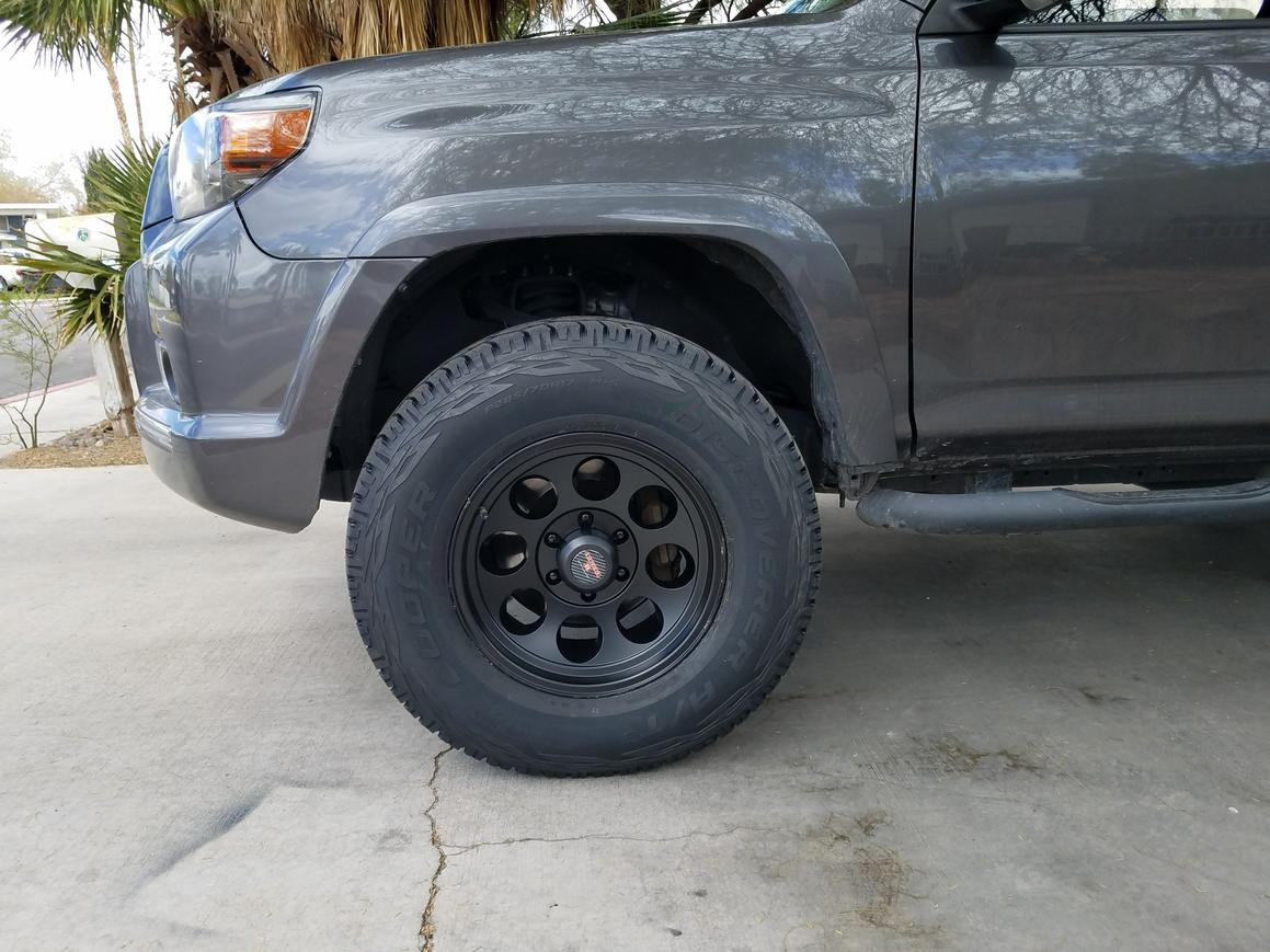

Just put my new at3s on my new level 8 trackers & we had good rain here , handled really nice & stopped on a dime (I drive dumb/fast for an old man) :sleepy: anyway very pleased !:hatsoff: yaya 5th gen :ybrick:

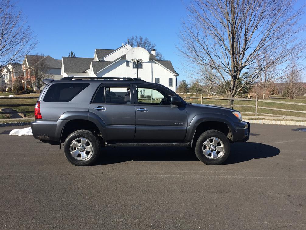

I did not see enough to talk me out of the Cooper Discoverer AT3 and I ended up getting them in 275/70/17. Now, for anyone that has them, can you put some pics into this thread? The other threads with 300-400 pages is too much to compile the few pics of trucks with these tires.
I finished my lift and when I drove to the dealer for alignment it drove like stilts wearing roller skates. I hope a bad alignment can have that type of effect on the drive. Wheels were whirling at over 40mph, bumps in the road were basically tossing me sideways, etc... It was not a fun 15 mile drive let me tell you.
To refresh:
Front 5100/885 (with 1/4" spacer on drivers side and 5100 set at .85)
Rear Icon2/Icon2
New SPC UCAs
New Aftermarket LCAs
New Lower Ball Joints and LCA brackets
New Cam hardware
New CV Axles
New End Links
New Outer Tie Rods
Looks to be about 3" lift (still settling).
If ANYONE has the Discoverer AT3 in 275/70/17 with a comparable 2.5 - 3" life please share a picture in this thread. I have added in 1 picture of my truck with stock tires post lift.
I REALLY want to see similar lifts with the mentioned tire size in AT3.
Did you assemble the front strut yourself? How difficult was it with the .85 setting?
I have a close setup. Bilstein 5100s/885/Superflex HDs with 265/70/17 AT3s. But my rear is definitely way higher right now. The rear should still settle a bit (still fairly new), but I also have a lot of weight up front and I need to bump it up.
I like the level on yours. But I know it'll 100% make me require UCAs, and I need to replace my LCAs too. I probably should do it anyways.
Surprised you did the OME 885 + spacer + .85 setting, that's really high, maybe that's what caused all the issues when driving? Any chance you can take measurements, I'm interested to know how much rake that is, it's hard to tell. I was looking at the exact same setup, but contemplating Icon vs Toytec rear springs.

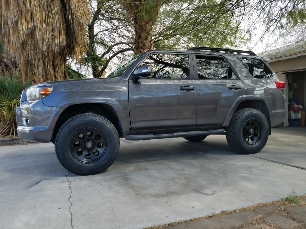

Just put these 275 70 R17s on. Toytec/bilstein suspension.
wow, that looks exactly like my rig. Do you think you could have fit 285's with that lift or would it have been major trimming and BMC? Did you do measurements before/after? I was hoping for a little bit fuller wheel well with the 275's...
I bought the vehicle like this. So I don’t have before and after measurements. I agree the wheel well doesn’t look very filled out. Not sure on 285s. I was more fearful of the vehicle being sluggish going up another tire size and wasn’t going to regear.
