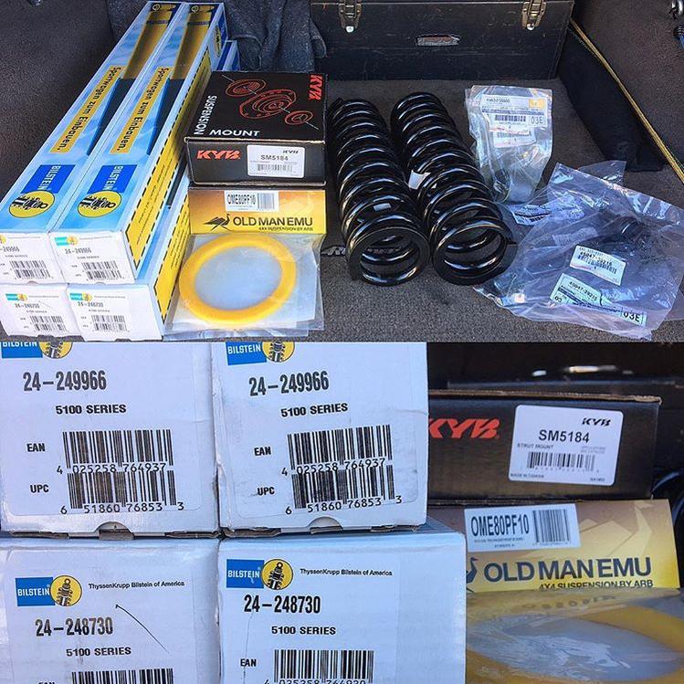

All my parts are in. 4Runner specific Bilstein 5100s and OME 880. I'm having trouble finding which perch to set the spring catch on. Looking at the directions at 0 you maintain stock height so with these coils being 1.5 inch lift coils would 0 net me the lift I'm after?
At the "0" setting you will get the 1.5" of lift that the 880 will give. Moving the circlip higher will give you more than 1.5" etc, etc... Show us pics when done!!
I'll be about 2.3 inches in the rear with the 906s and the 10mm trim packers. Maybe I should do the second notch to make it level? Or keep the front end happy and go with the first notch and live with a little rake.
Pictures will def come! As well as a review. Just waiting on the top shock bushing and washer, I never received them with the 5100s.

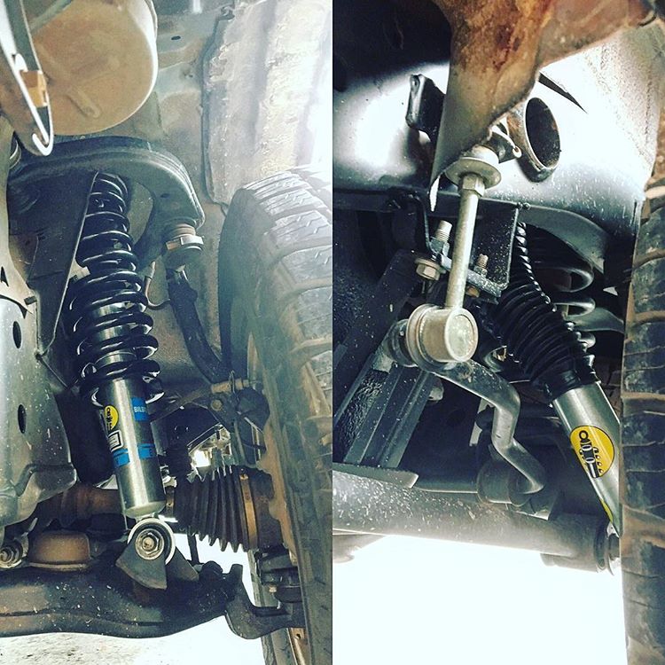

Lift is finally installed! It is a huge difference and a new feeling truck.
What was replaced: stock front 99 talls that had 221,000 miles. Rear was OME 60028 "comfort" shocks with 906 springs. I installed these a few years ago before pulling a trailer from Phx to Seattle and back. This set up was great for towing or with weight in the back, but everyday use it was really stiff.
The New: after reading this post and researching I decided Bilsteins were the way to go for my needs and budget. I mostly do back roads/forest roads and use it as a daily/camp vehicle. So I contacted Chas at MRT and he sent me the parts list. I went with the 5100s that are valued for the 4Runner which are probably more forgiving than the Tundra ones most people choose. Went with OME 880s up front and kept the OME 906 in the rear but added a 10mm trim packer to help keep the spring in place.
Reaction: it rides way smoother. This is the ride I've been longing for. Glides over bumps, soaks up dips, and handles great. I can't wait to get this thing on some dirt. Yesterday when just the rears were on I hit a quick rocky road and compared to before I barley felt a thing.
Very happy with the upgrade and highly recommend MRT.

Nice, I'm installing the same combo this weekend. Any pics of the truck from the side?
What perch did you set the fronts on?

I went with the lowest perch. Pared with the 880s you get 1.5 inches lift. No side pictures and my fiancé just took it out of town for the weekend. I only got to drive it one day with the new suspension lol!
When she gets back on Monday I'll post a side pic and measurements. All I know is at 6'3" it feels great to be able to stand under the rear tailgate when it's one without ducking down!
