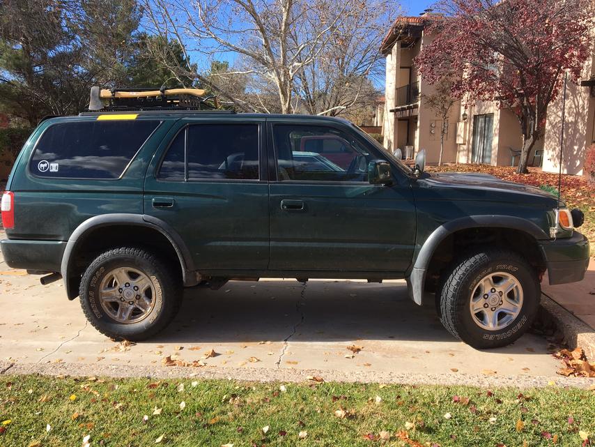

I went with the lowest perch. Pared with the 880s you get 1.5 inches lift. No side pictures and my fiancé just took it out of town for the weekend. I only got to drive it one day with the new suspension lol!
When she gets back on Monday I'll post a side pic and measurements. All I know is at 6'3" it feels great to be able to stand under the rear tailgate when it's one without ducking down!

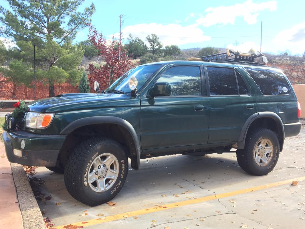

Lift: Front are Bilstein 5100s set to Perch 0 (lowest perch) with OME 880s. New top hat hardware.
Rear is Bilstein 5100 with OME 906s with a 10mm OME spacer.
My truck measurements from the center hub to the bottom of the fender.
Driver Front: 22in Passanger Front: 21.75in
Driver Rear: 22.25in Passanger Rear: 22in
*My OME 906s have been installed since 2013 so they have settled in that time.
**These are the 4Runner Specific 5100s talked about in this thread ordered from MRT Motorsports. I highly suggest ordering from them. Chas knows exactly what he's doing to match what YOU are looking for out of your 4Runner.
