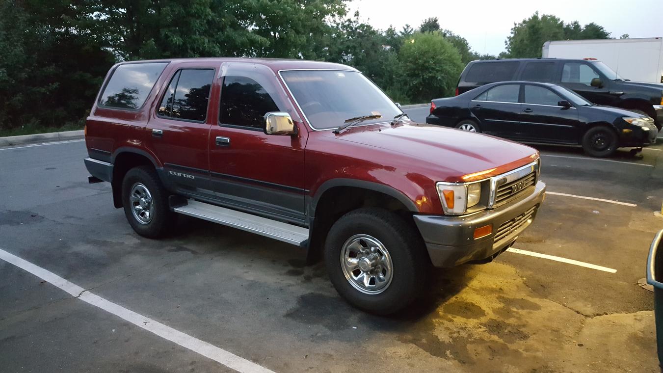

1990 Toyota hilux surf here. I'm interested in the tall skinny look. Got any suggestions?

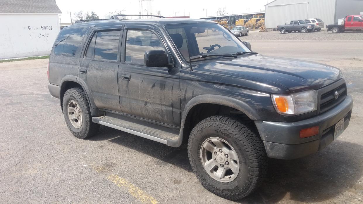

I have decided I like the logic of the skinnier taller tire I decided to go with LT235/85 Falken Wildpeak AT3W All Terrain they are the same height as the 265/75r16 the maximum height without a lift. The bonus they weightvabout the same as the stock size so i don't take a big hit on the gas millage front. They looked great. After mounting them I headed to Denver for 4 days of snow boarding. We drove into a blizzard and they felt great. We did a little off roading to. I feel overall having more weight per square inch at the contact patch provides better traction for a wider variety of conditions. For me that fits the 80/20 rule.:gun6:

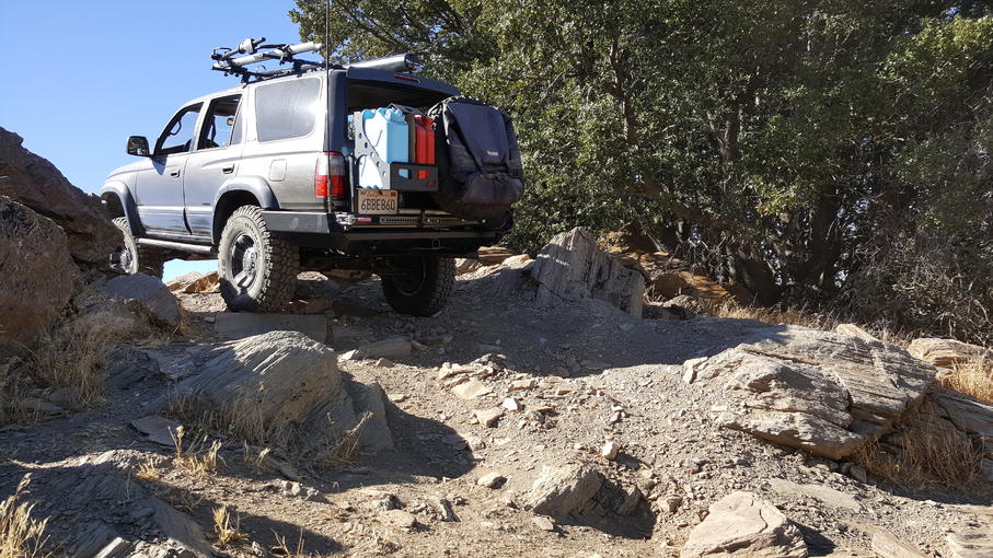

Tall and skinny rock. Some new rims with offset would be nice for not hitting the frame on extreme turns. Got any suggestions for offset rims that are reasonably priced? Gonna take a pass on wheel spacers.
