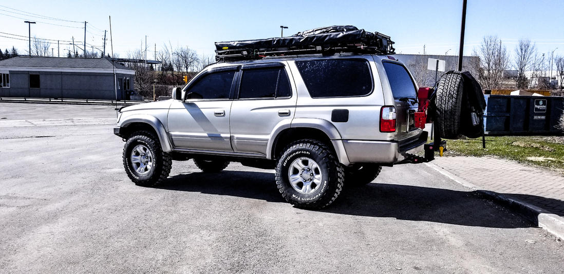

have tried a couple of different tire sizes. currently running 255/85/16 km2s for this season and love them so far. I go offroading at least once a week and having a lighter and taller tire as opposed to 285s is certainly a plus.
