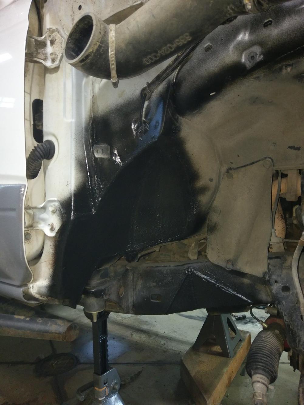

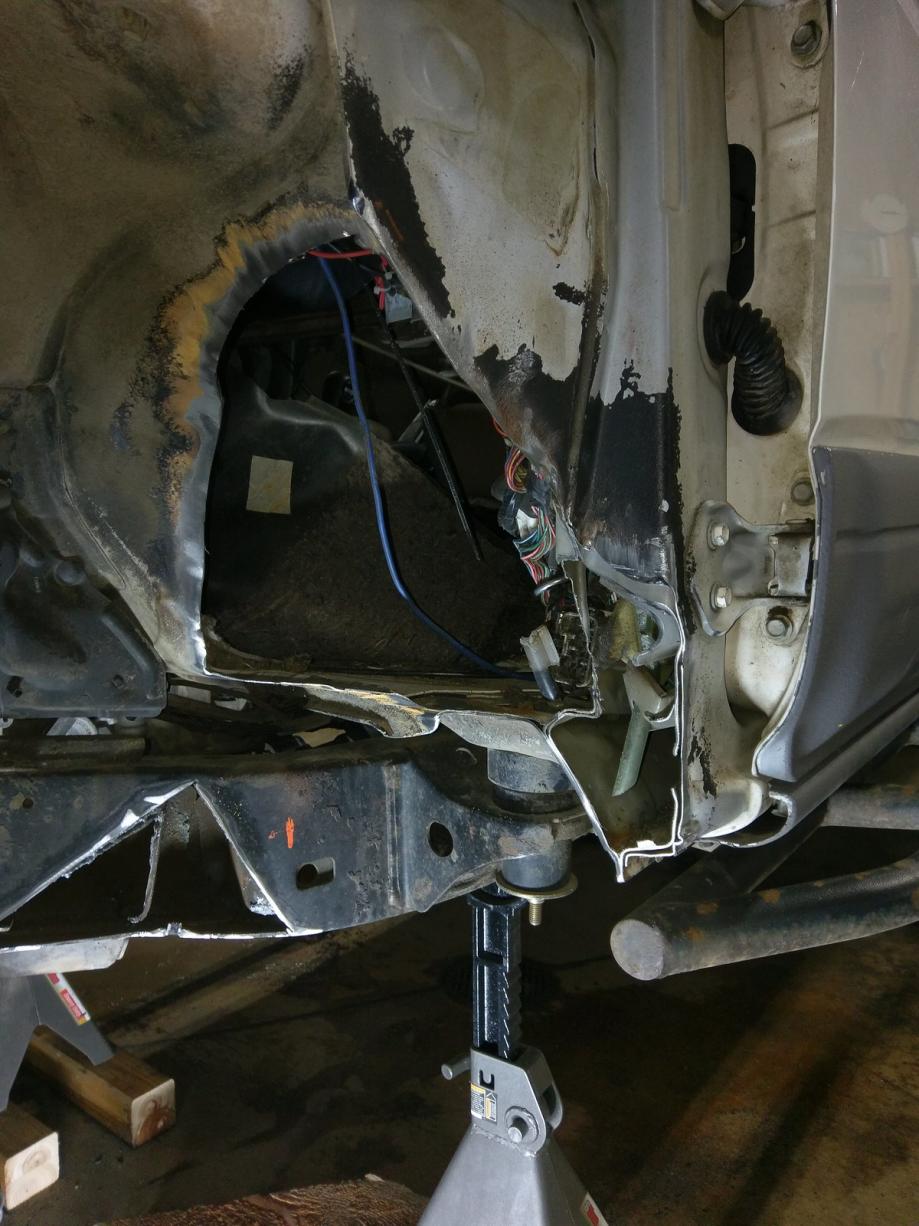

If you're looking to clear 35s with a 1 inch body lift this is what it takes.... I have roughly 1/2" of clearance everywhere after this
And just keep going until you cut the majority of your body mount out to do 37s. Easy peasy. I need to notch my frame real bad... although on the upside it will never rust in that spot, always freshly polished
