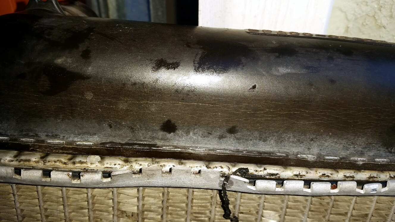

Only immediate thing I noticed, the plastic tank on top was starting to spiderweb really bad and had long micro cracks running horizontally. Same area my co-workers radiator split on his tacoma (250K+ miles) Also the material had turned from black to army green. Doubt the tank would have lasted much longer.

The only failure point that was possible on this rad that was obvious was the top tank. It had a ton of microfractures in the outside plastic that were visible in some spots on the inside as well. Same place my buddies original taco tank ruptured - along one of these cracks that opened up.

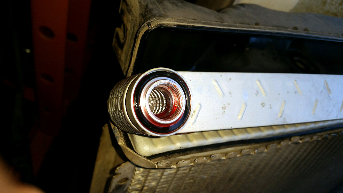

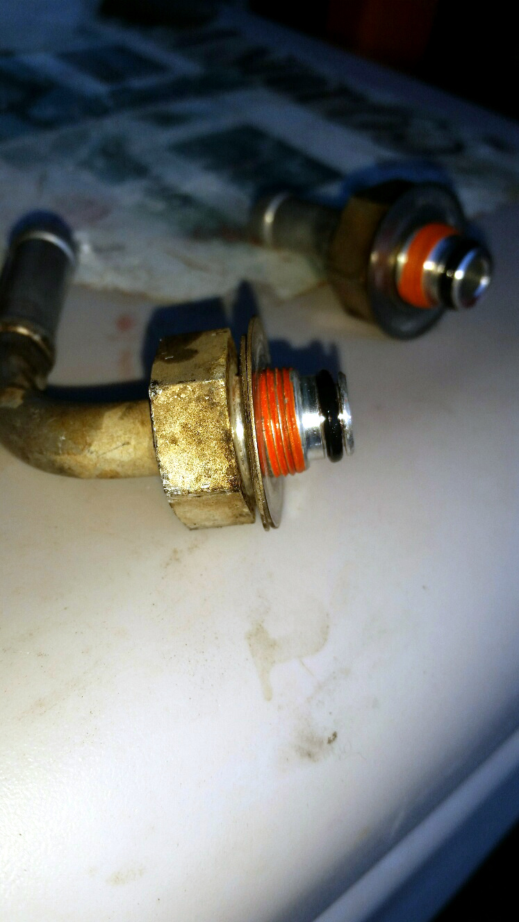

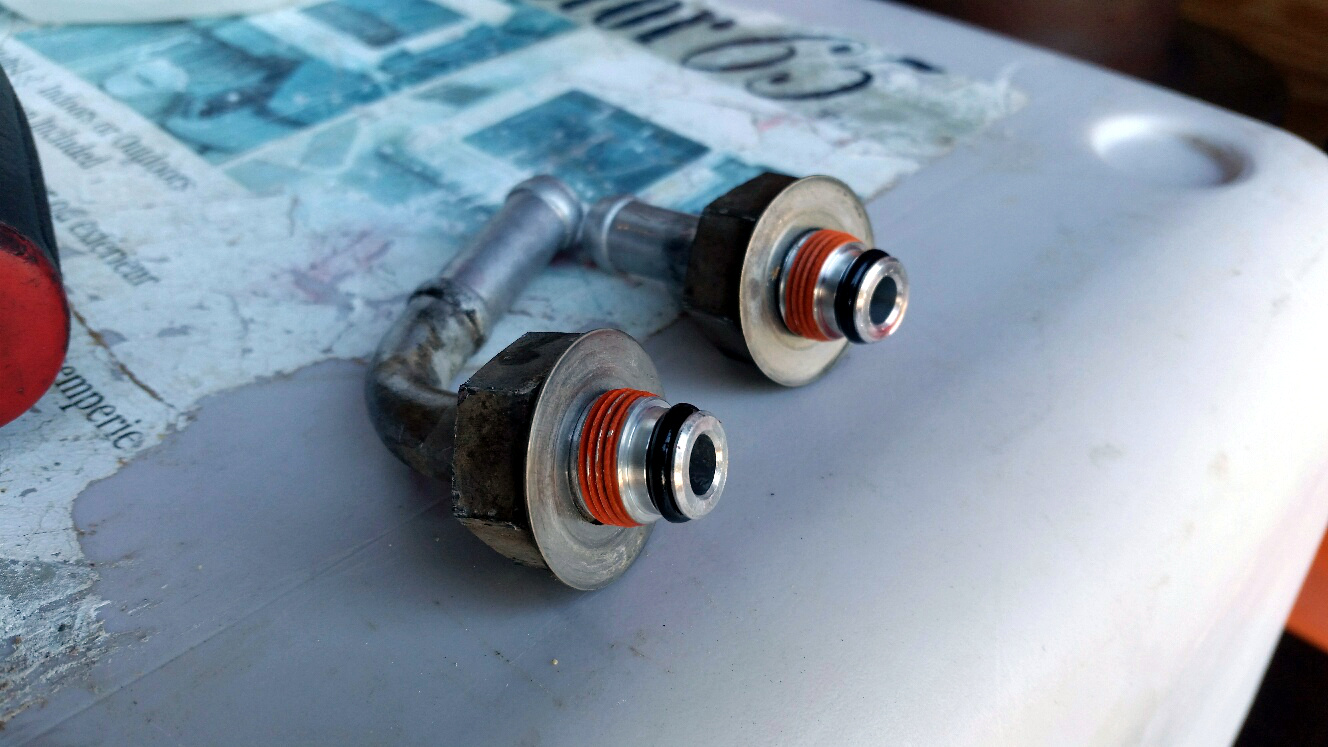

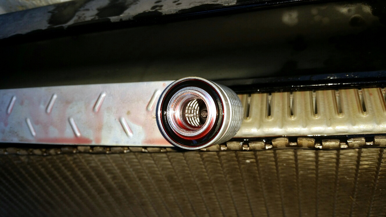

Photo of the tranny cooler hose barb ends. Looked brand new inside and metal was perfect other than grime from age.
Took a photo of the barb with the flash on to show behind the washer. Nothing going on there either.

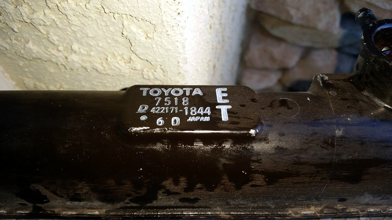

Showing this was an original radiator / Japan Denso core.
More of the plastic stress on the top tank from thermal expansion / cool-down over the years.

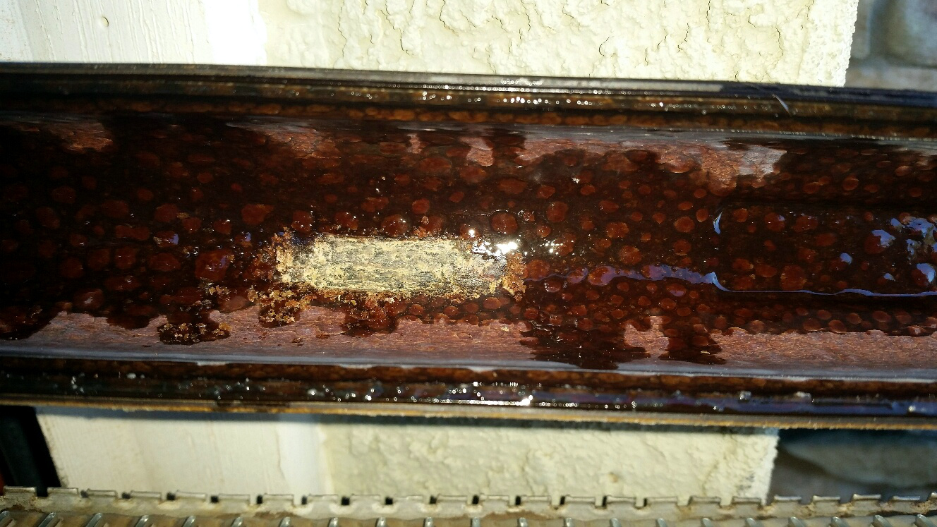

Some of the buildup in the top tank that happens due to the airgap. Normal. Scraped some of it away to view the plastic stress on the inside of the tank. Hard to tell in the photos, but it was evident.

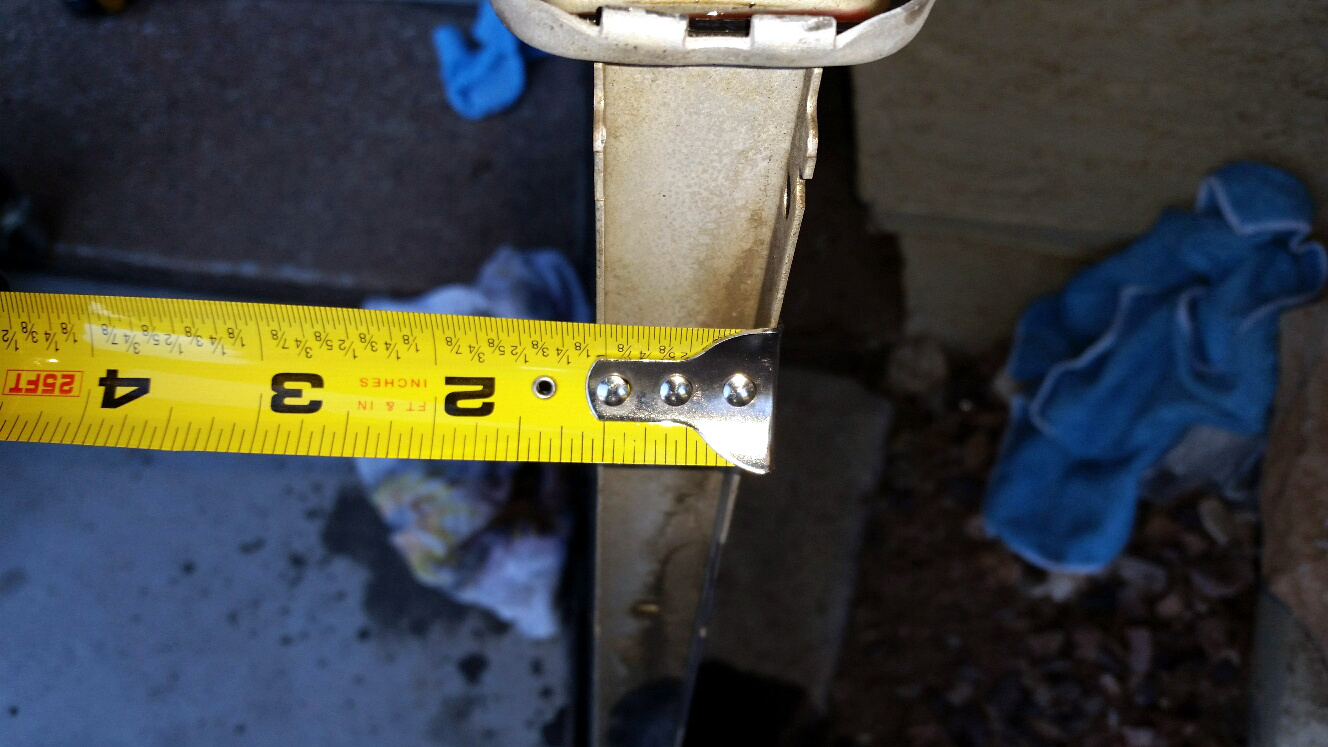

Stock core is 1" to note.
