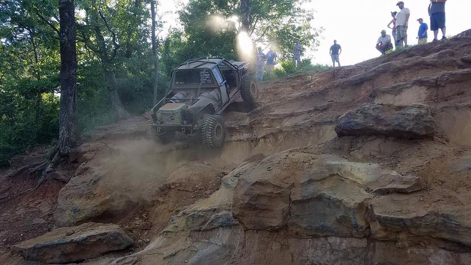

Attached picture of my buddy going up Dwoody. I did it to, but he screwed up with my phone and I got no video or pictures ;-( Talk about a trail that has gotten harder.... Shit is scary now. We even got another friend of ours up in an FJ80 on 37s. I'm still shocked he made it.
