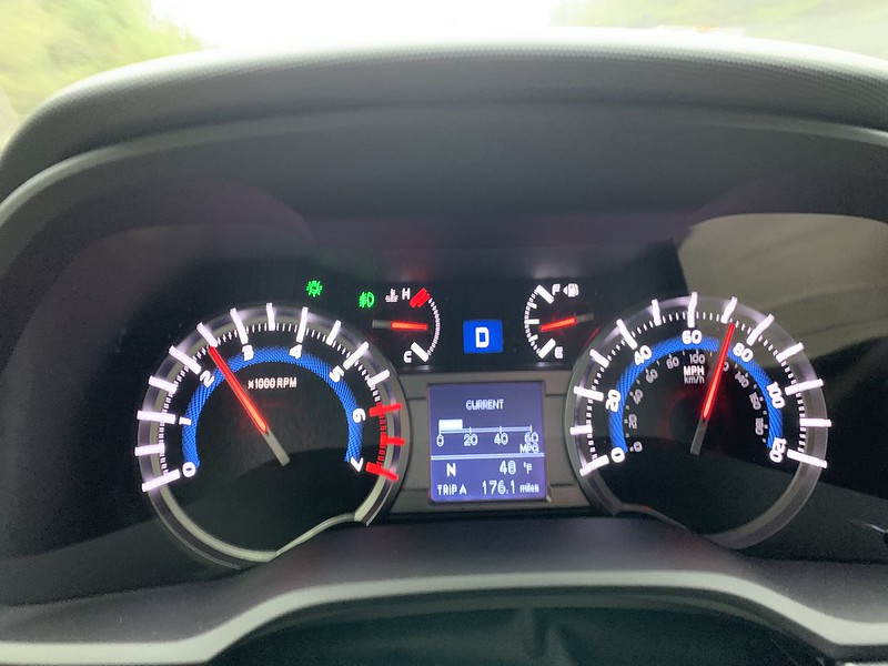

I'm running 4.56 gears from ECGS on 285/70 Nitto RG's. I took a trip from Atlanta, GA to Cincinnati, OH, and back. I averaged maybe 13.5 mpg running 70-80 mph.
The best part is the power it has going through the TN and KY mountains. It's a hit on MPG but worth every penny to gain the power back and then some.
The only regret is not going with a front locker when I did this upgrade. I'm a firm believer in having and not needing rather than needing and not having.
Here is a quick shot from the road trip to give you an idea of the mph vs rpm. I'd say this is about 70 mph at 2500 rpm.
