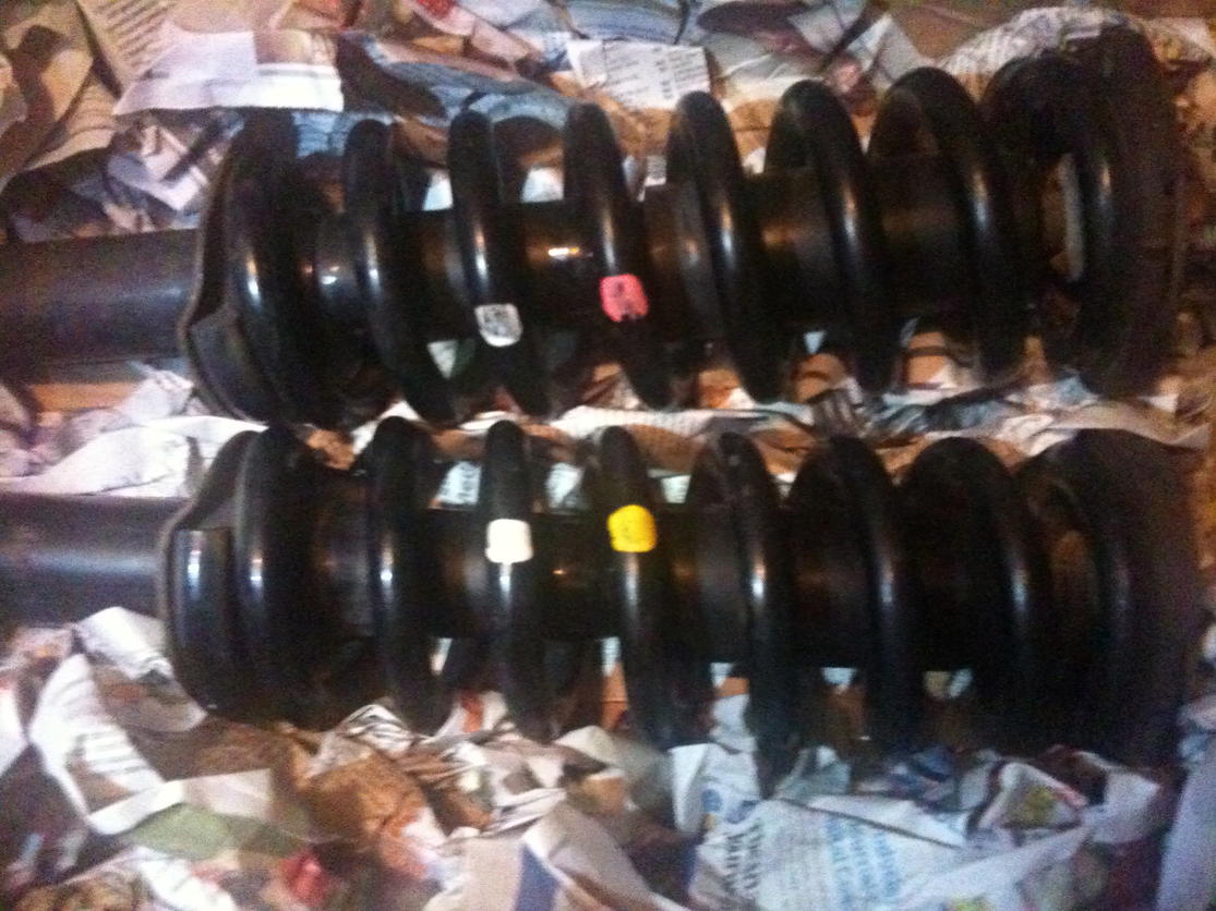

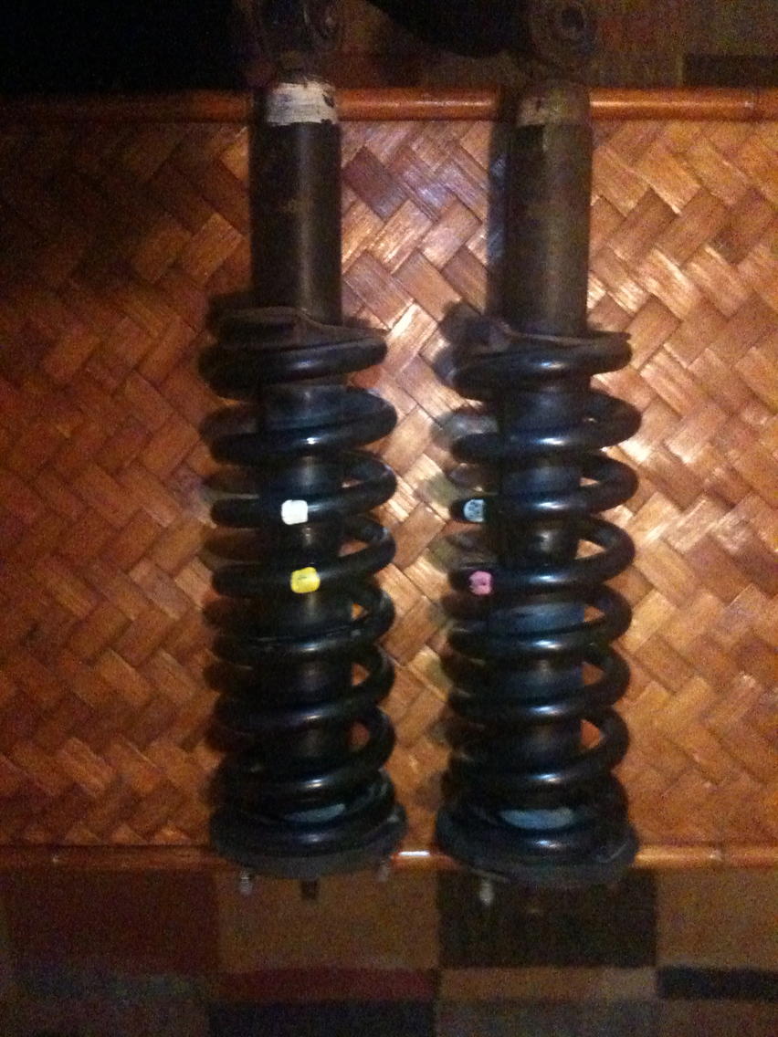

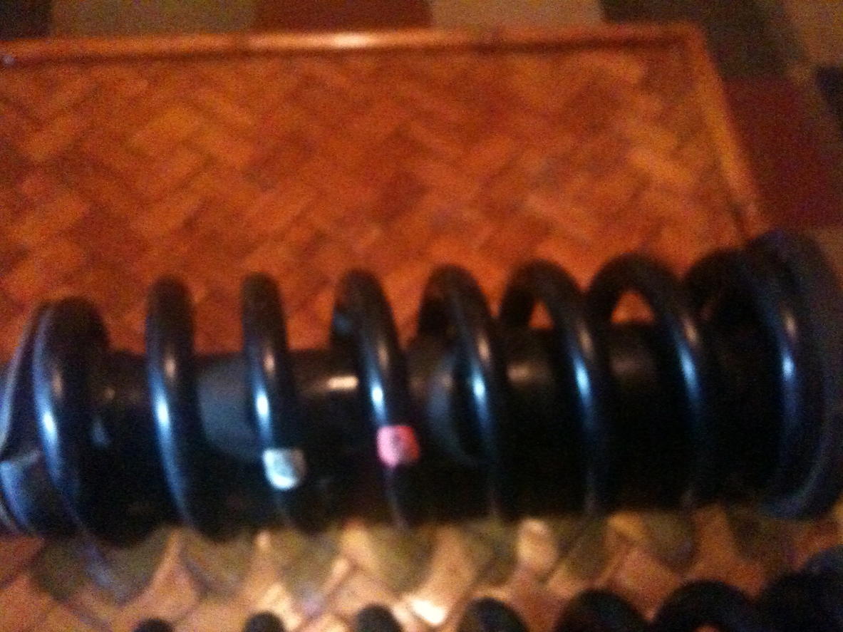

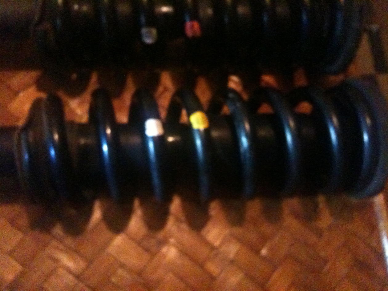

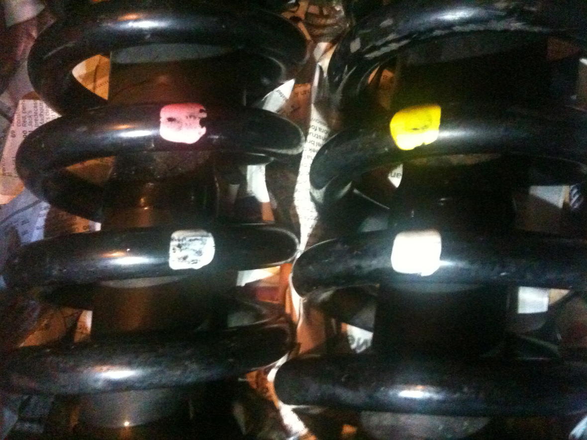

Here are the 99 tail spring color codes from the Lift Info sticky thread which you should read.
Front Passenger Side Springs - Blue / Yellow (48131-35400)
Front Driver Side Springs - Blue / Pink (48131 - 35350)
http://www.toyota-4runner.org/3rd-gen-t4rs/66976-3rd-gen-4runner-lift-information-faqs.html
Steez,
Thanks I've read that thread many times, what I still don't know is are these springs from a "short" 99. The springs I have now are the correct color codes you've mentioned, but these new ones appear to be white/yellow and white/pink. Was that the color codes for a 4Runner with the 15 inch wheels usually indicating a 4Runner with short coils?? In some lights the white could be blue but when i compare to my current springs mine a very blue/yellow etc...has anyone upgraded their suspension from short coils that can compare with my pictures and tell me for sure?
