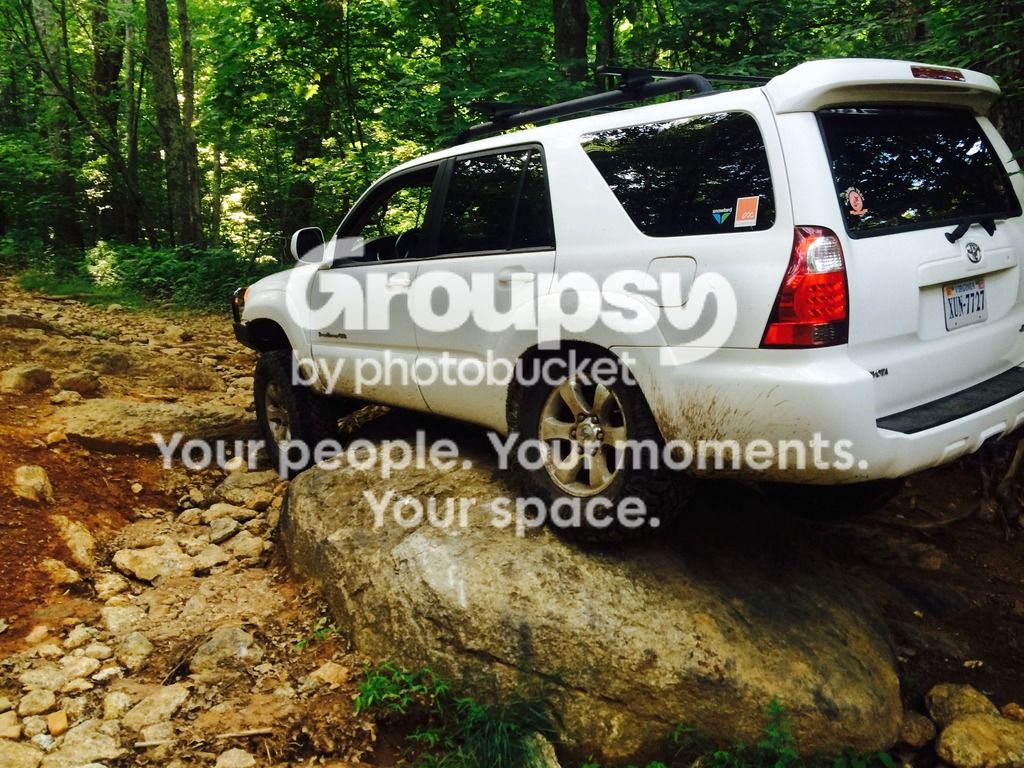

So I bought her in Feb 2010 in VA and got a job assignment in SLC, UT later that year. I thought there might be some good wheeling out there ;) So I installed a Daystar lift, 32" Nittos and loaded the truck up and drove across the country. I quickly discovered Moab was only a few hours away and went wheeling as much as I could...and quickly found out how capable 4Runners are.

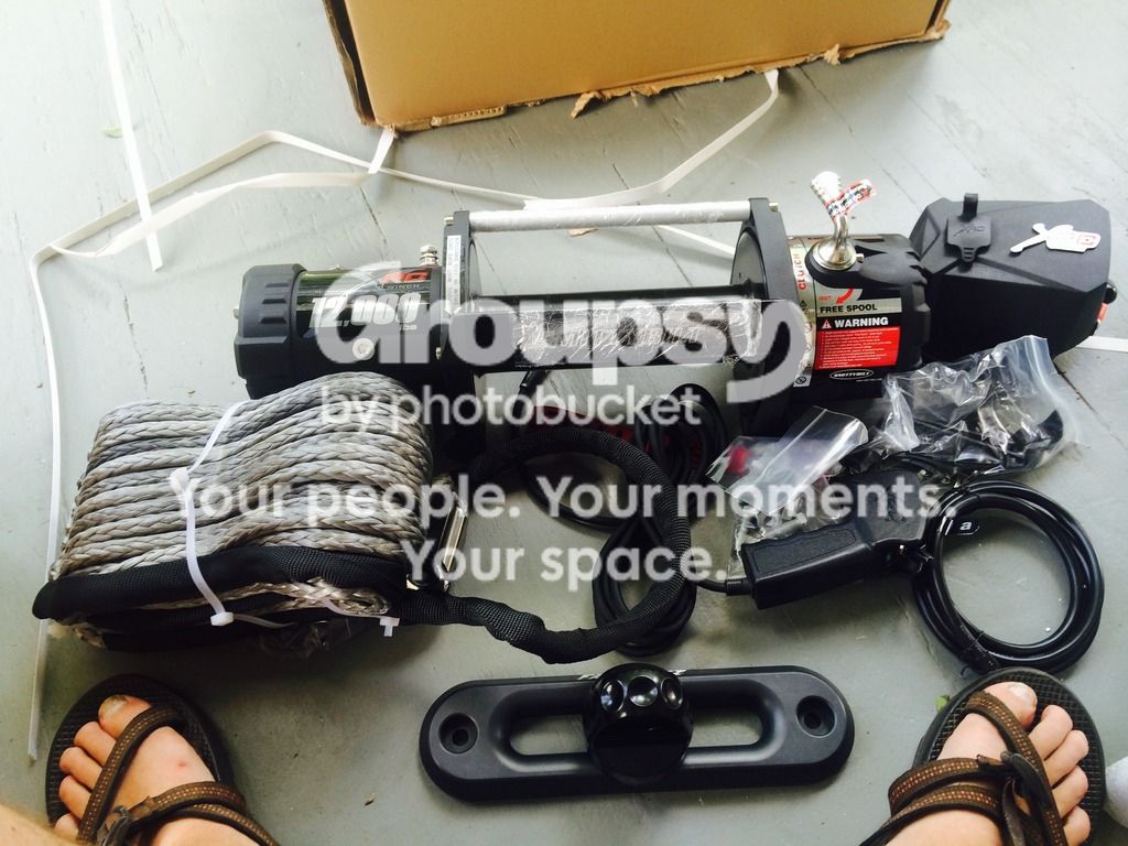

Then came the LED light bar and winch...

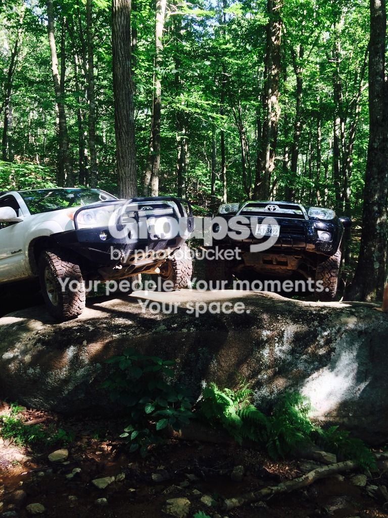

And some wheeling at Shoe Creek in central VA on the 4th of July weekend to test out to test out both of our new suspensions and tires...

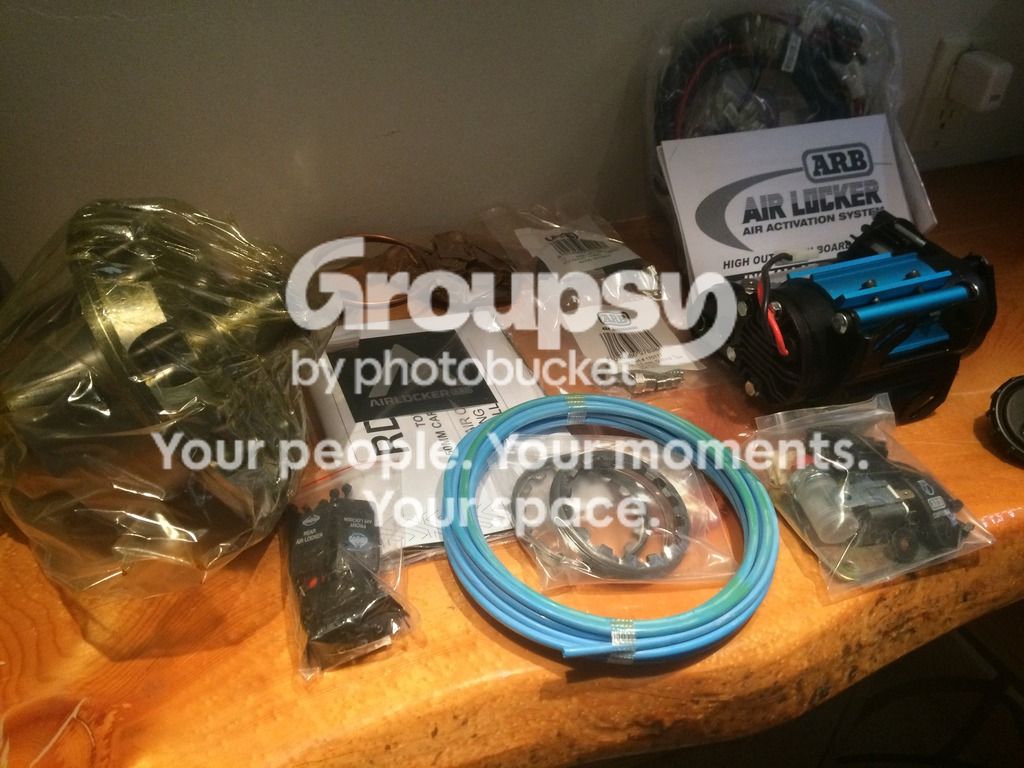

Got some goodies in the mail...
IMG_4082_zps2n0qrmoo.jpg~original

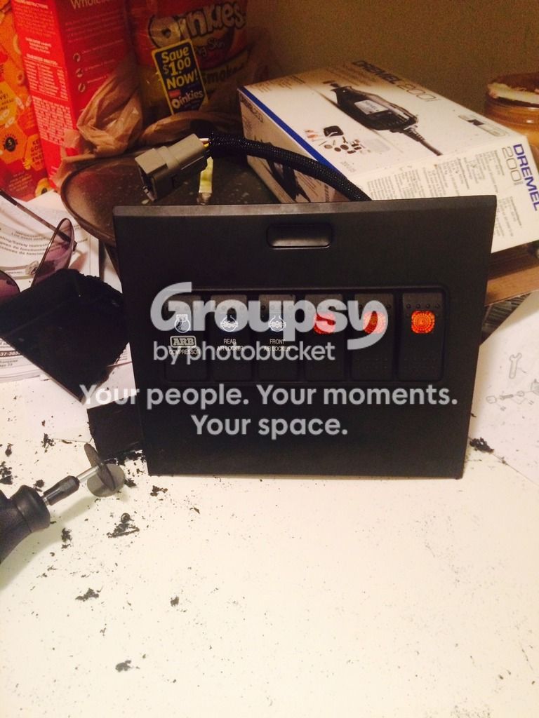

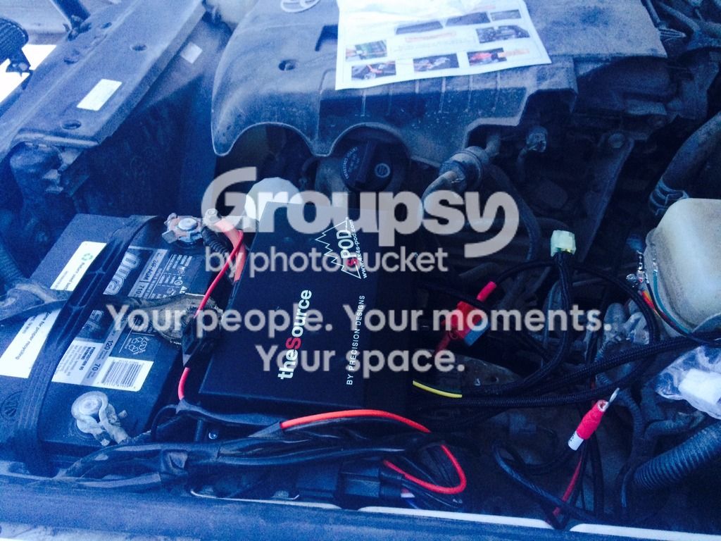

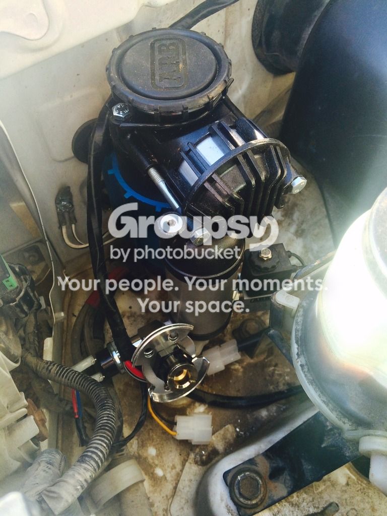

I decided to install the ARB compressor and the S-Pod fuse box at the same time. It was all very straight forward and the S-pod gives me the flexibility to easily add accessories in the future very quickly. I didnt have a good setup here to try and install the locker myself, so I dropped it off at Safari Ltd in Grand Junction and they installed it for me and did a nice job.
IMG_4347_zps1ytahh4q.jpg~original
IMG_4348_zps5qmjtswr.jpg~original
The S-pod comes with a switch panel that I fit into the trash compartment above the cup holders with a dremel tool. It's convenient and safe from anyone, including my rambunctious dog, from accidentally engaging a switch.

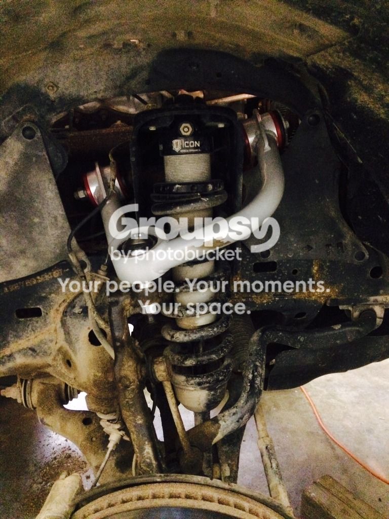

All-Pro UCA's

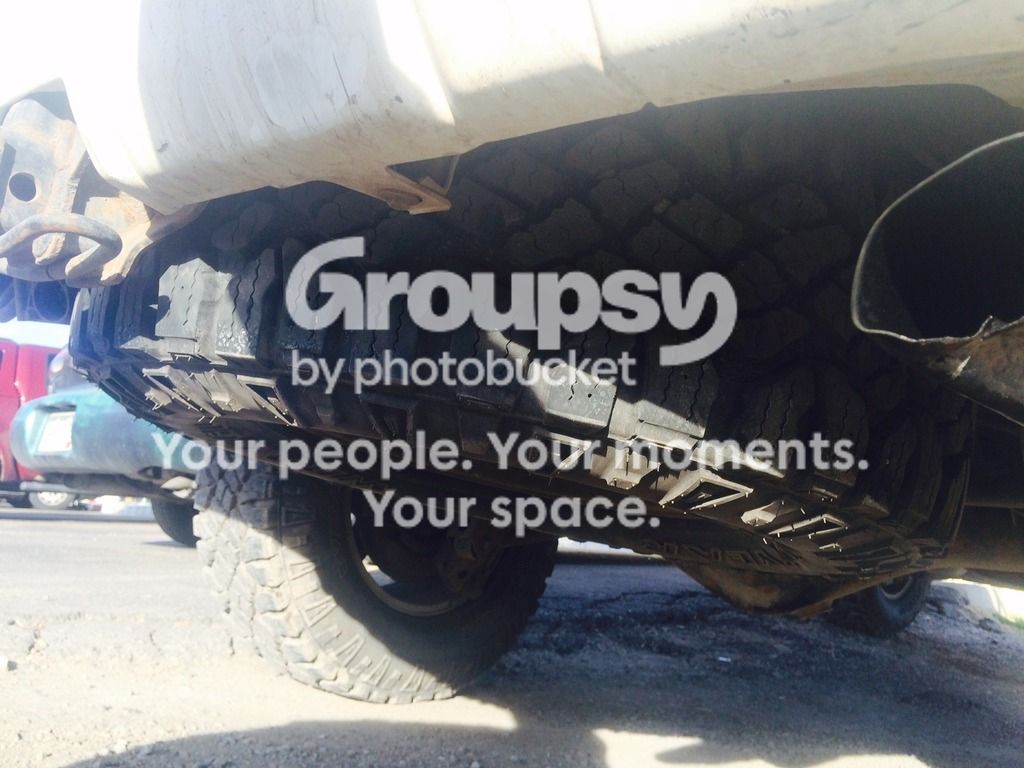

Fit a full size 285/70 spare underneath the truck. It had about 70% tread and I had to deflate it slightly and still only have about 1/8" clearance to the panhard. Oh well. When its flexed, there is actually a bit more clearance. Glad to have the peace of mind of a full size spare.

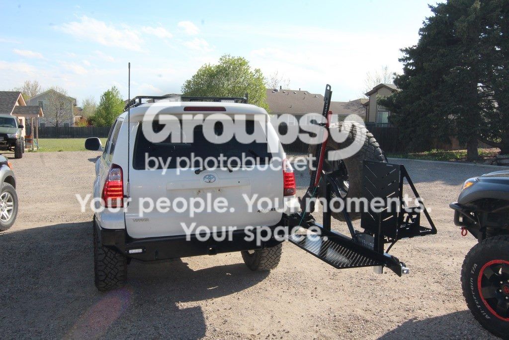

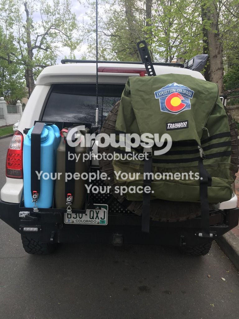

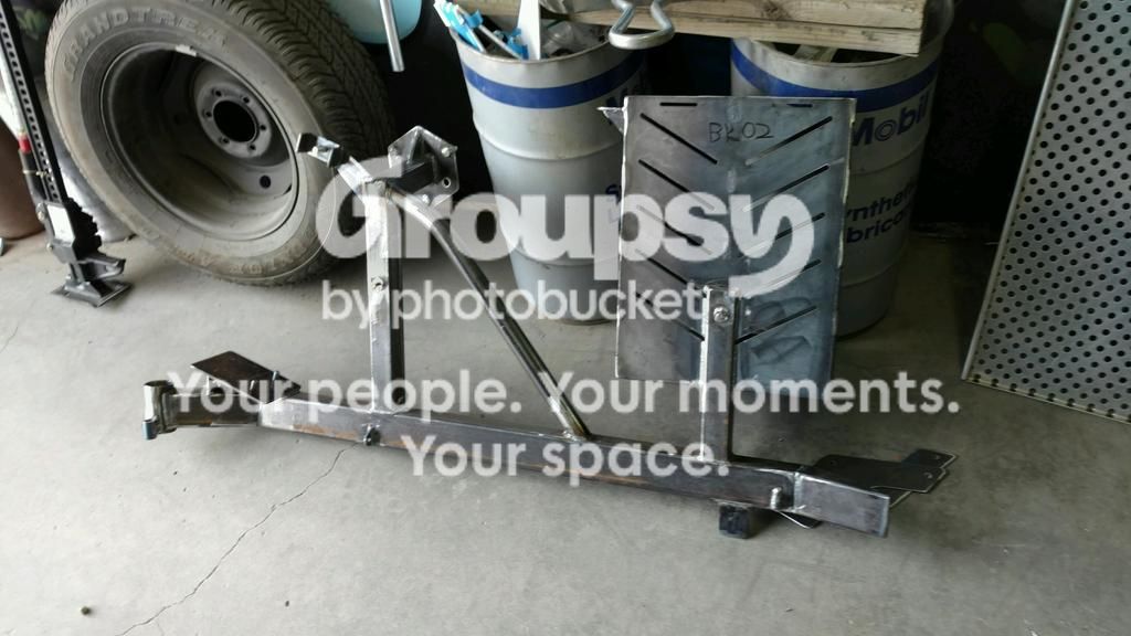

Lots of new updates from this spring! First and foremost, I worked with Insain Fab on a high clearance rear bumper with swingout, camp table, etc. I didn't like any of the options out there for 4th gens and thought a custom bumper was the only way to get what I want. It turned out fantastic. Insain did a stellar job and I've put it to use a few times already.
IMG_0445_zpsp43pbepc.jpg~original
IMG_0450_zpsawrqpfis.jpg~original
IMG_0455_zpssxhqlpyi.jpg~original
Finished product!

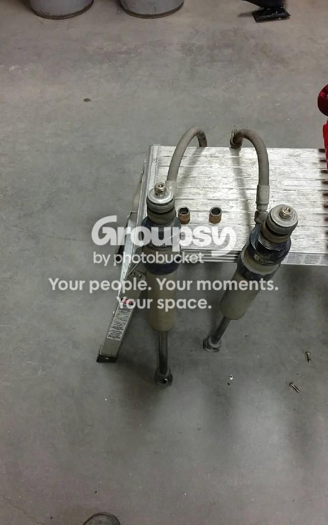

After the rear bumper, it was time for an overhaul on the rear suspension. My Icon 2.0 shocks blew out after 30k miles and my Icon coils were sagging under the weight of the steel bumper. I picked up a set of slightly used Icon 2.5 remote resi's and Toytec Superflex HD coils. This setup is just about perfect for those carrying 200-300 lbs of extra weight in the rear. :thumb:
