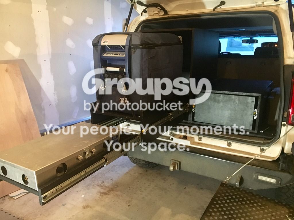

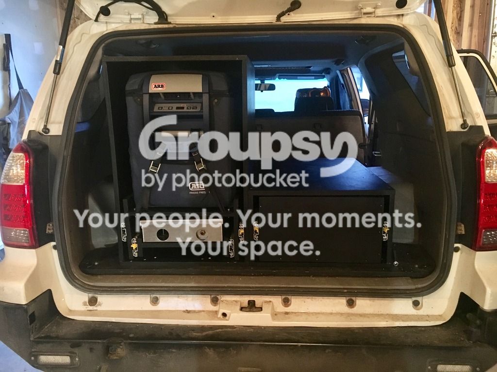

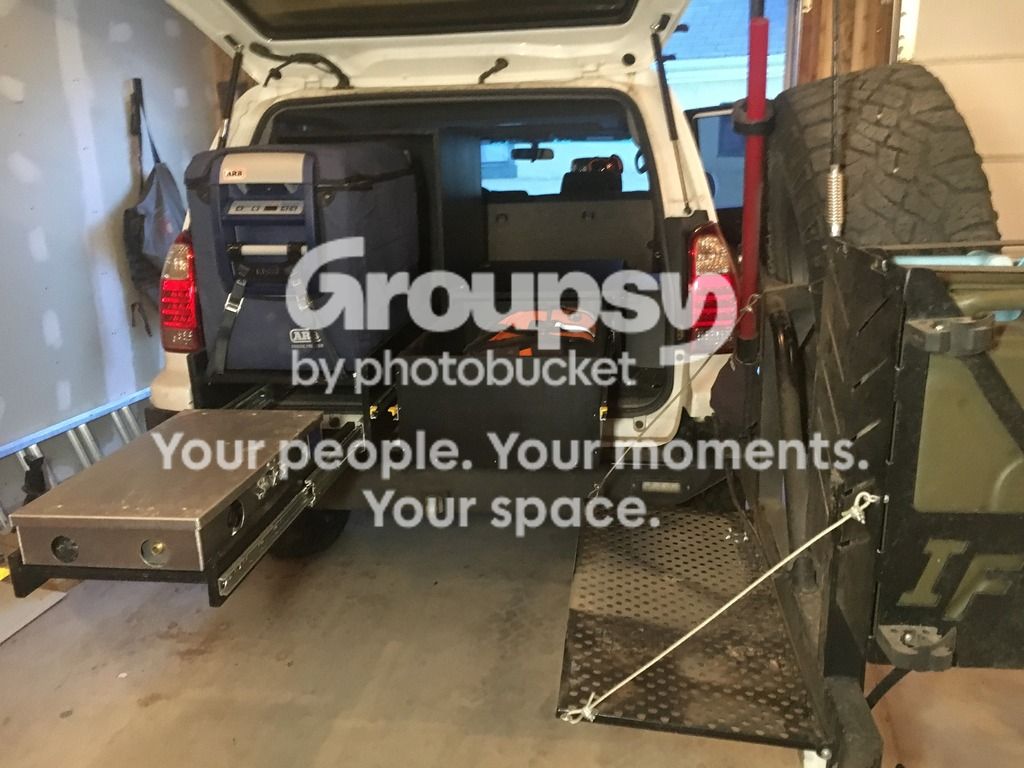

Slide out Kitchen/drawer Setup
Just finished up building this setup. I have about 20 hours into the project and around $600 in materials. I used 3/4" birch plywood painted with bedliner and Accuride heavy duty lock-in/lock-out slides. Prepping for some long trips this summer to Alaska, Moab, etc and this should make things fast and convenient!

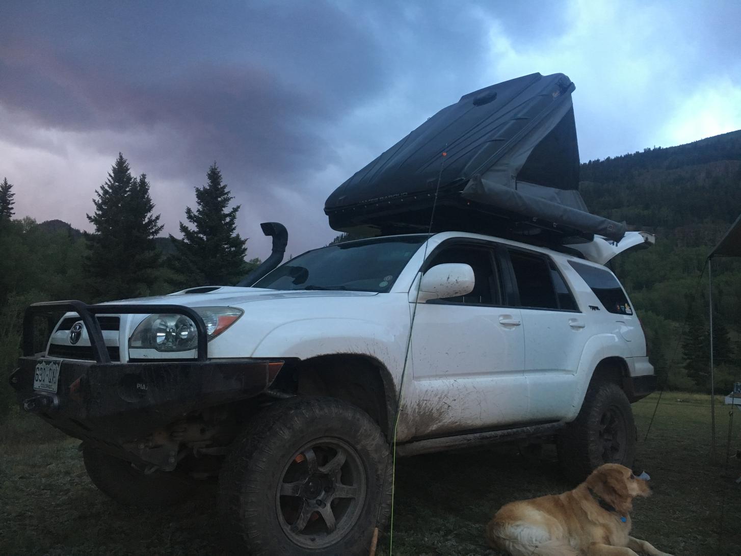

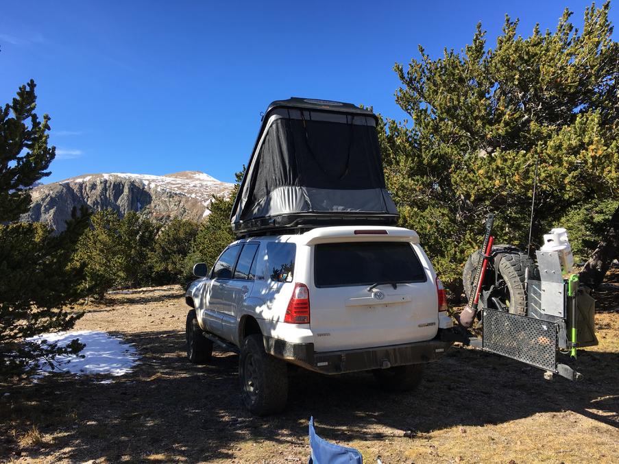

James Baroud Tent
I'd been wanting a hardshell tent for awhile and after seeing quite a few different types in person and online, I knew I wanted the Baroud because of the superior quality, 5 year warranty and some really nice features that others don't have such as a built in fan/vent. My buddy Josh at Bomber Products hooked me up with one of the last Discovery models in the US.

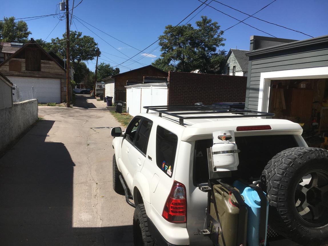

I decided that I wanted to do something a little different with mounting it. My Whitson rack was nice and strong, but weighed about 100 lbs. So me and my buddy [MENTION=61439]grateful[/MENTION]runner at Minimalist Fabworks came up with a strong, low profile and extremely lightweight flat rack design perfect for mounting RTT's. Just took some 1" tube and bent it and welded in some crossbars and some feet and it works beautifully. About $150 in metal. I've already had the tent out for 10 nights in the last 5 weeks including 5 nights in the dollhouse section of the Maze and I am extremely happy with the whole setup. So fast, easy and comfortable.
