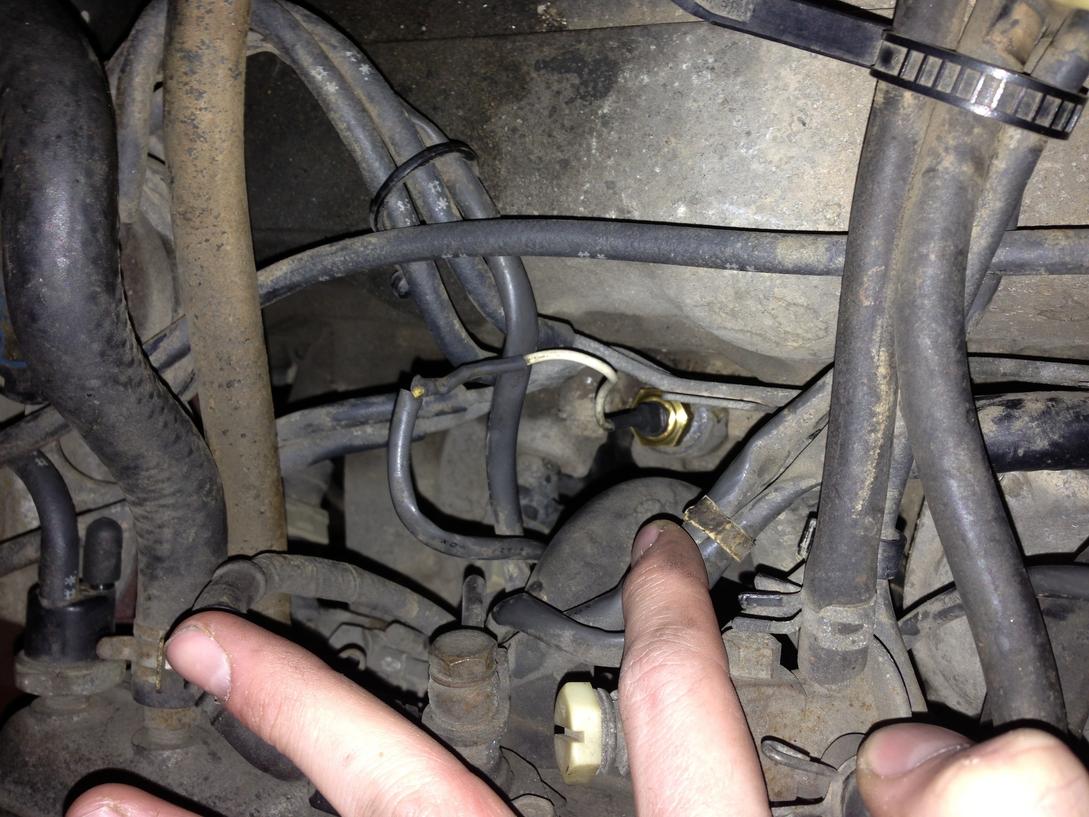

This is the sensor. From what I've read this is the one for the gauge?

If you turned the truck off and unplugged the sensor and the gauge needle was still halfway up the scale, I don't think the trouble is with your sensor. It's probably going to be the gauge itself. I'd score a new cluster and replace the whole schmear, myself.
If I turn the key off the gauge drops back down. If I turn the key on, the gauge goes up to normal operating temp. If I unplugged the sensor with the key on the gauge stays at normal operating temp and doesn't move. And about swapping the cluster. Does anyone know what year they made the cable speedos untill. I don't wanna go pull one from somewhere or someone( off craigslist) and it not even work. Thanks guys!
