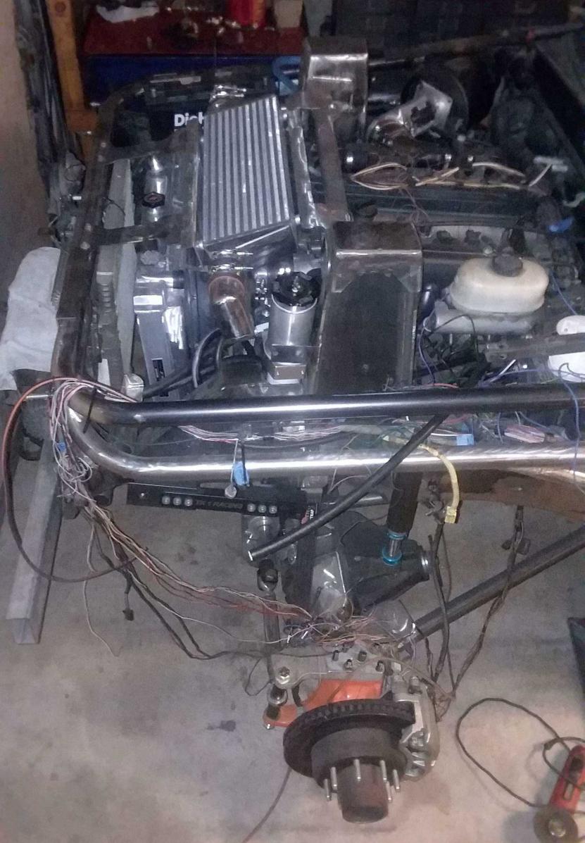

I’d like to see how well that 2jz fits in the engine bay, I’d even consider swapping in a 2jzge depending on how hard it is to fit in there

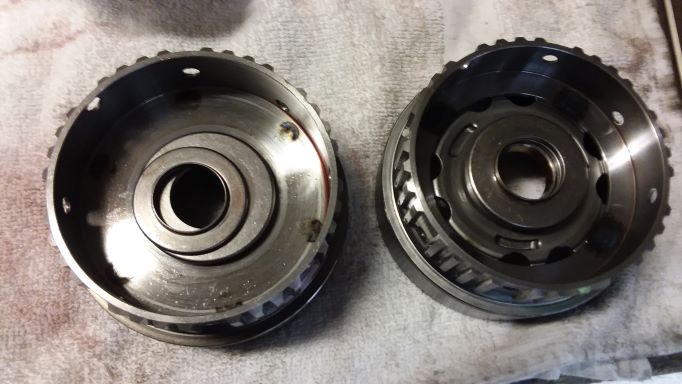

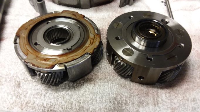

left what in the 3rd gen 4runner trans VS right 3f310
Can't help u there as to get the SAS, 2jz, increased space for coolers/rad, winch, larger tires etc. lengthened the engine bay and overall length of the 4runner

as far as what makes the trans better, if u look at the pics i posted earlier u can c that the parts aren't made from stamped metal parts, the center support has 5 gears vs 4 gear, have other pics that show there is more meat left of the main case, more and better friction discs, taller front pump 22ish% more flow.
